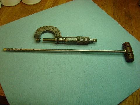

Okay, I finished the cleaning rod. All of the dimensions are very close to the original plans except the slot in the lower end of the rod. It calls for 2mm (0.079"), but the only slot cutter that I have is 0.100". For a difference of 0.021", I decided to live with it and not buy a special cutter. I am attaching a few photos.

I like it, that is good work, did you built handle from scratch

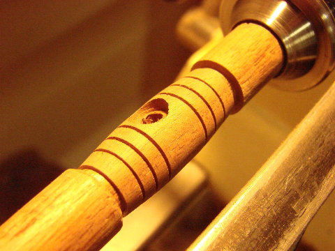

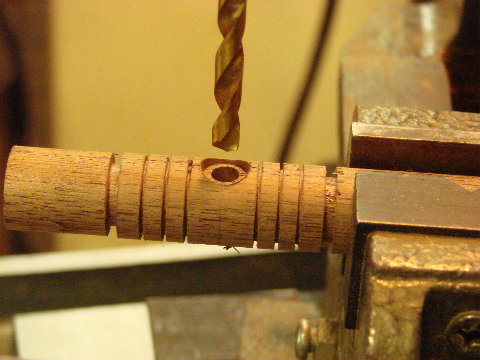

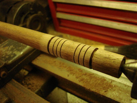

Joe--the handle was built from scratch--see photos
John--I really enjoyed building it, but if you were to build a bunch of them, then it becomes a job and I'm retired. So, I'm not taking orders.
