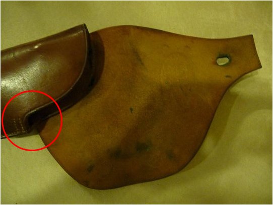

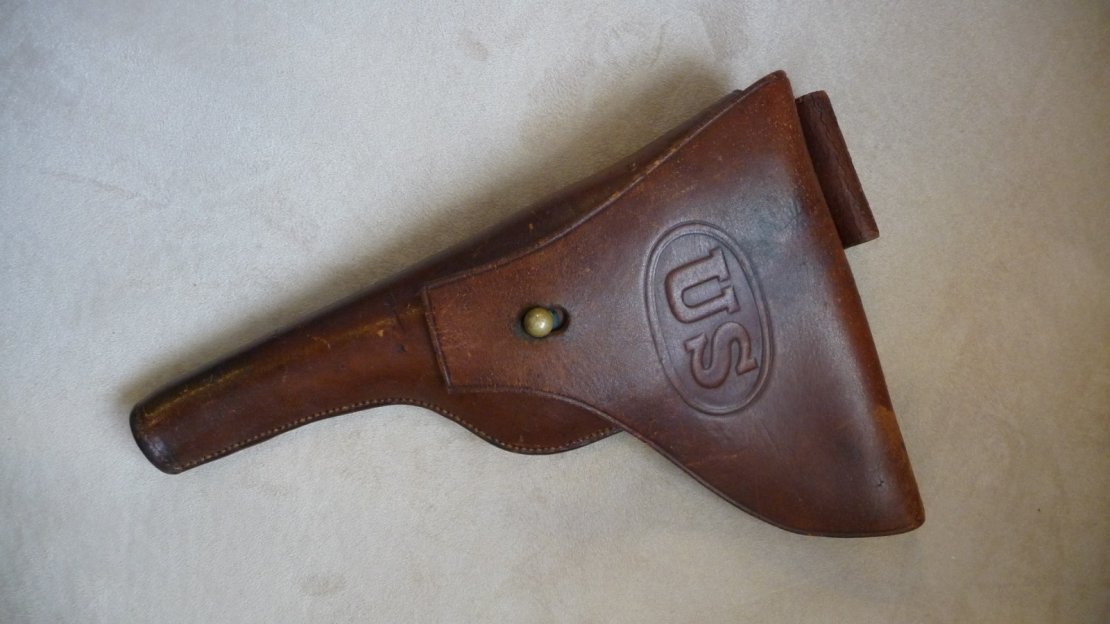

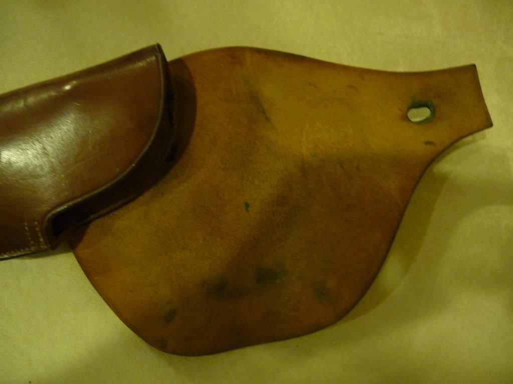

Here are photos of a US Test Holster I am considering purchasing.
Comparing with comparative photos of correct holsters on the board, the threading looks right, and the RIA EHS looks possibly ok.
The hole for the closure stud concerns me as it is elongated vs perfectly round in the comparative photos.
Any comments are appreciated.

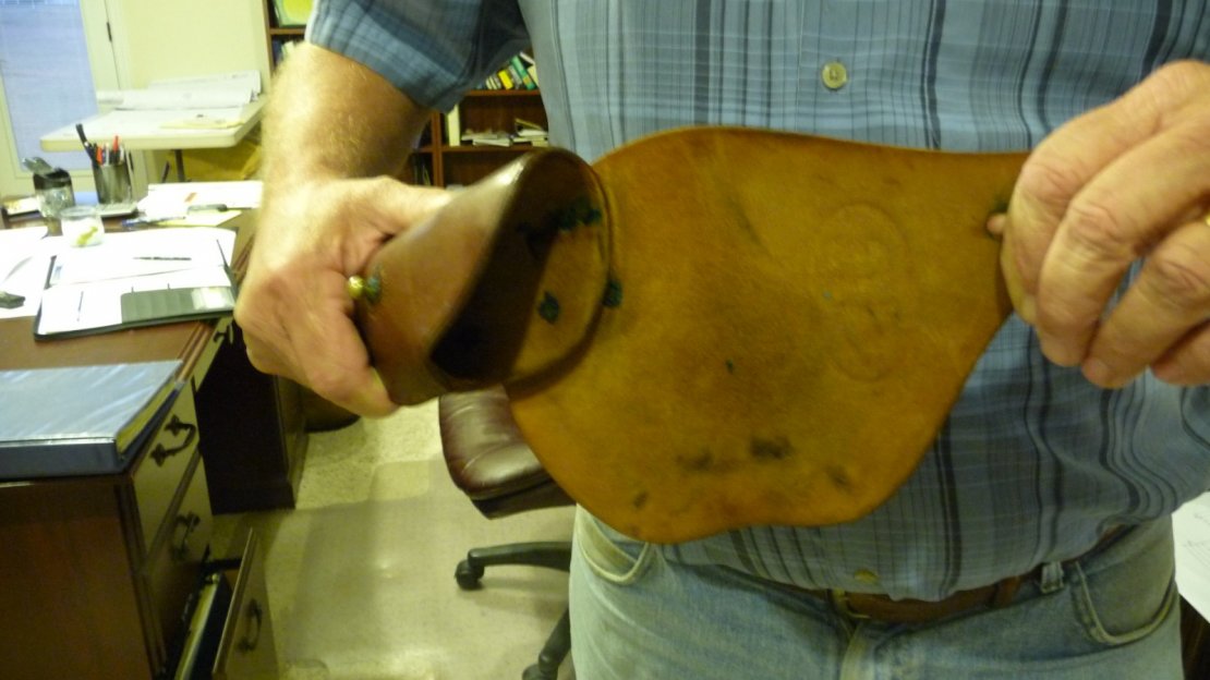

Looks pretty good. Any chance of a couple of photos with the lid open, particularly in the area where the trigger guard goes. Also are there any marks/initials on the tab of the front flap just below the closure stud hole?

Thanks, Postino. I believe they were made to be worn butt-forward. I have an old, likely early, reproduction I purchased from Simpson Ltd. a few months ago that I used for comparison as well. It is completely unmarked (except "US").

No marks/initials on front bottom of flap that I can see as I have seen on some of the others. Will see if I can get a couple photos of the holster, open.

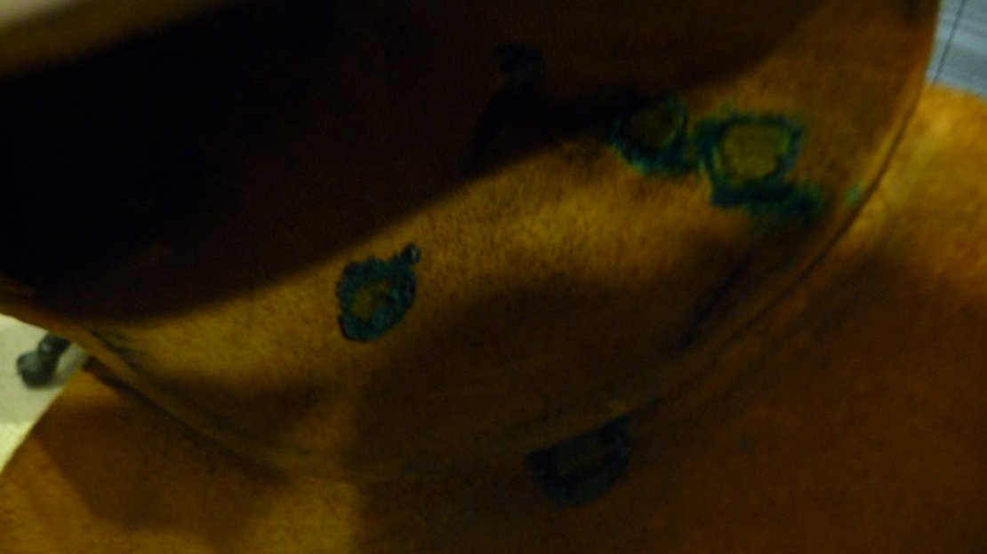

Photos of the inside of holster:

This is the area I am interested in, front side, back side and inside (inside not as important).

Based on the images that you have posted, this holster appears to be genuine and the stitching appears to be correct from the early period. I like the small amount of 'flaking' on the holster which shows age. Usually, the repro holsters were made of a different leather feeling rather 'hard'.

Clark, It looks good to me also. That amount of vertigris on the brass rivets take some time to develope. TH
Unread 11-10-2010, 03:13 PM   #9
Mine looks much the same, especially the wear patterns, As I'm still in the hospital recovering from my fall and resultant surgeries I'm unable to post mine to demonstrarte the simularities. In any event this holster is 100% genuine based upon your pictures. To own one is a rare treat!!I I wonder if Ron has any idea how many have survived! PS Hi Albert!!!

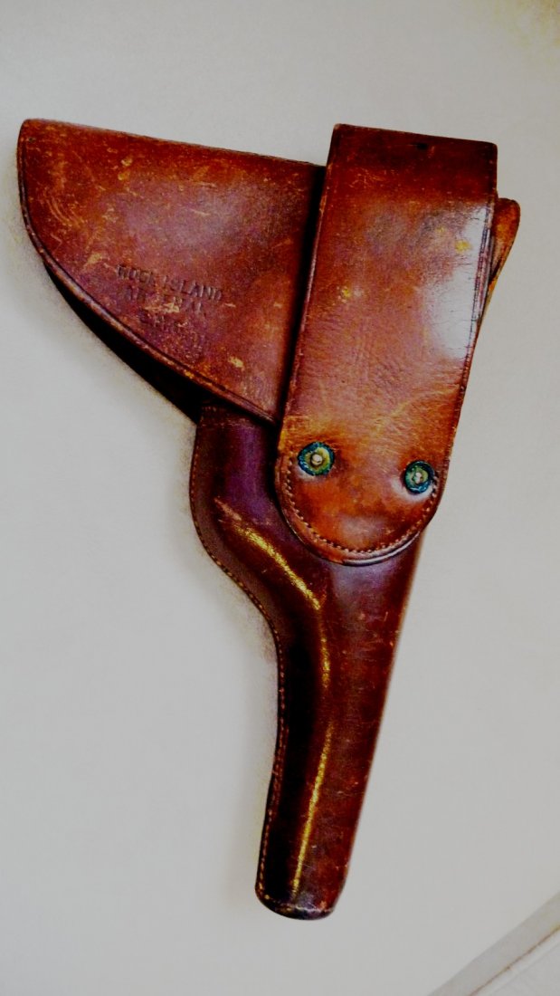

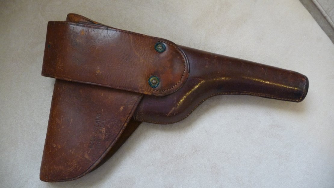

Default A perfect set!

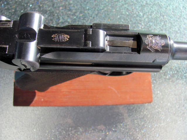

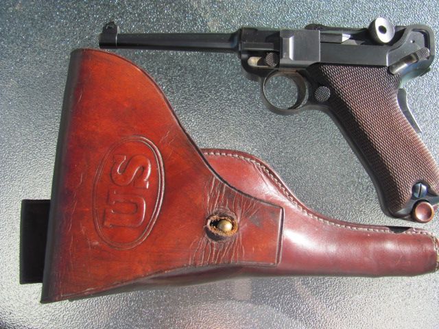

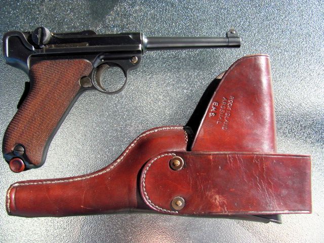

I bought with the holster from Gramps
Unread 12-16-2010, 02:27 PM   #12
VERY Nice Clark!

Eric,
If you wish to learn how to differentiate between an original US Test Trials holster and a repro, look closely at the stitching which is tighter (per inch) and the thread is thinner on an genuine holster.

Albert I knew you would hop in. About 5 years ago Ron took examined all aspects including inside wear patterns and its legit> It doesn't need to worn out like the one You own to be legit! I really missed you! PS.I MISSED YOUR PASSION!
