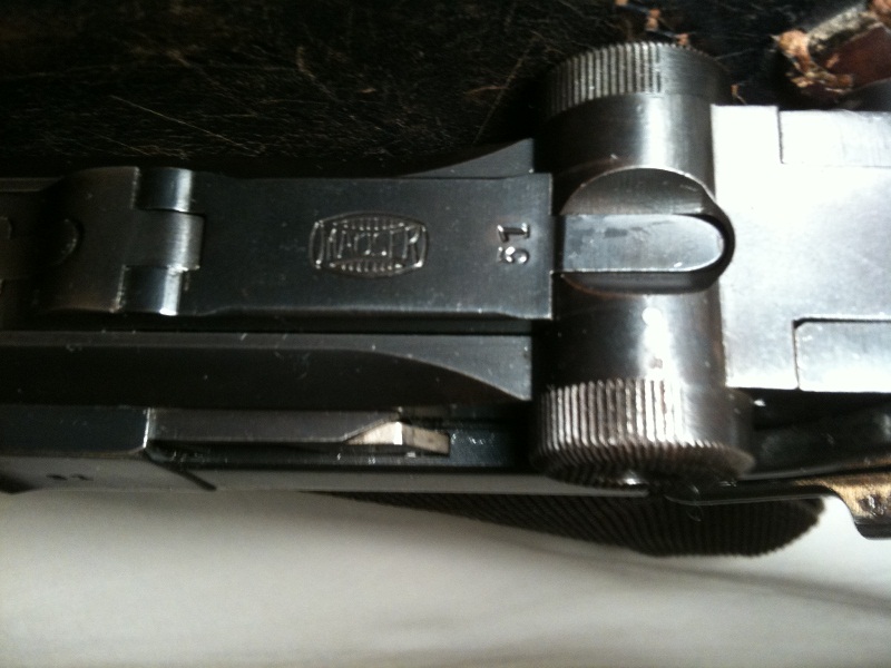

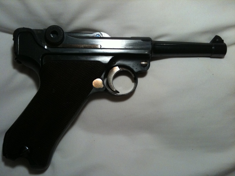

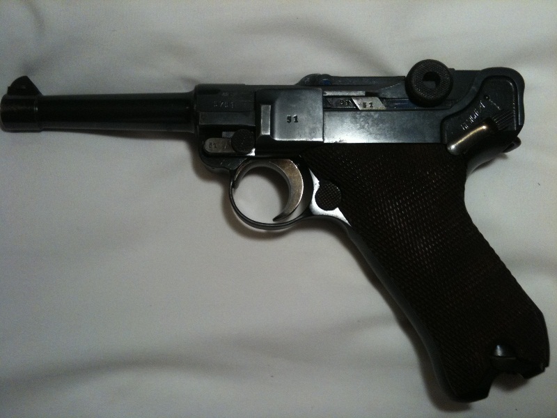

Can anyone point me in the right direction? I would like to find out more about this gun.
It was manufactured by Mauser and has 1939 stamped on the barrel. It chambers a 30 Luger.
Below are some pictures.

Welcome to the forum. Question. Would a 1939 Mauser have straw parts? Or does the Banner mean that it is a commercial model?
The following member says Thank You to pitsword for your post:
Unread 11-04-2010, 11:56 AM   #4
A 1939 Luger would not have strawed parts. Strawing was discontinued in early '37. My guess is that it was rebarreled and refinished at some point.
Is there a serial number on the bottom of the barrel?

Thank you pitsword
The trigger, magazine release, safety, and the take down lever are almost gold or brass in color. I am guessing those are "straw parts".

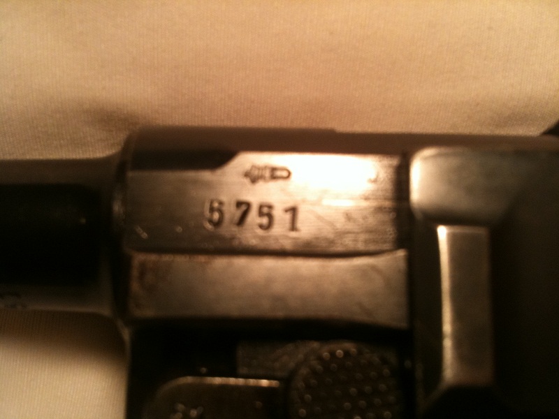

The serial number on the bottom of the barrel is 5751. The top of the barrel says 1939.

Being a commercial banner, it is possible for this to have come from mauser with the strawed parts. The holster looks to ba commercial also.
Steve
Unread 11-05-2010, 08:26 AM   #11
According to Jan Still's Third Reich Lugers, Banner Commercials were made in 7.65, and with strawed parts. This could very well be a correct Banner Commercial.
I should have checked before I spoke. Is there a letter suffix under the serial number on the front of the frame?

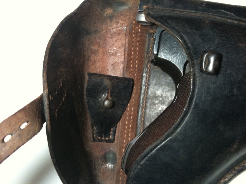

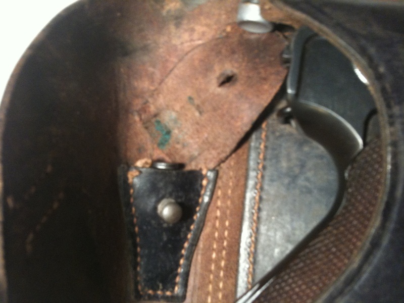

Default Another thing
I just noticed some markings on the back of the holster... see the picture below. It is stamped with "KOLN-DEUTZ 1936" There are some other markings, but I can't make them out.

Didn't see any markings from the first set of pics, obviously now not a commercial.
Unread 11-06-2010, 06:02 AM   #17
Thanks: 2,079
Stve, you mean the holster as it is military, the luger started as a commericial that went into army service.
