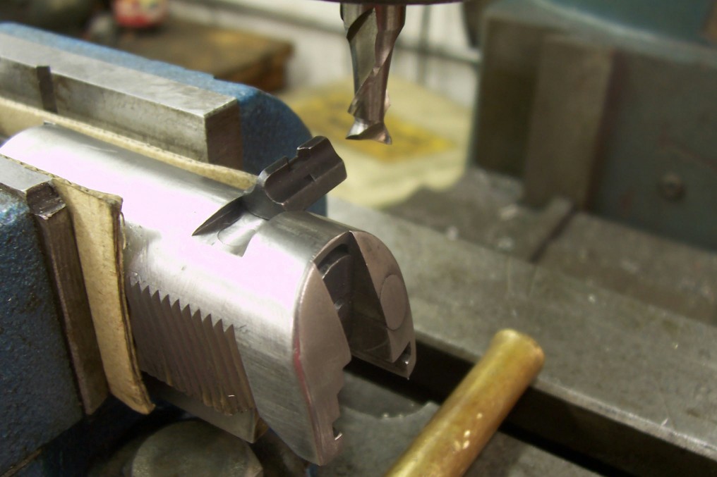

and Here is a photo:
-John

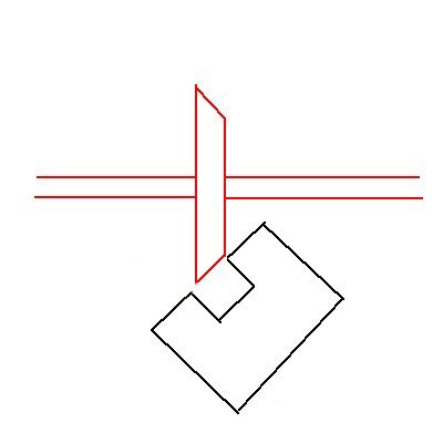

FWIW, back in '69 when I worked for Twin Industries Inc (an aerospace subcontractor) dovetails were cut by a pieplate-shaped cutter on a horizontal mill...the workpiece was clamped at the desired angle, and one side of the dovetail cut...then the piece was rotated and the opposite side cut...
Something like this...I don't know if that is how the Luger was done, but it is a quicker and safer method than a teeny tiny dovetail cutter...

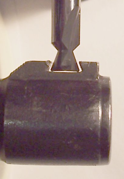

The Harvey Tool dovetail cutter came today...Looks like a good fit...
I don't have a barrel ready to fit a sight to at this time...but I will postmark this thread for further revision...

It does look like a good fit. Thanks for the photos and your "progress reports". Hope your dovetail cutter works great and you don't hear that dreadful "ping".

The horizontal milling machine with the cutter you described certainly looks like a fine solution and doesn't look as fragile as that tiny dovetail cutter...
FWIW, back in'69 when I worked for Twin Industries Inc (an aerospace subcontractor) dovetails were cut by a pieplate-shaped cutter on a horizontal mill...the workpiece was clamped at the desired angle, and one side of the dovetail cut...then the piece was rotated and the opposite side cut...

Yes, it certainly is fragile looking...3/16" shank...3/16" across the base...Major pucker factor...
I'm more familiar with 3 and 4 flute dovetail cutters; I'll have to read up on speeds for the 2 flutes...

I'll try the Harvey Tool dovetail cutter on a piece of scrap and see how it works out...
I thought you already tried it? I bought one just like it, and it worked great. I just made a straight cut with an end mill, and then I took about 2-3 thousands at a time with the dovetail cutter. It went straight through without any drama at all.

I thought you already tried it? I bought one just like it...
You bought a Luger dovetail cutter??? Do you remember where you bought it???
Unread 02-04-2014, 07:50 PM   #20
Olle
Olle's Avatar
Join Date: Feb 2010
Location: Tennessee
Posts: 1,149
Thanks: 159
I got the same one as you have, from Harvey Tool. Seems to work just fine.
