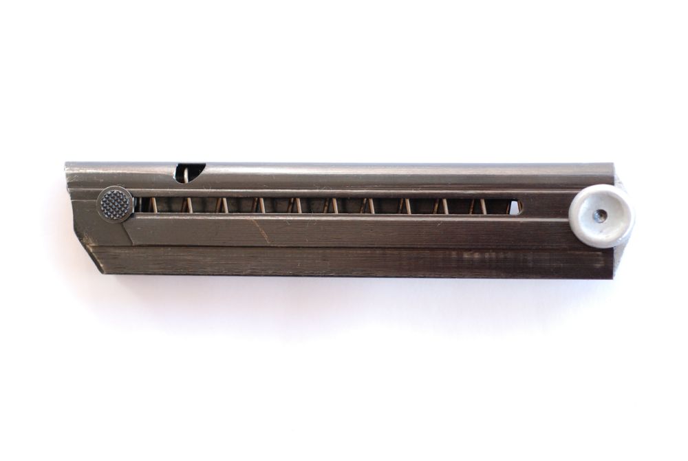

Unread 10-22-2010, 11:08 PM   #16
Shouldn't this one have the extruded mag. body and the pinned bottom?

dju, this magazine is correct for an early 1940. The E/655 magazines were used along with 122 magazines from the no suffix block through the D-Block. They were pretty much phased out by the F-Block.

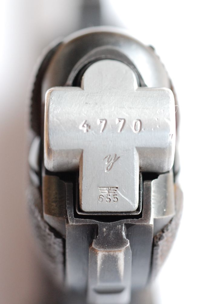

I keep looking at the " one" on the frame SN and it just worries me along with the perfect finish.
I actually see a messed with "3" , there should be no doubt on a perfect gun.
Pretty gun though, just needs to be looked at very carefully buy any buyer ( always good advice)

Unread 10-23-2010, 02:55 PM   #19
Frank:
Are you saying that the bottom is correct (unpinned) or that the wrap-around body is correct? I'm no magazine guy so I'm trying to learn here. Seems to me that this one should have the extruded mag. body that hangs down a bit in front.
Thanks;
Unread 10-23-2010, 03:46 PM   #20

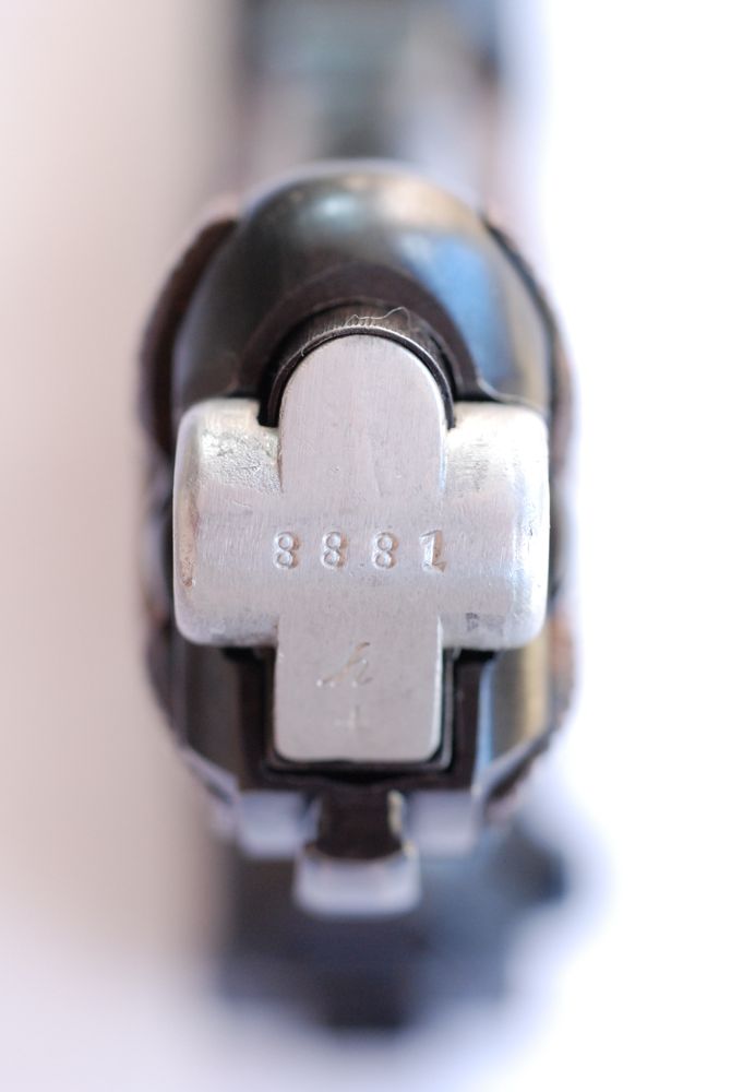

Hi David, The crimped, blued steel mag (Type II Army) was phased out between the n.s. and d blocks, and replaced by the extruded steel mag with the squared off bottom (Type III Army). Here are photos of a y suffix 1939 42 with Type II mags and an h suffix 1940 42 with a Type III. Regards, Norm
