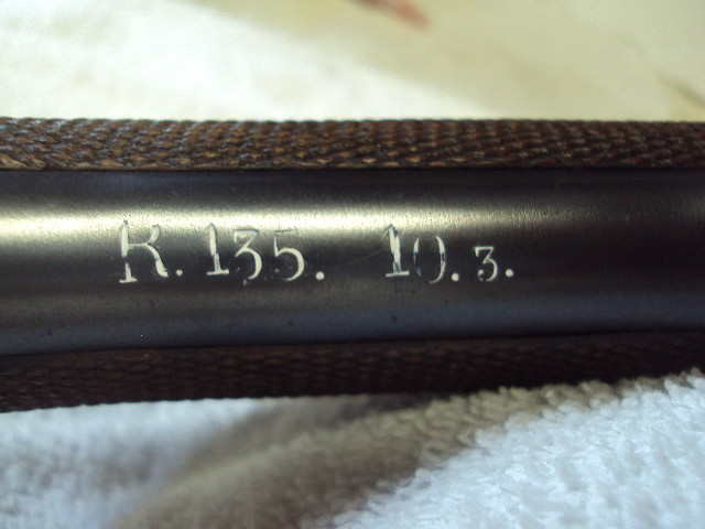

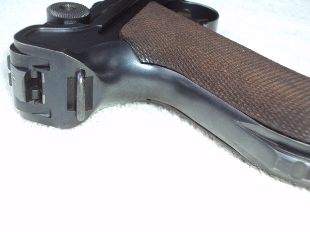

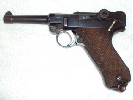

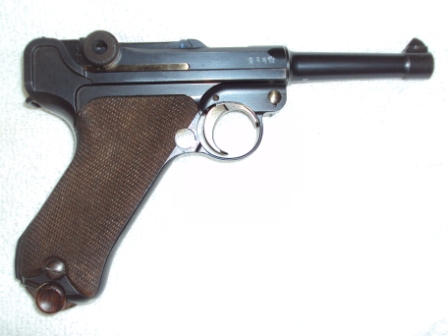

Here’s an excellent specimen, my second Luger acquisition, of a unit marked 1915 DWM pistol. On the front grip you see: R. 135. 10.3. Regiment 135, Kompagnie 10, Waffe Nr. 3. I was told this gun was assigned to the 3. Lothringisches Infanterie Regiment Nr. 135. The regiment was part of the 33. inf. div and fought at the Western front. This gun is exceptionally clean except for some minor pitting in the barrel. I would rate this gun an overall ~98%
Amazing that this gun could have survived as intact as it is given its history.
Feedback requested.
Thanks,
Larry

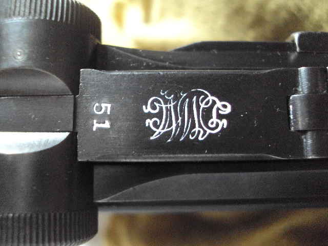

A better shot of the barrel stampings, (i.e. serial number) without the white paint would help in rendering an opinion.
At first sight and from the photos provided I'm going to say really nice rrestoration. Not the original finish

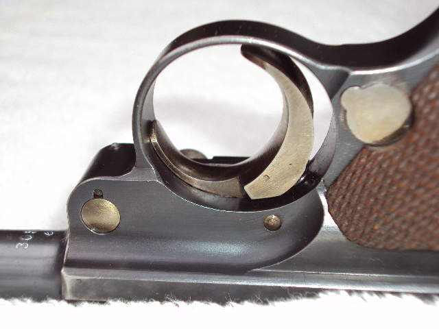

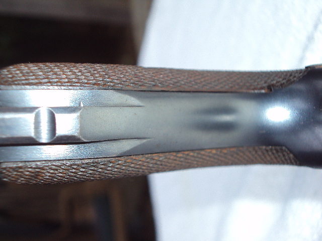

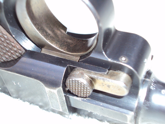

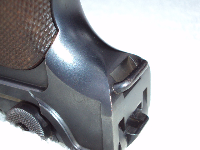

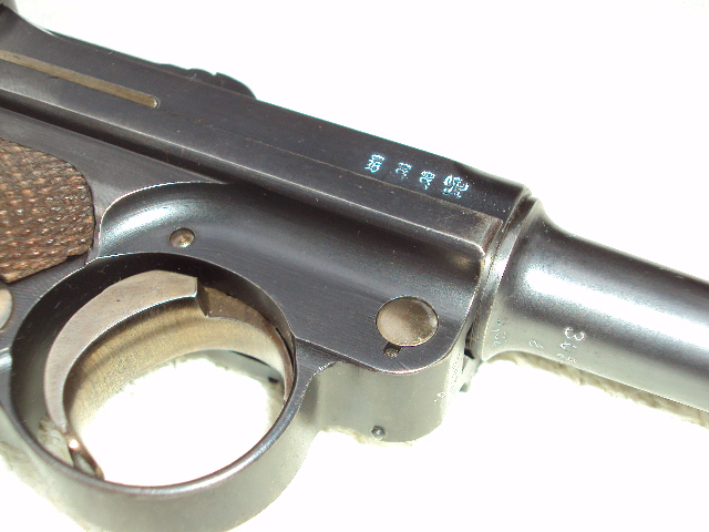

I do understand that irrefutable evidence is required for qualified opinions from experts on this site and would expect no less.
So, here’s another attempt at getting better camera angles after experimenting with lighting and removing the china marker as best I could without scrubbing.
The halos around the numbers and metal displacement clearly showing stamping after bluing as much more evident. Bluing is 100% original.
Also tried to capture better detail on the grip checkering which also serial match the gun as well as other angles of the frame. Straw is showing actually greater than 80% in these photos. Must be the lighting.
I have nothing to gain by misrepresenting anything claimed here as I’m not selling and expect this to be my son’s someday.
Thanks in advance for your comments.
Larry

Unread 10-17-2010, 07:27 PM   #6
Hmmm, I'm still not convinced. Your barrel photos still show what I would consider buffed numbers and if you see haloes I certainly dont.
Your photos tell me absolutely nothing new and the regimental markings on the front strap look buffed out and show no haloes either.
You may be convinced but I certainly would not purchase this pistol as an original finish gun.

Well the halos are hard to see and even harder to get a good picture of, for me at least with my camera setup.
If you look at my second photo post, first picture, you can see faint evidence around the #3 and also on the bottom edge of the number #1.
Also, the #1 has raised edges that are now shinny. If the barrel had been buffed, I would not expect to see any raised surfaces around any of these numbers. They all have raised areas in varvious locations.
Thanks,
Larry

I see halos. Very nice gun.

Unread 10-18-2010, 10:19 AM   #10

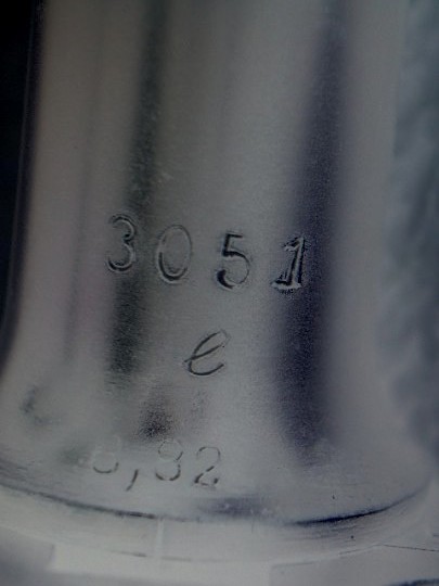

I'm with Ron on this one. I've enhanced the photo, the halos are evident, and the texture and satin hue of the finish looks original.
A nice Imperial...

That straw coloring is a close to new condition as any that I have seen. Anyone have Luger's with that nice of straw?

I certaintly do not know whether it is original or not. However when I see one that old with that finish my hackles go up. Some of the numbers and the DWM appear to be fairly faint. This is one I would need to study in hand before I could say original. And maybe not then. There are some very nice restorations out there. Nice luger regardless. Bill

Thanks to everyone who has commented so far.
I will say that this one had me going when alanint first questioned the finish. I have been over this thing multiple times in every nook and cranny with a magnifying glass looking for any signs of alteration. The gun is white inside, as it should be. The straw actually looks better in these pictures than it really is. I think it was the lighting. It was cloudy when I took the pictures outside.
Then I asked myself, if someone that had so much talent in boosting guns, waste their time on this one? They should be spending their time working on Navy’s. They have left no evidence I can see. They would have to had started with a gun in such good condition that it would almost not have been worth it. Wouldn’t the fact that the gun is unit marked with matching mag be enough? The mag shows hardly any use.
I trust and value all of your input here because I’m a “newbie”. Not to guns by any means but certainly to Lugers. I’ve seen my share of hacked guns and have been collecting/accumulating Winchesters, Walthers, Mausers, and Colts for years. It would really piss me off at this point in my gun collecting career to think this could happen to me, but it’s always possible.
But this is the reason we are here. I also wonder if I had posted this just saying here’s my gun, without calling any special attention to it, would we be discussing it now? It’s just a clean imperial. I’ve seen much better in Jan’s books.
gozrula is offline   Reply With Quote

It looks original to me my friend. I been examining them for 24 years. The blueing on the gripstraps MAY have been touched up with a cold blue, BUT so what? I do not consider cold blue retouches as a genuine refinish. A genuine refinish is when the old blueing is removed from a wire wheel and it is polished. It looks legit to me. The fact is has the original magazine is amazing.

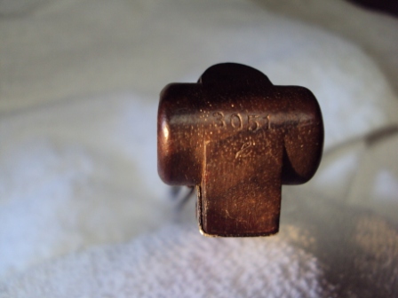

Unread 10-22-2010, 01:01 AM   #20
Brad
Guest
Posts: n/a
The sear/trigger bar seems to have a different number on it than the rest of the parts which have 51. Cannot clearly see it due to lighting. What is the number?
