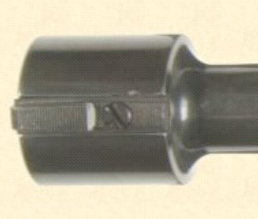

I took a closer look at the front sight on this Dewey barrel and decided I like it, for a target pistol. It's removable, and fits in a slot, not a dovetail. It could be changed quickly if required. And it would be much easier to make.
For the price, it may be a good deal. You would at least have the basics and could work on the rest...
