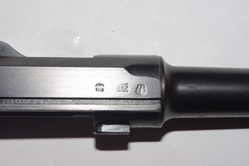

You have a G date. The 'secret code' for 1935. Generally scarce but not rare. About 54,000 made. But there are variations on the proof marks, found on the rt. side of the receiver that could increase its value. Hard to describe, but think of a football goal post on it's side with letters and numbers inside. Then later came what we call E/63, Eagle 63.

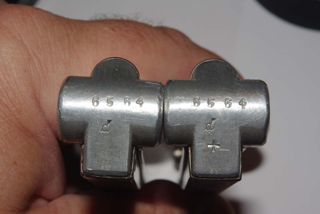

Matching magazines increase the value too!

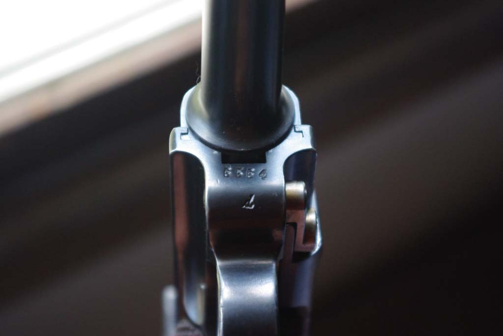

PS: Ah! OK, I looked at more of your pix. Ser. no 6564d. That would be sub variation 2, about 20,000 made. But I just can't make out the proof marks mentioned above.

There are three proof marks there. One is definitely an S-92, to the left of that there's another that looks like an bird with what looks like a 63 underneath it (or maybe 03). To the right of the S-92 is another one that is hard to describe - you might be able to make it out here: http://www.motosportsdesign.com/stev...s/IMGP1430.htm .

What is the full serial number found on the front of the frame, under the barrel. There may be a script letter there too, like d or an f. Also what is stamped on the tool?
FN

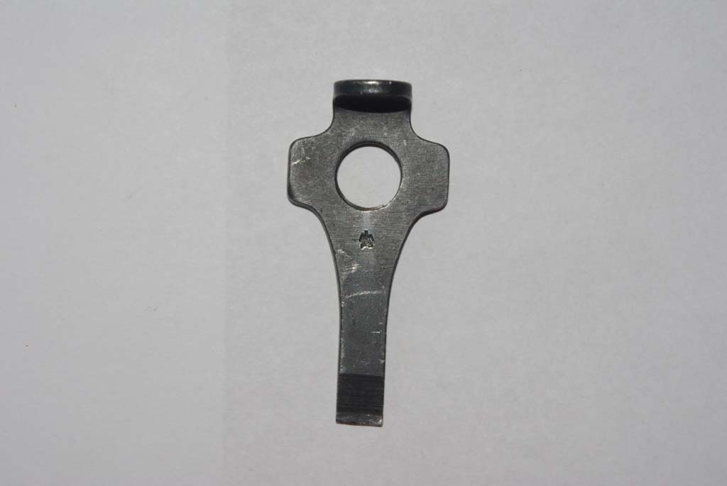

It is 6564 d . You can see the marking on the tool in this pic: http://www.motosportsdesign.com/stev...s/IMGP1427.htm .

The DE63 S-92 is the 5'th of 6 variations of the G Date Luger...
http://forum.lugerforum.com/showthread.php?t=22680
This could be a desirable variation based on the numbers produced, and it looks like you have 2 matching mags which is very desirable. I'm no expert, but, IF everything is correct with the gun and mags, I would think maybe $3000 and up? What say the experts?

On the other hand, if, indeed your rig hold up to inspection and further scrutiny, it is among the most valuable of the G-date variations. As previously mentioned by others, it is the fifth variation of six and was only produced in the d-block fairly late in the cycle of G-dates in 1935. About 2500 were produced making it one of the more scarce variations. The second most scarce in fact.
Now to the average Luger collector, this would not mean much. But to an avid collector who appreciates the subtlety of acceptance marks and the transitions that took place in the d-block, the gun has additional value.

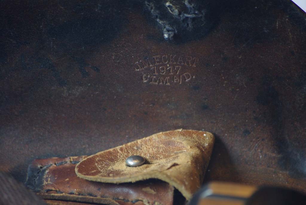

PS: Pictures of the back of the holster will tell a lot about its "matching" or not. Just FYI, a lot of 1935 guns were not issued with 1935 holsters
JR

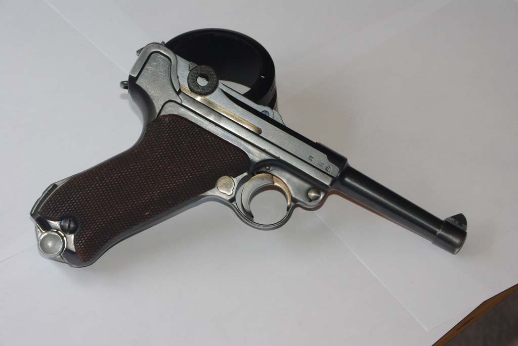

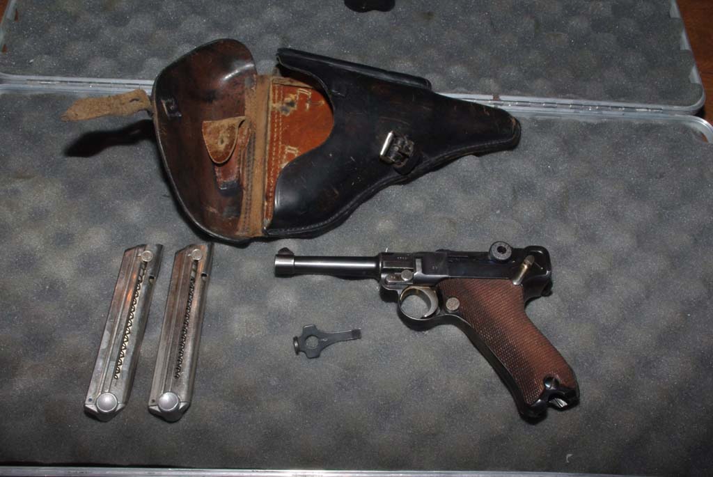

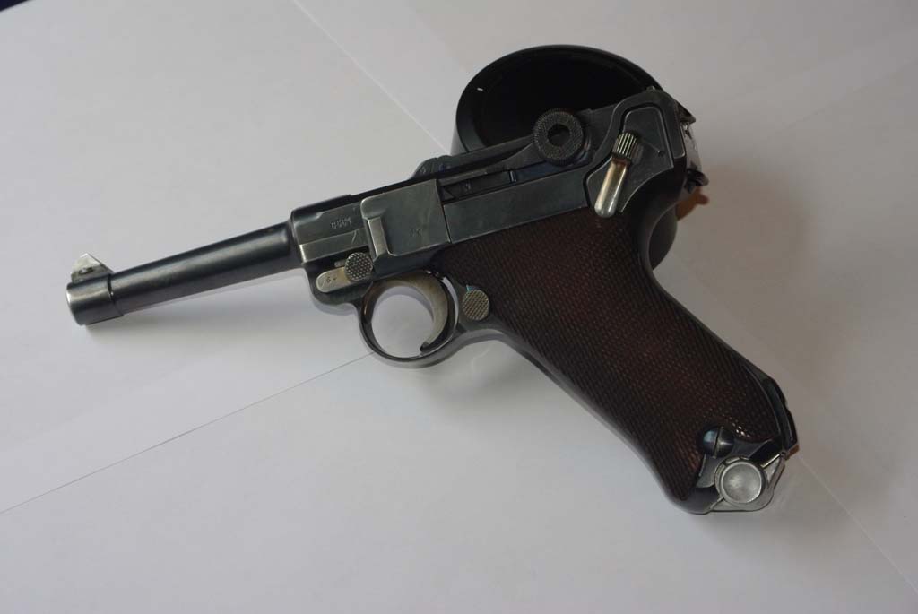

First some shots of the gun itself and the entire set

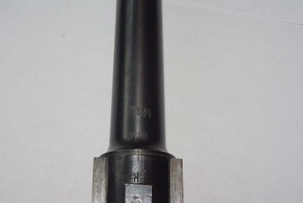

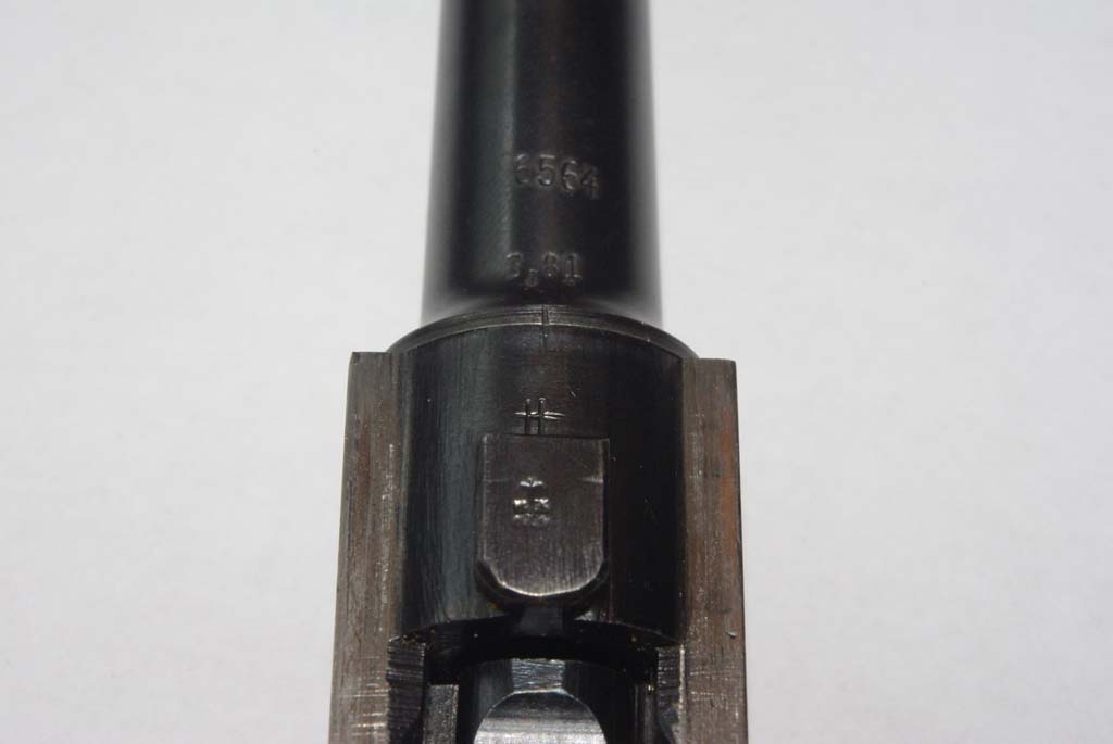

Here are the proof marks on the right side of the frame and barrel and also the serial number markings on the front of the receiver
maduro_fan is offline   Reply With Quote

Here are the proof marks that are under the receiver/barrel and also on the underside of the rear of the receiver & bolt

Here are the markings on the mags and on the tool. One of the mags has a + on it that's not on the other one. Both of them have an eagle with the 63 under it just like on the frame that may be hard to see on this picture. Both mags work perfect.

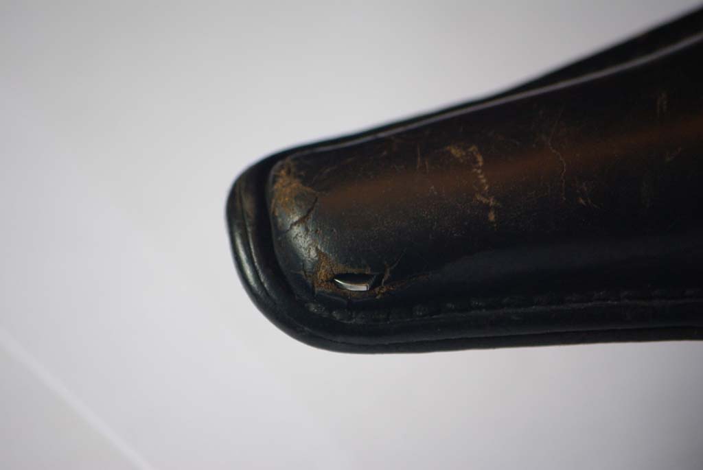

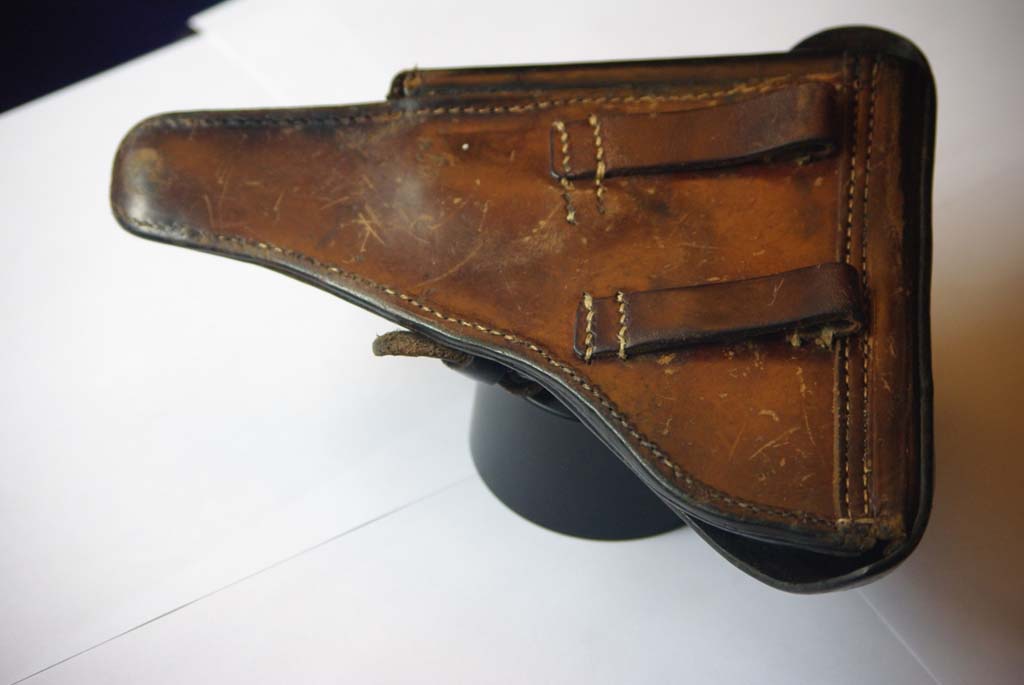

Lastly here are photos of the holster - the back side as requested and a better shot of the stamp inside the flap. I've also put a photo of the only issue I see with the holster - where the front sight has worn through the holster.
