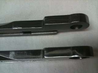

I have a SPM #8543 SS Luger American Eagle made in 1993. It is my shooter about 1000 rounds in the last year.
I have had the following problems with it:
The tale down lever would fall down on fireing (Doc told me to put a slight bend in the side plate arm and that fixed it).
I also had problems with feeding after the original Magazine had a broken plastic follower. The original magazine is SS with a square spring plastic bottom and a poorly designed plastic follower.
I tried several magazines and found that the magazine from my 1970,s Mauser Luger (Stiff Spring) and a Mec-Gar jammed and my 2 cheep SS mag. single actioned The single action problem was fixed on the SS mags by changing the springs to a Wolf +10% SQR spring. At least in my case I think that the balance of the mag spring is important, too stiff and it jams too weak and it single actions. I also fixed the original magazine by replacing the broken folower with a metal one from a Mec-Gar.
I still have a problem on the last shot, sometimes the action does not stay open (my next fix it project)

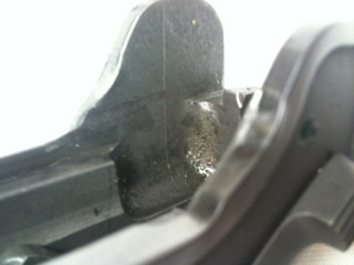

I have some worries about deforming of the Horns (see picture) Will it continue to get worse or has it deformed all that it will? It was not this way when I bought the gun. Will this eventually fail?

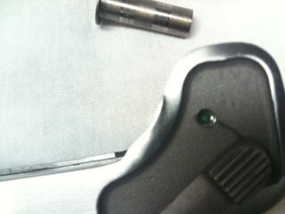

I am also concerned about ware of SS to SS as you can see on the rear toggle pin and fork (see picture) Is there a special lubricant to use on SS to prevent this ware?
I am happy with the Gun and it shoots well now.

Thanks for the pictures of the SS Luger problems.
The ramps may self harden and then on the other hand may not.
Try to use lighter ammunition and bullets, if your gun will function with them.
I have not heard of it being done with SS guns but you could research heat treating them for hardness, it worked for HK.
On the ware I would suggest not using products with TPE or graphite. They do help products to slide and stay functional but the particles themselves create and often over looked issue. They act like very very fine lapping compound and slowly remove metal under high pressure. It’s hard to explain but the particles actually push the oil away from the under lying metal, if the pressure is too high they slip causing gouging. Sure the action continues to function but damage occurs.
Good luck

I use only White Box Winchester 115 gr Ammo.

Thanks Chormeed for the pics of the deformation of your stainless luger ramps. I read about this problem in a different post and was wondering what it looked like.
I also have a Mitchell SS luger,that I have owned almost since new. Have shot a bunch of rounds thru it with no deformation.
I try to use the least powerful ammo that still functions the action. Since I only shoot at paper,stopping power is not a issue!
What do you use for lubrication? I have had very good luck with the Tetra grease. It seems to mitigate the galling problem that stainless has when sliding over itself.
As a aside,I purchased new in 1977 a 45 ACP AMT Hardballer.Its a 1911 clone made of a early type of stainless steel. It was the first production stainless 45. The Tetra works great on that gun as well,and it has had thousands of round thru it. Of course,I also installed a buffer and a stronger recoil spring to keep the slide from cracking!

What ammo is lighter than 115 gr Winchester White Box?
I use Hoppes #9 oil and now use a black grease called GunSlick on the arias that I see signs of ware. That GunSlick came with my first gun cleaning kit I purchased in 1958 when I was 14. I also have a Springfield Stainless Steel 1911, it seems to be made of a different SS alloy the color is more gray. I have never had any problems with it It never jams but the Luger feels much better in my hand and the Ammo is less expensive.

LSA was developed to eliminate galling of the aluminum/steel surfaces on the M16 rifle and it does an admirable job on stainless as well.
Found at any gun show, the white bottle LSA is to me the best. Shake well, apply a thin coat to mating surfaces. I've used it on Colts, S&W's, Coonan, Ruger, and Automag. Never had a galling problem.
