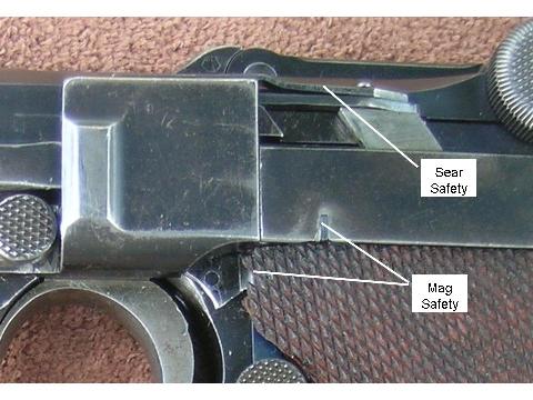

You are describing the thumb safety found on all Lugers. The sear safety is a device added in 1934 to most police Lugers. It consists of a leaf spring attached to the left side of the frame with a rivet. See the attached photo.
The I. designates Wesermünde.
When the barrel was replaced, the new barrel was stamped with the serial number of the frame.

Thank you, Don. My pics are on p. 7 of albums-called My 1 & Only Luger. It does have the sear safety, BTW, just like the photo you sent me. Cop gun it is.
