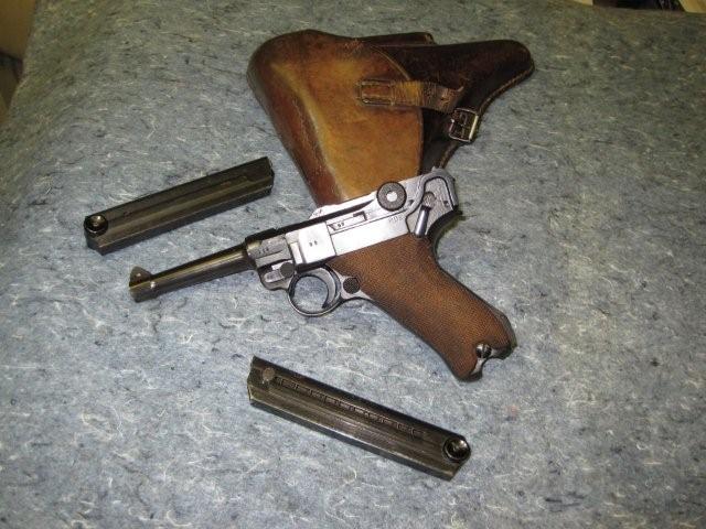

Hi guys,
This is my first post and I am a proud new Luger owner. I purchased a very nice BYF 41 at the estate sale of a WW II veteran. The gentleman was a P-51 pilot stationed in England w/ the 353rd Fighter Squadron.
The Luger seems to be in excellent condition, with all matching numbers except mags and take-down tool. That's question #1 - Should mags and take-down have matching numbers?
I would rate the blueing at 96%? Holster wear on muzzle (both sides) and trigger sideplate are only two spots. Wooden grips are in excellent condition w/ the diamond points showing very little wear.
The mags (2) have plastic bases. Are marked P.08 and FXO. Question #2 - Are these correct mags?
The serial # for this pistol is 198. There is no letter under the serial number under barrel. My understanding is that this was the 198th pistol made in the year 1941. Question #3 - Does having a 3 digit serial number increase value at all?
The brown holster also seems to be in very good condition, with Nazi proof mark and maker on back (I can't remember maker at the moment) The big flaw w/ the holster is that there is an American name and service number etched into the front of it below the flap. It is different than the name of the vetern listed above. I presume that it was picked up by the first fellow and then was traded and eventually ended up w/ the fighter pilot.
Also included are the take-down tool which appears to have a Nazi proof mark, but it is to small for me to read at the moment. And the original letter from the 353rd ordnance officer authorizing the pilot the Luger as a war trophy. Interestingly, on the letter, the caliber is listed as .38. Perhaps a rear echelon army air force ordance guy didn't know caliber of Luger or a typo. I also purchased an original card board box of German 9mm ammo w/ all ammo unfired and the Zippo lighter w/ pilot's name (not sure if WWII or after) which I will keep w/ pistol.
I got into a bidding war for the pistol and I am concerned that I overpaid for it. Based on the info above and my poor pics that I have included, could you guys give me ballpark on what my set is worth?

Hi Steve, Welcome to this forum and Luger collecting. Unnumbered black plastic based magazines are correct for late 1941 pistols. Only takedown tools for police use were numbered. One Luger in ten has less than four digits in it's serial number, so they are not that uncommon. I, personally, don't mind holsters that have a GI's name and number inscribed, as I think it's part of it's history. Other collectors might feel differently, so an inscription does have some negative effect on value. Regards, Norm
Unread 07-28-2010, 10:15 AM   #3
The 41BYF PO8s serialization began in the "n" suffix block mixed in with 41 code 42 PO8s, so your no suffix 41 would have followed those in the "z" block, so not early 41. Assuming all matching with 98% orig finish, I'd estimate your rig in the $2K range. TH
Unread 07-28-2010, 10:18 AM   #4
Hi,
I'm still relatively new to this, so my valuation is probably off...
You have a particularly nice Mauser made Luger pistol.
The "FXO" magazines manufactured by Haenel were made using extruded steel, and are the best Luger magazines available.
Others can confirm this, but the name on your holster is part of its history and doesn't necessarily detract in value. From what I can see it is an original holster in very good condition.
The magazines are worth $125 each, and the holster is probably worth $225-250.
The "Bring Back" letter adds value to your rig. Perhaps 10-20%.
If never refinished, the all matching Luger is collectible, and would command a premium.
You can compare it to the commercial retail sales taking place by dealers like Simpson and Company in Illinois. They are about 30% higher than collector market pricing.

I paid $3300, sad to say. I had a feeling I was fairly high, but I guess that's the risk of buying at auction. However, (perhaps rationalizing a bit) I am still happy with my purchase. I wanted a Nazi era pistol w/ holster and bringback paperwork. I know exactly where it came from and that it hasn't been messed with. My only regret, is I think I got one that's to nice to shoot. Guess that means I'll have to start looking for number 2!
Thanks for the feedback. Especially the serialization info.
My "bringback letter" is not the official form that I saw pictured on this forum, but the wording is the same, so I guess they didn't have any official forms at the squadron. It is clearly period, however.
