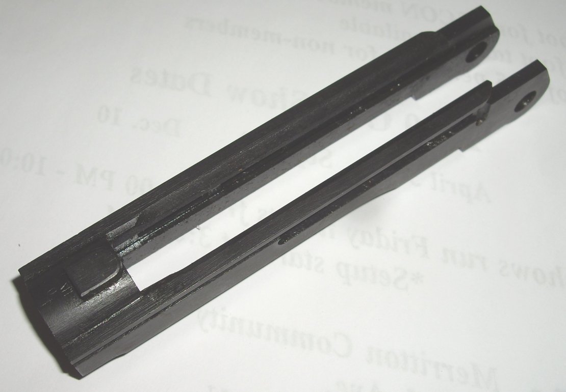

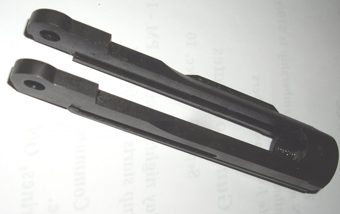

I have some pics of a 41 dates barrel extension that, to me, looks brand new. However no proof marks on the right side as one would expect on an issued Luger.
Would this be safe to build on? What would be a decent price to pay for this?
Thanks in advance

I believe that this barrel extension has been refinished... and there is no way to tell if it is safe to build on, but unless the gun was in a fire, it should be fine.

Thanks. I can email you the original pics; too large to be posted so they were downsized. Let me know. My friend and i saw this together and although we are not Luger experts, we felt this was original. What where the tell-tale signs that tipped you off?

The finish of the upper receiver in your photos looks like it has been reblued because of the "brushed" appearance of the steel and the finish doesn't look much the the byf 41's I have seen. That just could be the lighting in your photos, but my impression is that the finish and lack of acceptance proofs on the right side indicate that this receiver was refinished IMHO.
