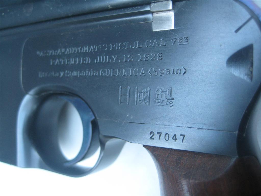

Only 900 Astra carry the "Made in Japan" Hanzi stamp. It actually says "Made in Spain", but it's better (but wrongly) known as "Made in Japan" in the past. Does not matter -- probably none of those 900 guns have ever visited either Japan or China.
The three Chinese characters were applied in the factory before the gun was blued. No halo, but does have a "3D" look and feel. It is an export stamp in exotic form. A close-up of the stamp is posted below:

"Only 900 Astra carry the "Made in Japan" Hanzi stamp. It actually says "Made in Spain", but it's better (but wrongly) known as "Made in Japan" in the past."
Alvin, do you mean that the 3 Hanzi translation is "made in Spain" ?

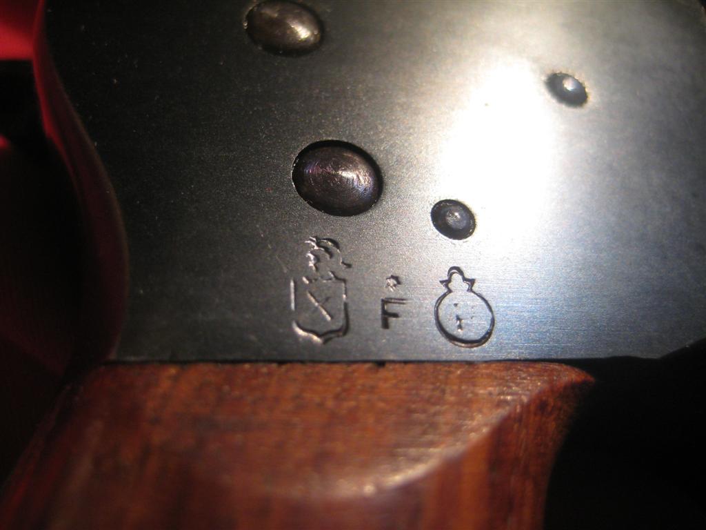

What is the letter in the middle of the two proofs on the right side (just above the grip panel)?
That is the code for the production year...
This pistols seem to the in MINT condition. Can we see the whole pistol, for God sake, Alvin?

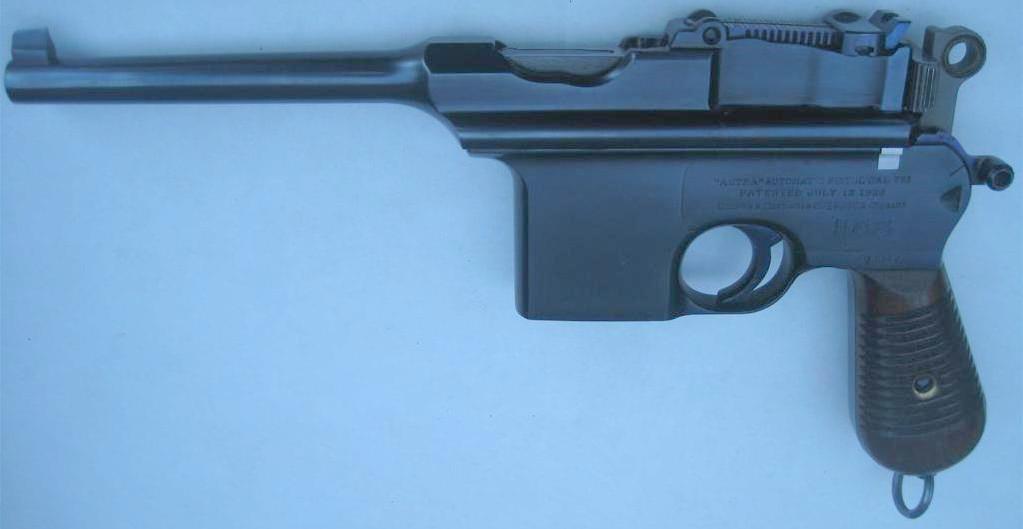

Yes, Doug, you will see the whole gun, but I don't have good lighting, so have to wait tommorrow's sunlight.
The middle mark above the grip is a tiny star over F, pix attached. What year is it?

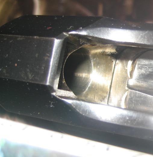

Also, here is another unusual finish that I mentioned earlier. I have seen many C96s with mint bore (of course, I have seen more C96 without mint bore), but I have never seen this before -- this Astra's chamber is golden, more like strawed. It's hard for me to believe chamber need any finish, but metal under heat in certain temperature range could show straw color. I would guess the straw color was the result of chamber heat treatment.

Did a little research. So F says it was proofed by Eibar Proof House in 1933. s/n 27047. Another instance not far away "Made in Japan" instance was pictured in Antaris' monograph.

Back a while ago, I saw a small ring big grip transitional model (in Astra context, SRH is rarer than LRH), but the bore is not very good. So I gave it up. That's probably a mistake. Last year, there was another one in good shape in NH, but I missed that one. NH one is also posted below.

My understanding is that the correct translation of the 3 nice Hanzi ( re-guo-zhi) is not "made in Japan", but "made (for) Japan", or better "Japan contract".

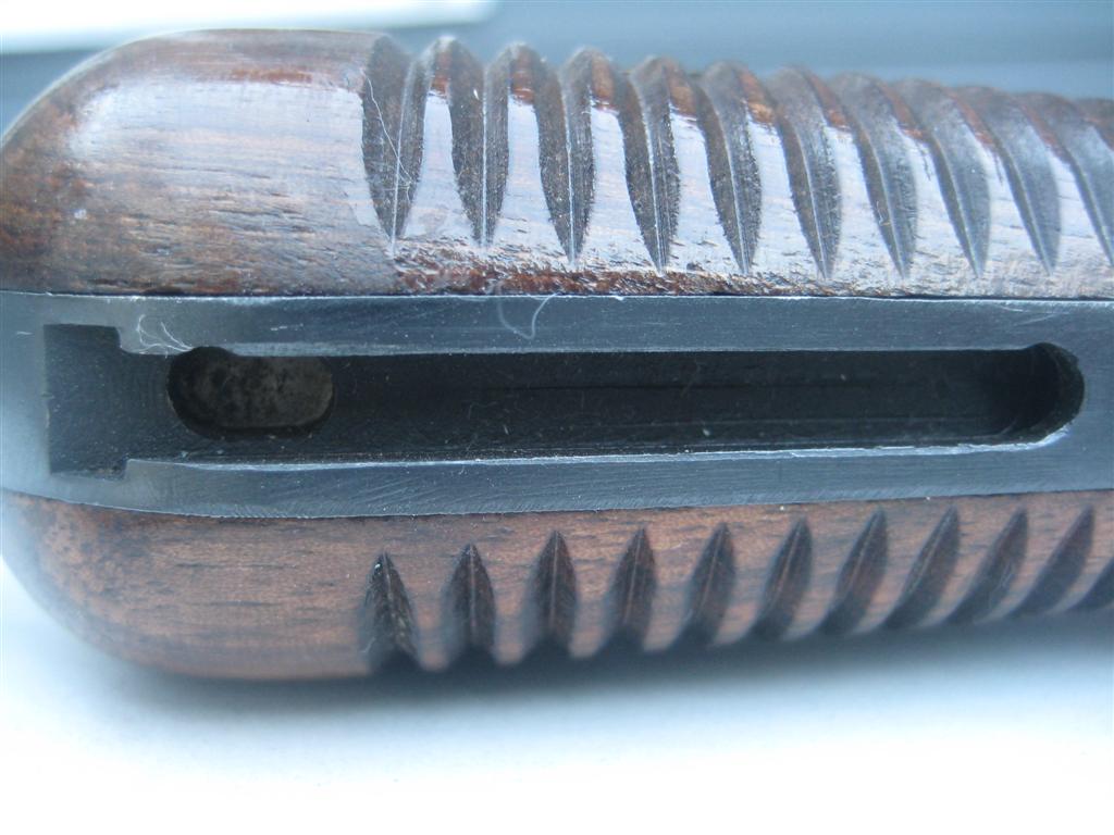

Alvin, that Astra 900 ser # 27047 seems to have a removable sideplate...Have you taken it off??? I would be interested in pics of the lockwork, if you have taken any...

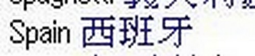

Regarding those three Hanzi…. It’s “Made in Spain”. Here is a little bit more in-depth look at this:
Nation name translation in Chinese language was based on pronunciation of the nation. Major western powers were commonly assigned a single Hanzi (the 1st Hanzi) which pronounces not far away (not exact, but close enough) from the sound of the 1st or 2nd syllable of the nation’s name in that country’s native language. The second Hanzi was fixed “國” (“guo” -- country). For example, England, Français, Deutsch, America etc, were all translated this way.
One problem of this translation system was obvious: there are so many countries in the world, and if each one were assigned a single Hanzi, it would be hard to remember those translated names. The solution was simple: most country’s translated name was the full pronunciation. So, the translated name could be very long.
So, this language is ‘biased’ on nation name translation. Schroeder mentioned in Guns Report that the first two Hanzi translated into Spain, that’s correct, but he added an extra comment saying “Sun Country”, and that’s not right. A Hanzi commonly has a few meanings, and no meaning was assigned to it in the context of nation name translation. After all, it’s just by pronunciation of the leading sound of “España” (the sound before s). No more, no less.
Shame on me -- I cannot open it. Both the magazine floor and side plate are tight like being welded on. If I do that by force..... no, looks like it's not opened before, I will leave it alone.
That's the reason need a 80% one
Unread 03-06-2010, 12:01 PM   #12
Understood.
However...If curiosity gets to you, try leaving pistol in refrigerator (not freezer) for a couple hours...then try pushing sideplate off...
Heat expands...cold contracts...It might contract enough to loosen...

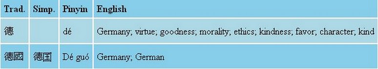

I don't want to modify this interesting thread, devoted to a
wonderfull and mint Astra into an Oriental linguistic debate, so this posting will be my last contribution on the problem. Even if the subject of the thread is precisely "Close-up picture of "Made in Japan".
Postino,
Sorry, the 3 Hanzi on your Mauser M1930 mean: "Made in Germany" (De-Guo-Zhi) as pictured on the photo below, and not "Chinese contract".
Alwin,
I agree with the first part of your reasonment, but not with the last one. As you know, the Hanzi "ri" is historically the traditionnal name of Japan in Chinese writting (and I believe in Japanese writting too) as pictured on the second photo below. It is unbelievable that they took precisely this historical Hanzi to translate the word "Spain" for... the Japanese market !
I note that Germany and Spain had two different stamping logics here:
The Mauser M1930 has the stamp "made in Germany" since
Germany is easy to translate in chinese (De-guo).
The spanish Astra is stamped "Japanese contract" (and not
"made in Spain") precisely because "Spain" is too long and difficult to translate in chinese or japanese, as you said (see picture 3 below). No more, no less.
Also, is Schroeder a reference in Oriental languages ?

Sorry for my delay to answer you. You already found the information though. Yes, the year is 1933. The same of my Royal MM34.
It a nice good in mint condition. If it had been sent to China, I wouldn't be in this shape.

Originally Posted by laoshi75 View Post
Postino,
Christian - Sorry if my comment misled you...It is an export commercial Mauser M1930, made by Mauser for the Chinese market; and as you stated, it does say "Made in Germany", to the best of my knowledge...

Now, let's see why 日國 was Spain.
As you have noticed, modern translation of Spain is not 日國. Actually, Spain was not the only country that has two forms of translation.
Spain -- 日國 (sound of leading E + country), or 西班牙 (sound of "spaña")
Why 日國 was not commonly used today? it's too easy to confuse this name with Japan. So, from a bigger view, this change of translation reflected a new rising power in Asia, Japan obviously had more influence than Spain in East Asia country's political and economical life.
Japan is special case. Japanese language has a few thousand Hanzi (or Kanji). The country's name did not need any translation. When Japan is 日本國, and there is an European country named 日國, there would be lots of confusion.
But, from Spainish gunmakers point of view.... using 日國 is better than using 西班牙. It's shorter. Not many countries enjoy two-Hanzi-character translation, it's a previlege.

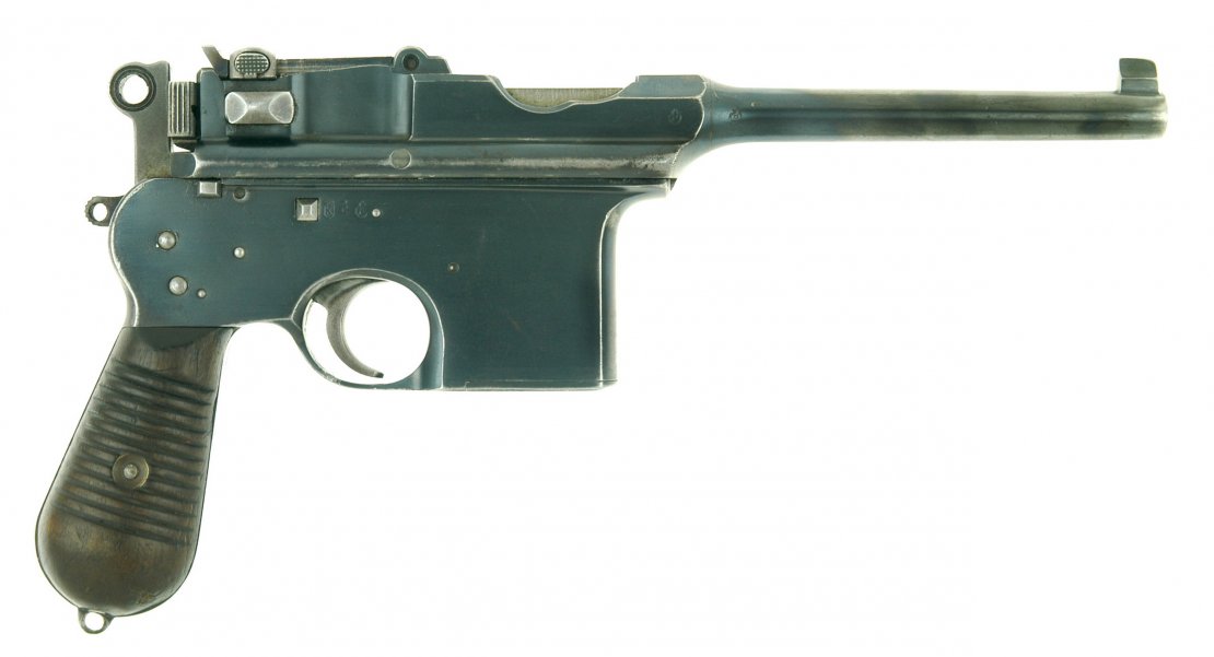

Let's look at some detail. There is one Astra 900 with matching stock for sale in the coming GMA session Lot #2098, s/n 27030. Here is a little detail comparison:

Not mine, but FYI, #27x07 ( hard to make out he third digit "9"?) in similar condition is up for sale via GB auction # 159199241. It seems odd that they are all in such good condition, if not refinished at some point, they must have sat in an arsenal most of their life?
