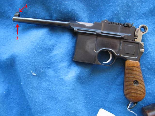

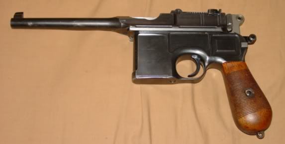

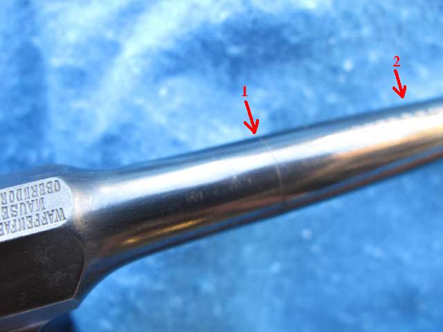

On the third broom, it is mentioned that there are three seams "barely visible" caused by rebarreling. What caused there to be three seams? Thanks

From pictures posted, I only see two seam lines. One is at the middle of the barrel (1), and another is near the muzzle (3). I would think the gunsmith cut 2/3 of the old barrel off, brazing welded (using silver or copper) a section of new barrel with relatively better bore to it. The seam line near muzzle (3) might came with the brazed-on new barrel -- it had also been reworked on the front sight (4) before marrying with this gun.
Please also note the text on the brazed-on barrel (2). It's not readable. Some British dealers put their names on the gun barrel saying who sold it. The replaced barrel might came from a captured British gun during the Boer War. Of course, without see the exact text, that's only an estimation. The text could also be a recent U.S. importer stamp.

Thank you Sir. I could see the seam closest to the breech. Beautiful work. Seems like along way around the barn to improve the rifling. Couldn't they have machined a new barrel just as easily? Again, I know nothing of brooms, but am learning. Alvin, you are a wealth of information. Thank you again.

The seams are curious...Especially for a "very well known and respected company"...
My WAG would be that it was cut forward of the chamber to eliminate the need to re-chamber it...Silver-soldered to allow fine tuning the front sight placement (angle from level)...
Sawing a barrel off a damaged barrel/receiver (they're one piece on a Broom - think Tokarev 7.62 ammo damage) is quicker than machining a new barrel, chamber reaming, and indexing it...

Seems to me anyone with the sort of skill required to join up
three different barrel sections would have been better off
threading a entirely new barrel onto a cut down extension.
Silver soldering barrel pieces together seems iffy to me.
Threading 3 pieces together seems like extra work; what about the rifling? perhaps it was actually lined as well, I hope.
Certainly not 'Mauser like'
Jerry

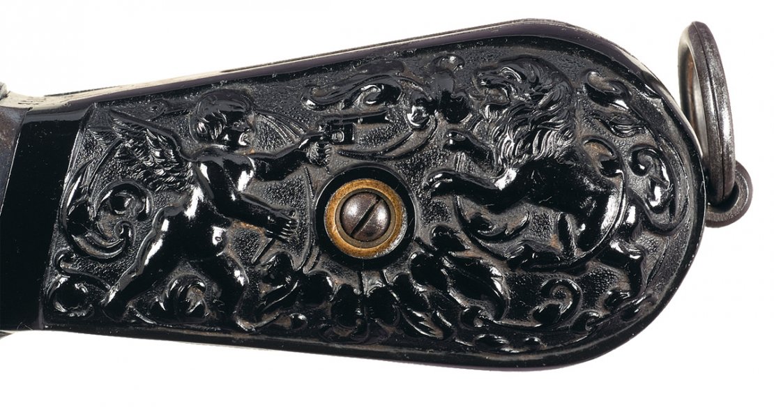

History Written on Grip -- Angel Boer Fighting British Lion..... It's the first time that I noticed this angel was left handed, and his right hand holded a dagger.

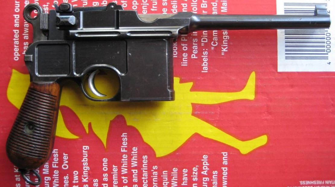

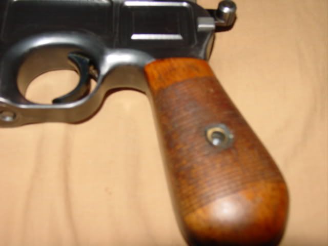

I picked this one up at a local pawn shop. They were putting it out for sale as I walked in. I figured for$ 500 out the door I could not go wrong. (Or did I) The fire blue parts (extractor, trigger, rear sight) are very nice and the bore looks new. Has original stock with a glued crack in the lid. I think this is a pretty common pre war commercial but this was my only shot at owning a broomhandle what do you guys think?
Trumpeter is offline   Reply With Quote
Old 04-23-2010, 06:47 AM   #20
Looks like a 1915 gun. The reoilded stock (without counting the gun) with these repairs can easily sell over $200. The gun if all matching and original could go over $1k. If stock matches the gun, they better go together. You made some money. Even if it has minor issues, $500 is a winner.
Gun like this has a big advantage -- it's shootable, can be used occasionally. That's extra bonus. It's probably the most common C96 in U.S., but averagely, you met at least five DWM Lugers of the period before you met one of this particular variation. And probably met 20 small ring C96 before met a cone hammer.
