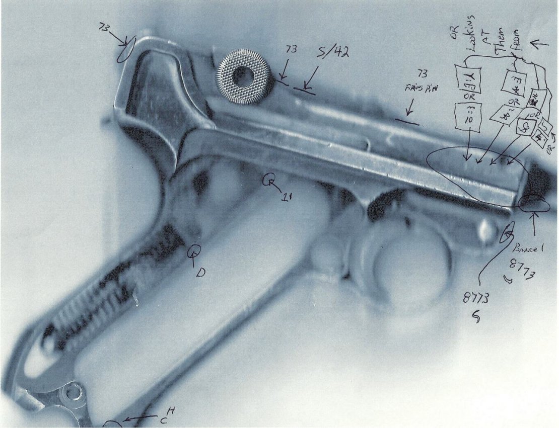

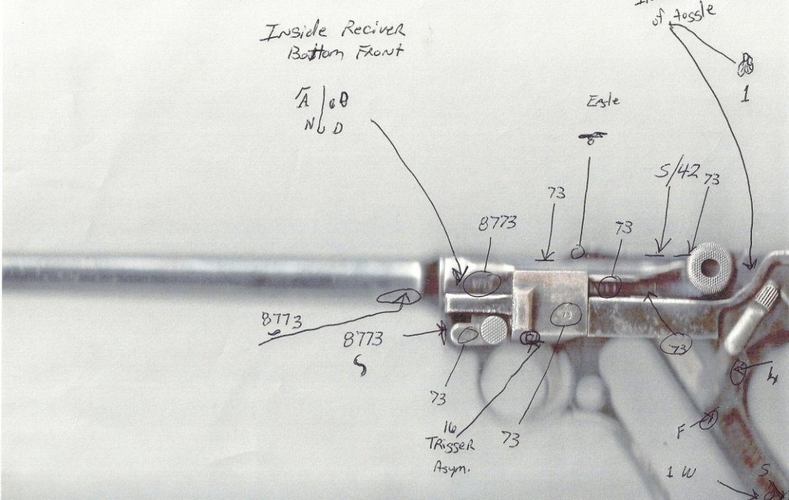

Hi Guys. After more than a week of reading here I now can clean, and I think, call my Luger a Navy LP08. It is a S/42 and has a German eagle mark on it. So I think it was made between 1939-40 but no dates anywhere. All the numbers match ( Ser. # 8773) and has one mag. with a wood bottom. The wood ball is broken into two pieces with one piece missing a chip. My pictures are of no help seeing any detail. So, I am sending a photo copy of each side of the weapon with ALL markings shown by hand. Hope this helps.
I have $1,600.00 invested so all the information (good and bad) and history on this Luger will be greatly appreciated.
Many Thanks !!
Sorry Guys, I am having a problem getting the web site to take my attachments. I will keep trying and any help in this area as well is appreciated.

Unread 12-03-2009, 01:42 AM   #7
Thanks: 2,077
pictures for Andy

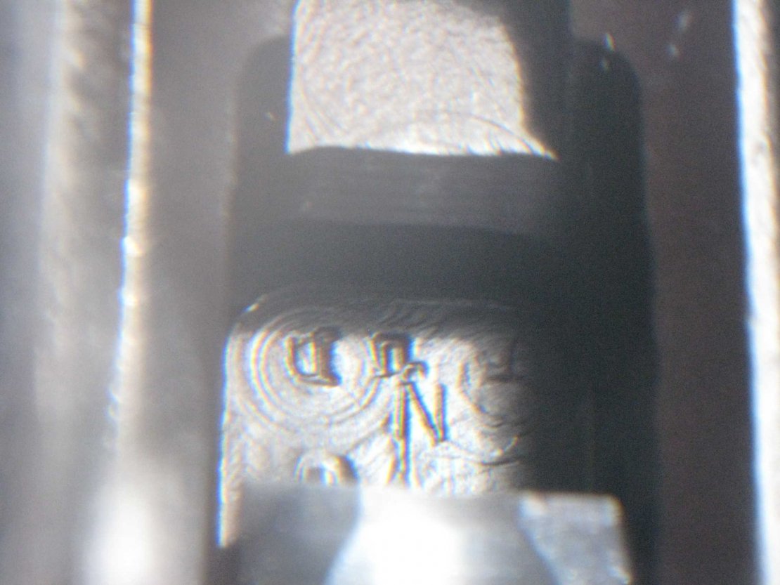

Unread 12-03-2009, 10:24 AM   #9

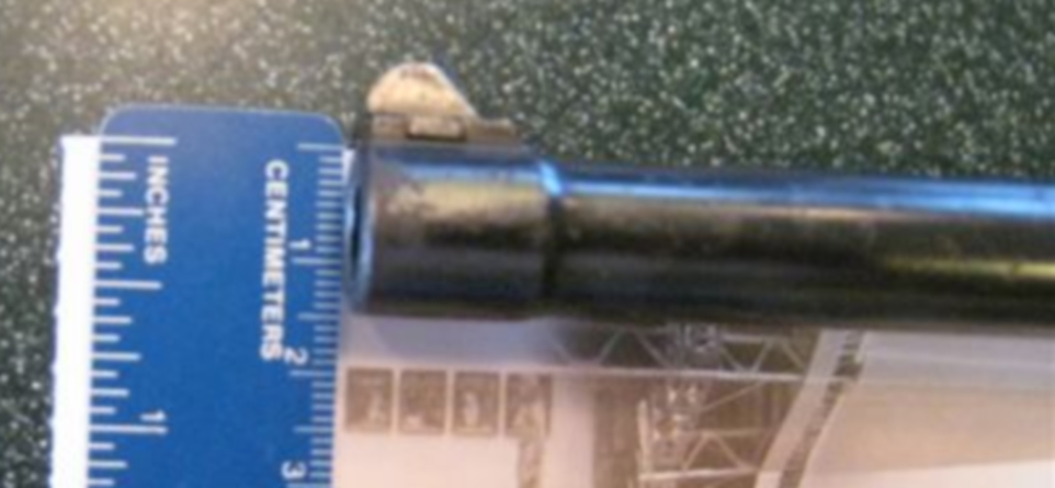

Arty notch in receiver; Erfurt??? The radius of the barrel flange looks too gradual to be made from the Luger blueprints...(Assuming the arty uses the same radius, which the ones I've seen pics of do)...
Front sight base looks like 4" base; blade looks higher than the 4" blade...
Serial stamped into the barrel...
Looks like a fun shooter; but the price seems...excessive...
In the stripped pics, it looks "in the white"...???...

Ed, Please explain " in the white" and how you measure the front sight base to get 4". Would this arrangement have been authorized by the German government at the time ?

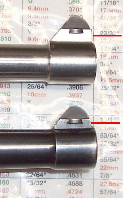

Unread 12-03-2009, 10:55 AM   #11
Thanks
Er..I'm not Ed (Thank God! ) but "in the white" means no finish/blue...
For the front sight base, take a look at the Artillery Luger section; look at the front sight bases...and compare them to a 4" barrel front sight base...(Or my pic below - Red lines in my pic point to the FSB)...
Here's a comparison of my S/42 4" barrel to a repro artillery barrel front sight base...I make the arty barrel FSB ~.090" higher...that's the base, not the blade...

Unread 12-03-2009, 12:47 PM   #13
Thanks Postino. Sorry about the Ed thing. Thats great information to have. I would say that the body rates 80 to 85% and the barrel 90 to 95%. Do you think the barrel is a reproduction or done by the Germans ?
A.
Andy, I know nothing about Navy lugers...I've read here that some "Navy" Lugers had 4" barrels and fixed toggle rear sights...The stampings were what determined whether it was a Navy issue or not...but a toggle mounted 2-position adjustable rear sight and a ~6" barrel are considered "Navy" as well...
Closeup pics of those frame markings/stampings will show exactly what it is you have...or what it's not...Drawings are not much help, as there are Lugers out there with false markings on them, being sold for more that they're really worth...A good closeup of that barrel serial is a good idea, too...along with a closeup of the frame serial (to compare fonts and number heights)...And any proof marks on that barrel...
I understand that some Lugers were fitted with long barrels...I have no idea by who or what...but there are some excellent repros...
More knowledgeable people than me will no doubt chime in here somewhere...
It's an interesting Luger...I like long barrels...
Unread 12-03-2009, 01:31 PM   #14
Posts: 2,675
Thanks: 3,247
Andy
In my opinion, you have a luger made up from parts of other lugers. The barrel and the S-42 toggle were never originally together. The barrel was force matched by adding the frame serial number. It would make a good shooter but never a collectible luger. Can you still get your money back? I would place the value around $800 - 900 or so strictly as a shooter. I'm sure my opinion is not good news but maybe you can get a refund or price reduction? Welcome to the Forum and the crazy world of luger collecting. I'm sure others will get in here with their opinions. Bill

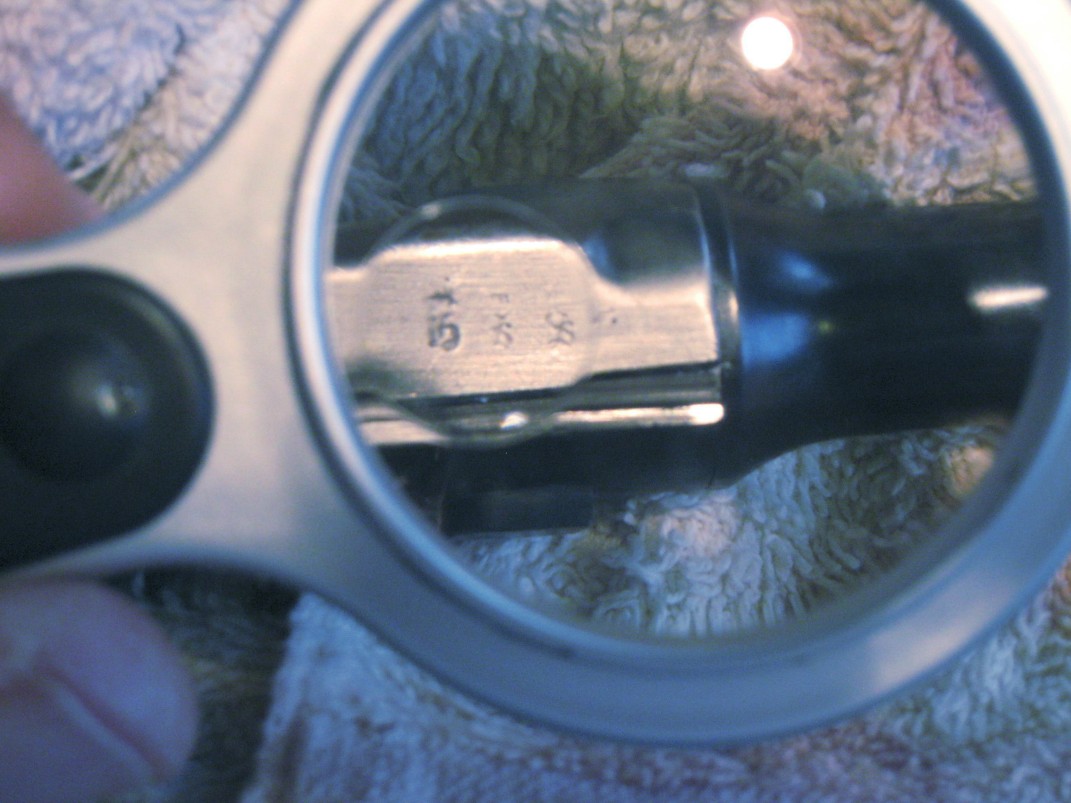

Unread 12-03-2009, 03:55 PM   #17
Rich, I have more up-close photos of the markings on both receiver and barrel if you think it is still worth looking at.
It is definitely worth posting pics. You may have a Luger that is worth more in parts than as a whole. Knowing what you have is always a good start.
Unread 12-03-2009, 06:59 PM   #18
Thanks: 2,077
more pictures.

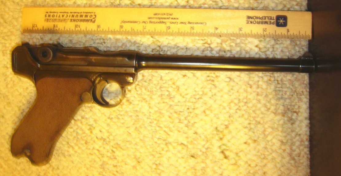

Unread 12-03-2009, 09:59 PM   #20
Andy -
Take a look at the first pic in hueydriver's thread -
http://forum.lugerforum.com/showthread.php?t=22836
Does your Luger have the crown over M on the left side of the receiver???
In the second pic, you can see that his Navy has the high front sight base, too...
