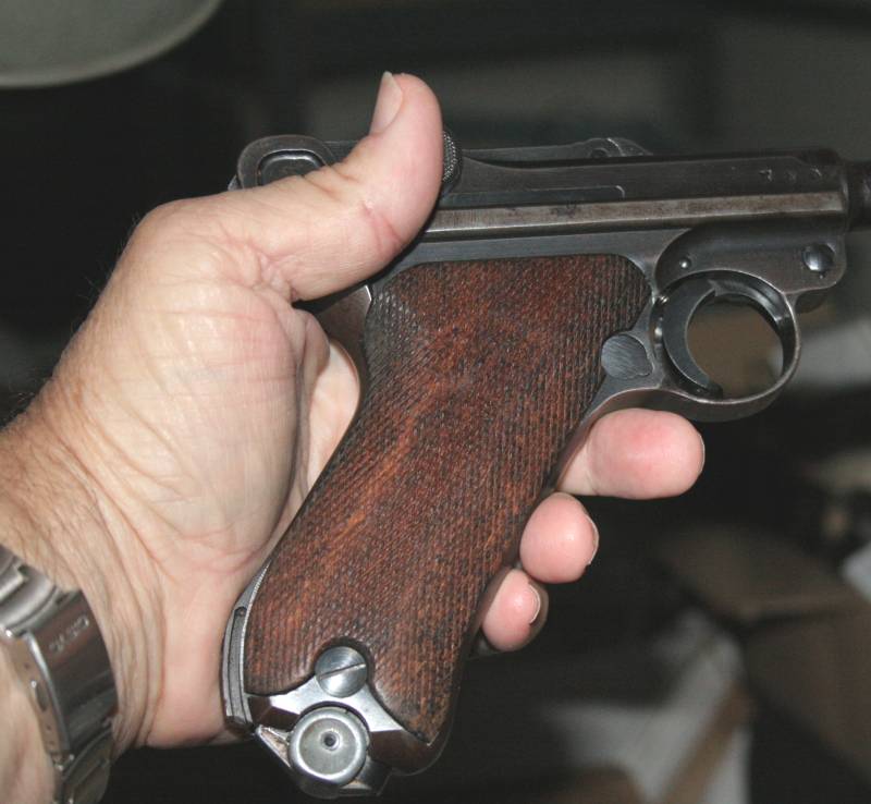

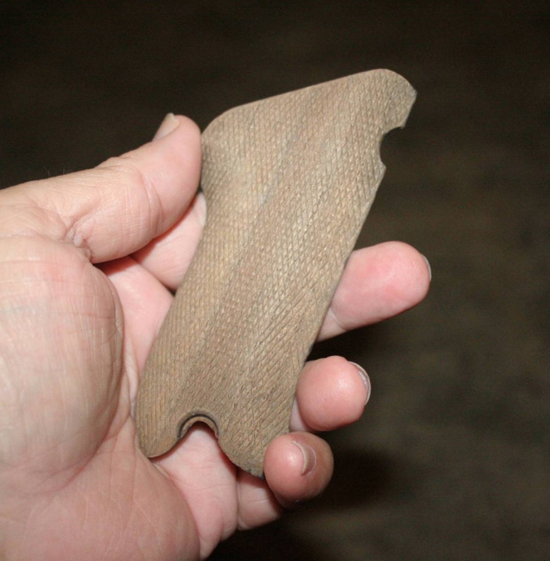

. . earlier today.
. . i read ed's note on murphy soap oil, and liberated a bottle from the local grocery, along with a toothbrush. i put the grips thru six soak, wash, and rinse cycles, starting with warm water and ending up with hot water.
. . i simply can not believe what was under all that grit. these grips were black. i had no idea they would turn out looking like this...
. . i have to learn how to boil linseed oil now.
. . thanks to ed and all the folks here for their help. i'm enjoying my machine.

Default they stayed immersed
. . most of the afternoon. they were only out of the water long enough to change out the water.
. . they swelled up enuf that i woulda had to force them back on the pistol, and i wasn't going to do that. i might shouldnta done it that way. im having to wait for them to dry. each grip lost about a quarter gram overnight. i don't know if its just coincidence, but the two grips weigh within 0.03 grams of each other.
. . i think i will try the watco polish. it seems to have all favorable reviews. but it may be a bit before they are dry enuf.
. . when i bought my '38, i didn't realize that the grips should have a wood grain finish. i saw pics showing it, and they looked very nice, but had no idea that i would ever see any grain at all in my black grips. when i did see the grain, i was one happy camper. even the unfinished grips make the pistol look sooo much better. yeah, its just cosmetic, but i was very pleased.
good luck with urs,
bill

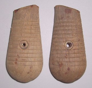

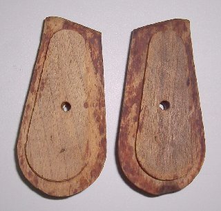

Not really on-topic, but maybe of interest...
These are the C96 grips I stripped with lacquer thinner...They had been varnished or something like that; most [but not all] of it came off after scrubbing with thinner...
Not the best, but the varnish/whatever was pretty thick...

. . i waited a week or so, and one grip was still tight, and the other was very tight. i went to work with what i think was 280 grit emery cloth, but i'm not sure just what it was.
. . the early interference points were visible. after knocking down these, i could see the slight interference spots by repeatedly pushing the grips into position and noting the bright areas.
. . a few more minutes and they fit perfectly.
. . in eyeballing the grips under the magnifier, i did thankfully notice the start of a crack in each. the superglue is soaking in now. each crack appeared to start at the screw hole. i'm sure i dont have any interference there now. i went ahead and put a spot of glue behind "the chip."
. . i did also notice a bit of damage from the mag release spring. you might want to insure that your spring is pushed to the rear as much as practical.
. . now, about the watco polish (its already purchased), can i put it on with a fine hair brush? ive seen several applicators mentioned, but i'm not sure whats wrong with a brush. should i put a coat on the back side, or let it breathe? i doubt that it will absorb enough moisture to swell any.
. . thanks for all the info, i appreciate it.
bill

. . in reading the instructions on the watco can, they didn't seem concerned about brush marks, so i went ahead and used a fine tipped brush. sure enuf, it soaked in quickly.
. . my grips now appear to be walnut, instead of some black plastic. i can even see the grain in it.
thanks, all.
bill
