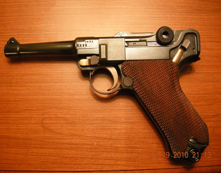

ok, so i just finished the luger. ive been in and out of the country and incredibly busy so the time i had to devote to it was severly spread out over a much greater time period then i thought. I reblued the entire thing. basically involved just a a whole lot of wire wheel on a dremel and alittle elbow grease and strawed all the small parts, thanks to the handy how-to on the forum. I know i didnt necessarily need to reblue the whole thing, but all the blues were different so if i redid it, they would all match. now i just need to resize the pics and remember how to up load them. let me know what you think!! i didnt weld up the x'd out sn like i had planned. i couldnt find an appropriate sized stamp and had to remember that it is a franken luger and doesnt require that kind of attention, i have my whole life to save for a real nice matching luger in the future.

well here's a simple left and right. I do love how the strawing came out. and it was so simple that i thought it couldnt be that easy. but a quick look in my machinists handbook reassured me

also, i read somewhere that the sideplates never matched the gun properly (even fresh off the line) in terms of finish and blue color, so i didnt polish it as much as the other pieces. so the blue is a similar shade but a little more dull. is that correct? or should i re polish it to make it match better?

You did a fantastic build job; its something to be proud of. As for the sideplate, I think I would make it match a little better but thats your call.
Charlie
