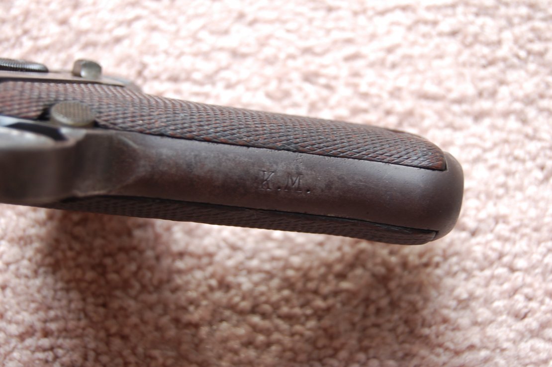

I have been trying to find info on a Dutch Luger. It was made by DWM, has no date on the barrel, three diget serial number, no sufix to the serial number, has safety (RUST) with the arrow pointing down, has a crown over an N, no grip safety. I am not sure how to post pictures with this post as I am new to the forum. There is also K.M. on the underside of the grip. Maybe the initials of a previous owner?
And help would be appreciated. I have looked at probably hundreds of pictures of Lugers and never found one with my configuration. Some come close but the RUST arrow points up not down, or they have a date on the barrel.

You have a 1928 contract Dutch Navy (I gather you suspected it was navy since you posted it in the Navy Lugers topic). The serial numbers of this contract were 1 to 1484, and it was the last DWM Dutch (actually it was manufactured by BKIW, Berlin Karlsruher Industrie Werk, as DWM was renamed after WWI). The next Dutch Navy Luger contract in 1930 was fulfilled by Mauser.
The safety arrow points down since, as you have indicated, it does not have a grip safety so it is in the Model 1914 Luger configuration, which also includes a stock lug. The earlier Dutch Army Lugers did not have a stock lug and had grip safeties so the thumb safety worked in the opposite direction.
A barrel date on a Dutch Luger indicates the date of the last overhaul/repair/modification. Since your gun lacks a barrel date, it has never been repaired or modified. The K.M. marking on the grip stands for, not surprisingly, “Koninklijke Marine” or Royal Navy.
You have what appears to be a very nice Dutch Luger, much better than average. I am sure that I am not the only one that would appreciate more pictures, particulaly showing the whole gun. Thank you for posting a very interesting item.

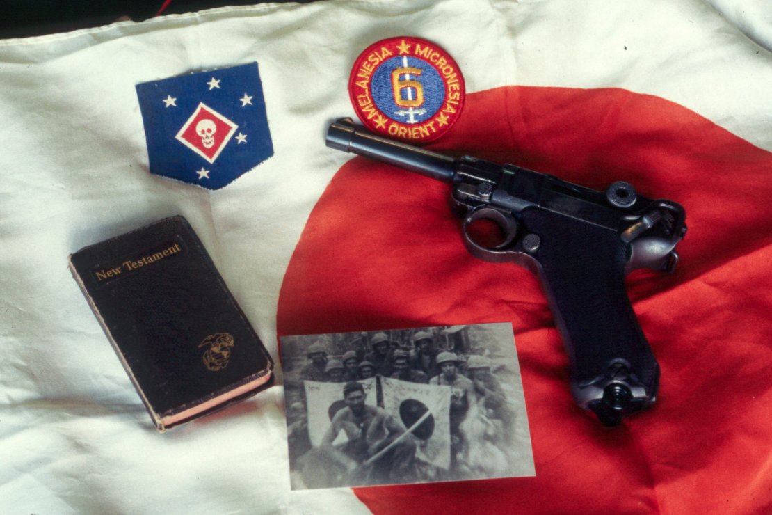

Here is another picture I took of my Luger on a captured Japanese Flag. Also in the picture is a picture of my Dads squad on Guam. Of the 10 men in the picture, 8 received the Purple Heart, one was later killed in action on Okinawa. He was awarded the Navy Cross. There also was one Silver star and one Bronze star awarded to two of the group. The man on the left in the back row in the picture found my Luger and gave it to my Dad (back row far right).

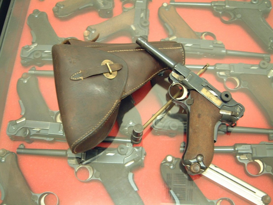

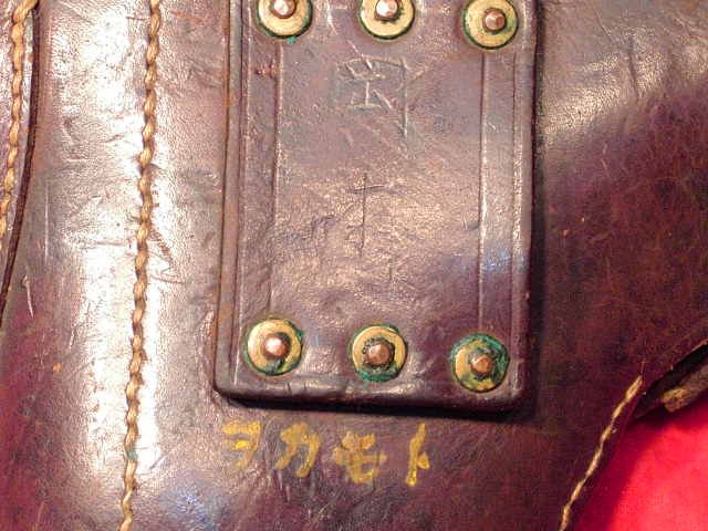

I particularly enjoy Dutch Lugers and have a few of them. The discussion about the Japanese capture and use of Dutch Lugers is a known bit of history. One of my favorite Dutch Lugers came in an original holster that had seen some time in the possession of a Japanese soldier. It is marked on the back with the previous owner's name, "Okamoto", written in both scribbled Kanji (岡本) and painted Katakana (ヲカモト).
