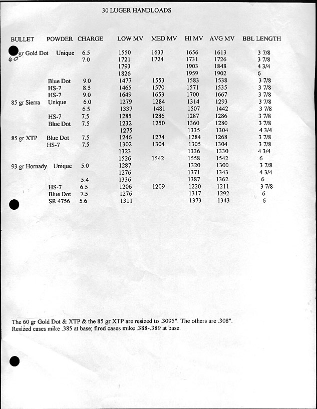

Numrich has Mauser Rifle front sight "blanks" that can be modified. The Mauser and Luger front sight slots are the same.
Older Luger bbls usually run .310-.311, the new reproduction bbls have .308 bores. 308 bullets will work in the old bbls as the bases will upset enough due to pressure to get a good seal. You can use 32 cal .312 bullets and swage them to .3095, I found that swaging in one stage very difficult, it was much easier to do it in two or three steps, .311, .310, 309 and final bullet dia ended up @ .3095. If you are casting, cast or resize them to .309 and they will work in both diameter bbls.
Here are some loads for the 30 Luger;

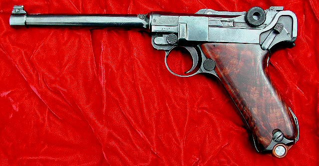

Hugh,
That's a beautiful piece of wood on that grip panel.
Thanks much. This project of reloading for the new (to me) caliber is looking easier and easier...for reasons some of you may be unaware. Lead bullet molds for .30 caliber are normally made to cast a bullet diameter of .309 to .310, with the expectation that they will be lubrisized to .308.
