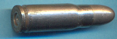

I got an email from the owner of the 8.15mm C96...It is definitely bottlenecked...Pic to follow...

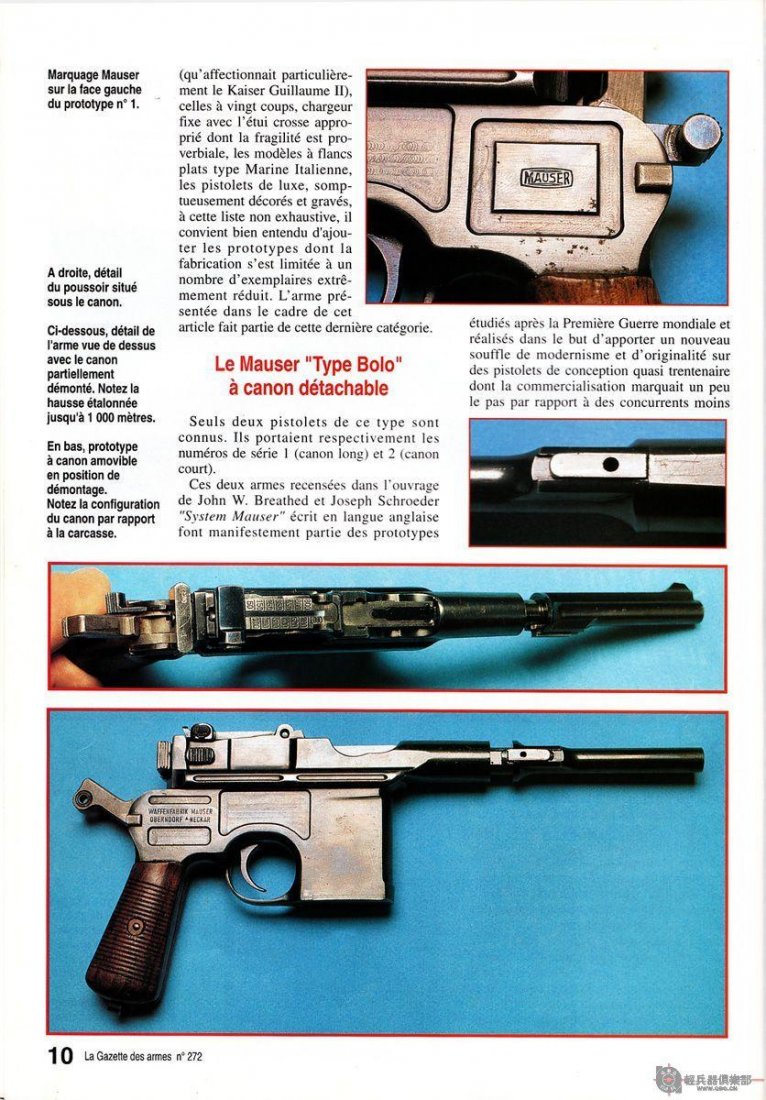

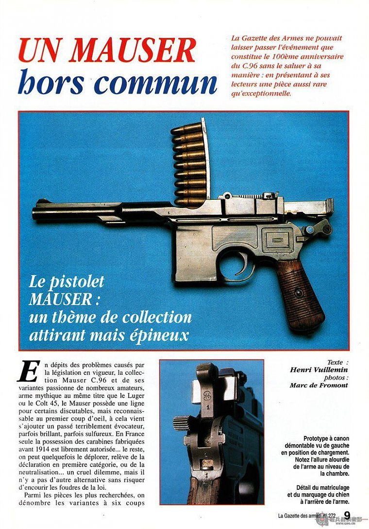

Would like to show one more postwar myth.
I saw this picture on the Internet. I would believe this one-of-a-kind being a real one.
Could this be a target pistolet made by Mauser for 1936 Berlin Olympics.... Mauser must prepare something for that game.... or, some other important sports activity.....

Very strange...
If intended for competition it would never have the standard sights. Mauser would have fit it with a fine tuned sight. Besides that what a NS marked hammer would be doing in a 30s Broomhandle?

I agree that it might not be a target gun. That's just a wild guess. Another pix
Just experimenting removable barrel did not have to make it so complex.

Unread 06-25-2009, 06:34 PM   #18
Posts: 8,195
Thanks: 1,414
Is it a "quick detachable" barrel??? (I don't read French)...Maybe a quarter-turn and pull it off???

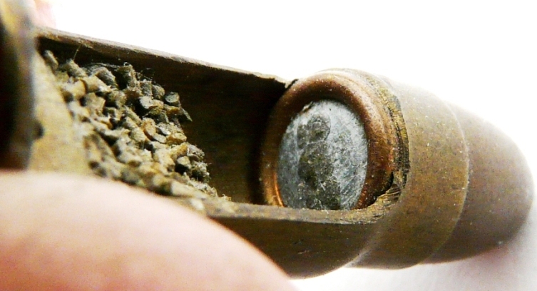

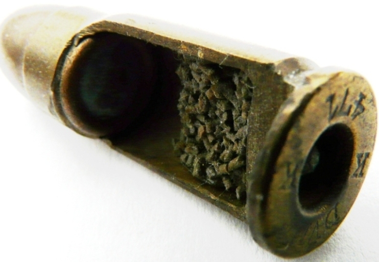

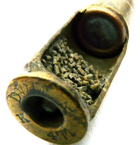

In the Brandt- Müller book Manual of Pistol and Revolver Cartridges Volume III is the cartridge described as made for a Mauser experimental model (C96) bearing the designation Model 1930. In its outer appearance it corresponds to the cartridge 7,63 Mauser and may easily be mistaken for it. The cartridge index of the firm DWM merely contains a note saying that his was an experimental round. The two bullets types DWM Nr. 501 and 502 can be distinguished only by their respective base (501 is hollow, 502 is flat and straight) and the different bullets weights from this fact.
Head stamp: K DWM K 580
I do not find the 7,63 Mauser dummy yet, but I found the .30 Luger which also show a number on the bullet.

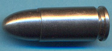

Unread 06-28-2009, 08:51 AM   #20
Klaus,
Nice detail photo of the 7,65 para / .30 luger cutaway round.
Here's a photo of the 7.63 Mauser 403 from DWM, turned into an exercise round. Shown for comparison is a 9x19 para exercise round.
