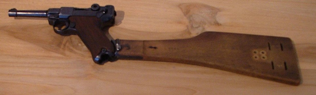

Here is an example of a short stocked P08, strictly for disabled shooters. And, for the US law makers, an illustration of a similar construction from the DWM archives.
If you could supply documentary proof of this archival information, BATF upon petition might exempt the P08 so equipped from regulation as a short barreled rifle.
