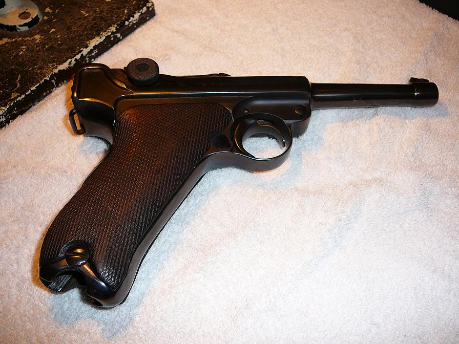

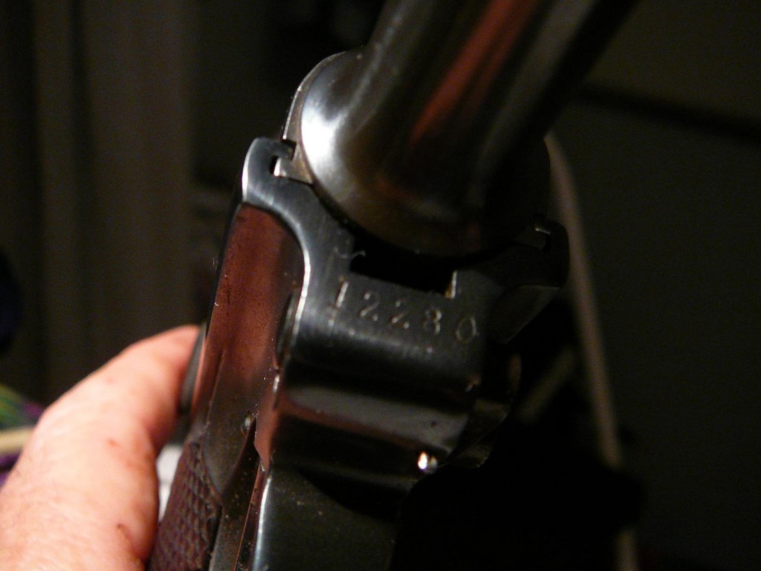

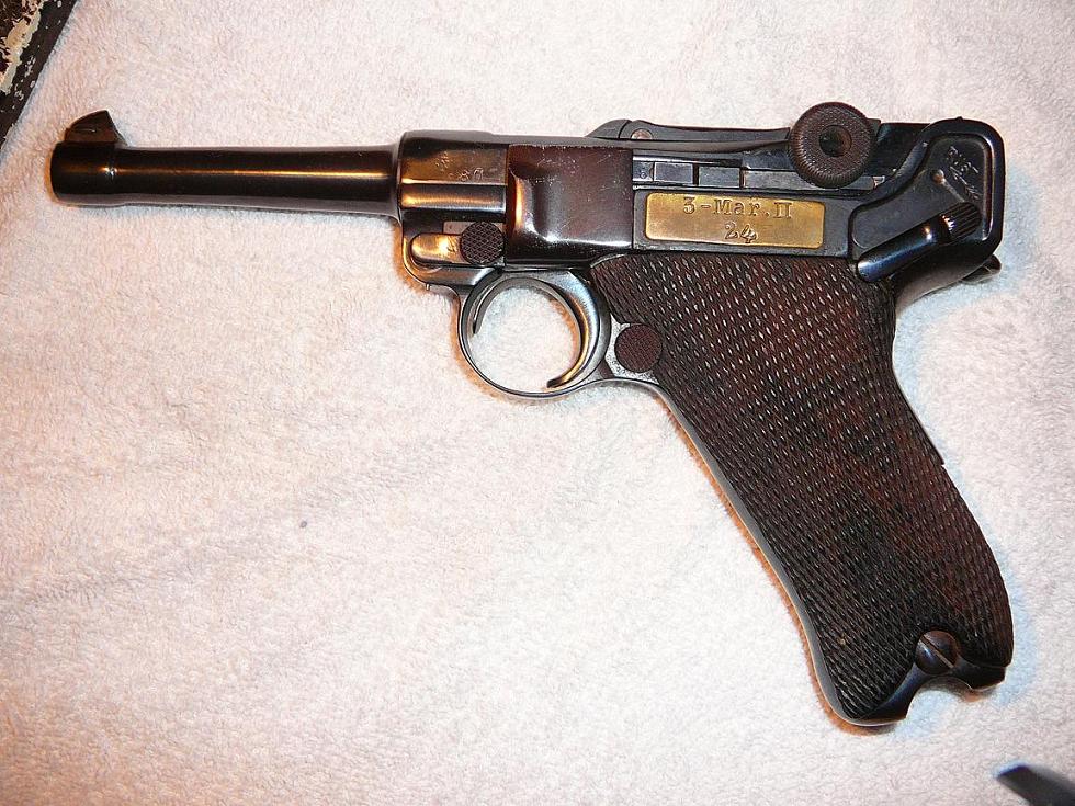

I was recently given this Lugar after my father in law passed away. He fought aganist the germans in the italian resistance. I am amazed by the knowledge of everone who answers all the questions. After looking around your site I have learned a few things. My lugar has a reciver proof for the Dutch air force contracts. I think it may have been re-blued as there is no strawing on the trigger. All the parts have the same last 2 numbers of the seiral no stamped on them,at least all the ones i can see with out pulling it apart which i am not game enough to do in case I can't get it back together. It is a 9mm. I would love any info that you guys can give me. Is the brass plate on the side original and if it is , is that the year of manufacture as i can't see it anywhere else. I would love to shoot it but don't know if that is a good idea or not. Thanks in advance for your info.

This is a Dutch Luger... more knowledgeable folks will be along to tell you more... Welcome to the Lugerforum.

A nice looking "for real" M11 Dutch Luger. Most Dutch Lugers were periodically refurbished, but I think your gun may have been refinished at a later date and not by the Dutch arsenal. Still, it is a scarce and desirable variation. Your father-in-law has passed on a small treasure. Congratulations.

You got good info here. It is indeed a Dutch contract luger, produced by DWM for use in the Dutch East Indies Colonies. The 'airforce' has nothing to do with this, it is an old mistake that made it into several reference books. The KOL logo on the receiver is the property mark of the Dutch Departement of Colonies. The pistol was produced in 1928 and the brass tag was added by the Dutch KNIL (East Indies army). 24 is the gun inventory number, not the production year. The brass tag suggests that the pistol was in use with the military police.
The blueing has been done at a later date and is not Dutch. Nice gun, although the new reblue did hurt it's collecting value.

Thanks guys for such qucik and informative replies, it is great to learn more about this pistol. Maybe you guys can guide me on whether i should shoot it or if it has any value as a collectors piece. Also Vlim, can you tell me what it would have looked like if it had been re-blued by the Dutch armoury. Any one want to suggest what $$ it would be worth aprox.Thanks.

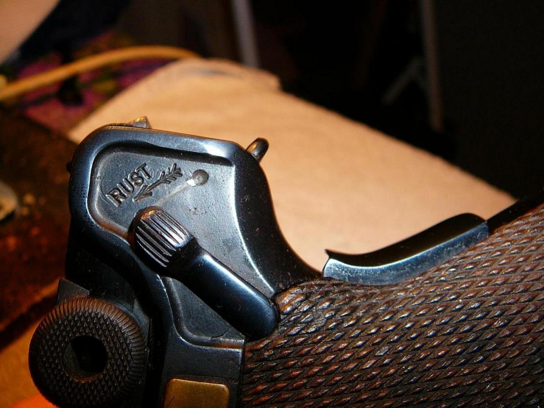

Your pistol has been reblued using the salt dip method, this produces a more glossy, black finish. The Dutch used the old rust blue method, producing a somewhat more dull looking deeper blue. The grips on the scan below are reproductions, used for handling the gun.

One of the questions you have asked is whether this pistol should be shot? You mentioned that as far as you can tell all the serial numbers match. If this is the case, then you may want to consider not firing it since if you break even one of these serially numbered parts, you will dramatically decrease the value. For example, if the extractor were to break (which is one of the more common things to break) your pistol will be worth about half what it was before that part got broken.
In this case, since the rebluing was not done by the Dutch, the collector value has already been hurt somewhat. So in my opinion, why risk a furthur reduction in the value by firing it and breaking a serially numbered part?
I hope someone who knows more about this particular variation will give you an estimate on the value; however, I think it is reasonable to assume that it is worth quite a bit more than most Lugers since this is a seldom encountered variation.

I would even go so far as to consider stripping it of the salt dip blue and getting it reblued using the rust blue method....(by someone who knows what he's doing)
Then the trigger, takedown lever and safety catch can be returned to their original straw color as well.
The sear bar has been modified in a perculiar way, btw. Probably a P08-style sear that was modified to work with the 1906-style safety catch.
Unread 04-02-2009, 11:12 AM   #10
Even reblued, i think it is worth $900-$1000 (normal reblued luger is worth around $600-$700).

Thanks so much for all the knowledge you guys have shared with me. I was wondering how hard these lugars are to pull apart and get back together, is there somewhere that gives step by step instructions so i do this in the right order. I don't want to stuff it up.
Vlim, as for the sear bar in your previous comment, i don't know if my father in law did this modification but he always did something to every gun he owned so if it was wrestled off him it couldn't be used on him! He was funny with things like that.

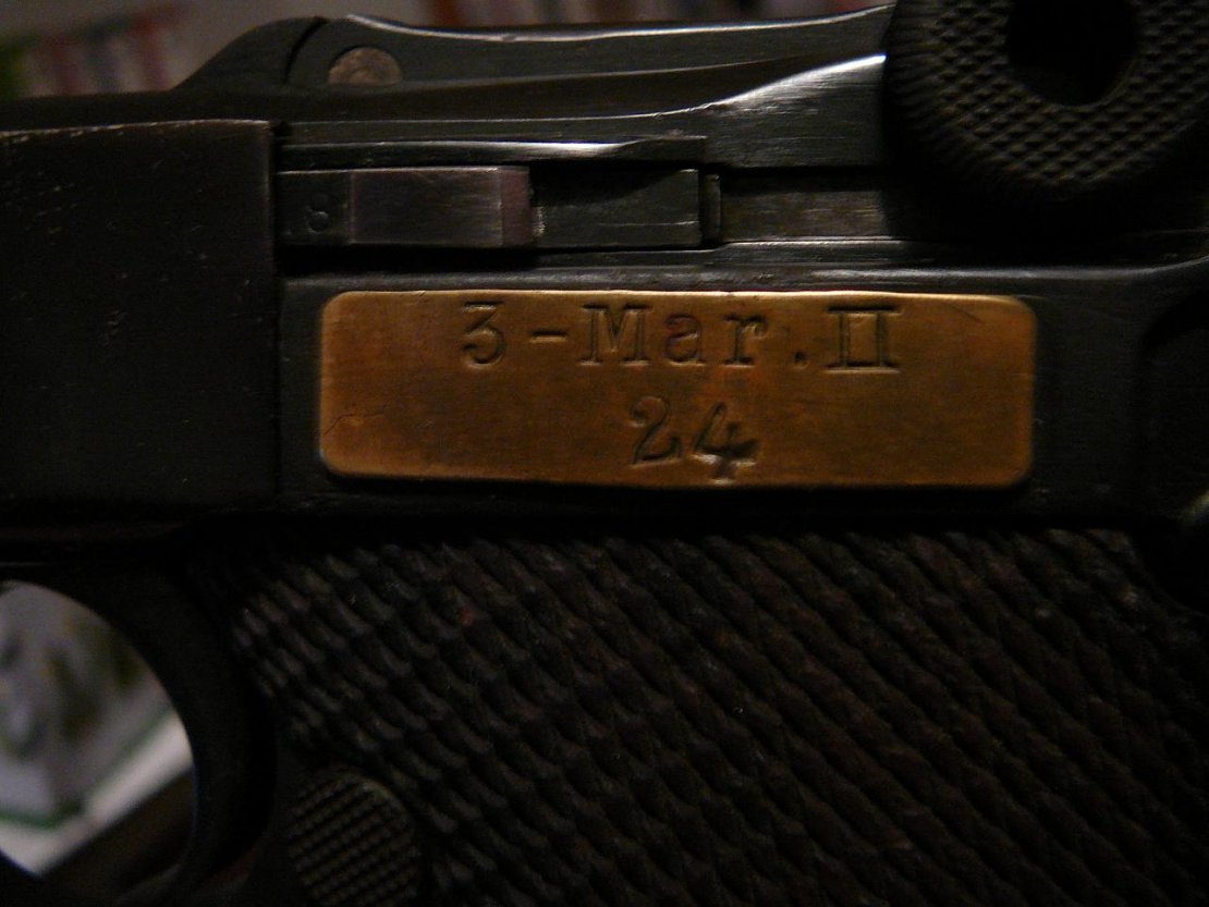

Also do you know (or know where to find) what the other letters on the brass plate represent? Thanks

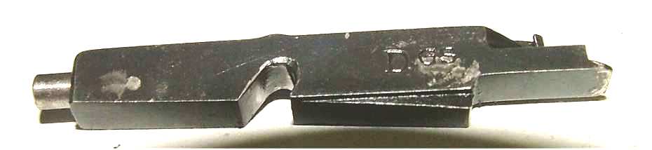

If you do a partial disassembly, check the parts for the presence of a GS marking. Many parts that were made locally in Indonesia by the Dutch army maintenance crew were marked with this 'GS' (for GeweermakersSchool) marking. Since the grip on the right is coarser than the one on the left, I suspect it will have a GS marking on the inside.
Attached is a photo of the sear bar on my Dutch KNIL luger with the D GS inscription.
