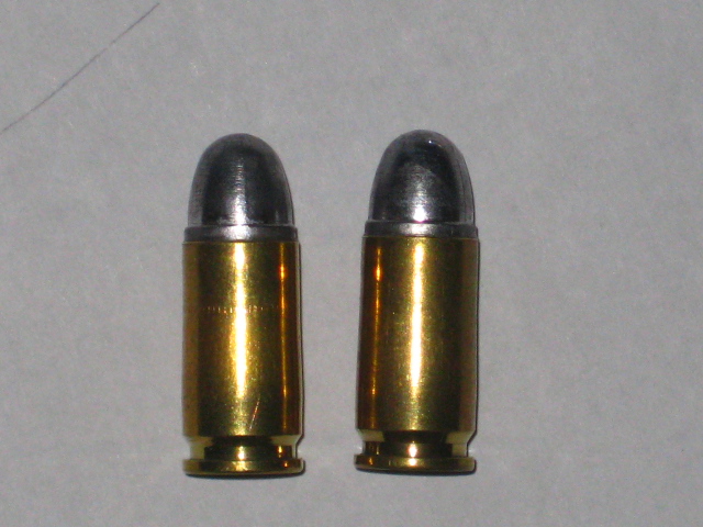

I was able to get to the local range on Wednesday and tried some hand loads with my vintage pistols. I cast my own lead bullets and am using a Lyman 9mm round nose 120gr mould. I just took my reloading equipment out of storage and had about 2500 small pistol primers and a pound of Unique not my favorite choice of powder but I'm having had trouble finding reloading components. I checked my email today and Midway USA has finally shipped my order for 8 pounds of Bullseye from three weeks ago, now I will have to make a new load for Bullseye.
I'm using 4gr of Unique (Unique does not not throw every consistently + or - .4gr) under a 120gr lead cast bullet with an overall length of 1.09. I've noticed some here on the forum are using an C.O.L. of 1.14 and 1.15 which I was concerned at first but if I go any further the first band of lube would be exposed.
Any way the load seems to work in my Luger I was able to shoot five fully loaded mags with only two failure to feed which I think is the mag (it's dented and old) I will find out when I get some Mec-gar mags. For the rest of the day I only used 6 in the mag and had no troubles for the rest of the day. My Astra 600 seems to like everything I feed it, I haven't had any malfunctions with it, my P.38 does not like the load, a lot of stove pipes I'm going to try 4.5gr and see if that works. All of the pistols have new standard Wolf recoil springs installed in them.

For a round nose bullet, your OAL should be way out there at 1.169 to 1.173. At this length, you will be able to shoot a full 8 rounds without jams (if your magazine is in some kind of shape). Who cares if your top groove is exposed, as long as you don't drop the rounds in the dirt, it won't make a hill of beans of difference.
Now as to your load, for Unique, your load sound a bit low. If your bullets really weigh 124 grains, I'd work up from about 4.5 to 5.2, or so, looking for accuracy and perfect function..
Forget about throwing a powder like this and go get a scale. I know it takes longer, but you will be rewarded by fine accuracy in a Luger.
For your Bullseye load, try from 3.6 to 3.8 grains. My accuracy load with this powder is 3.7 grains with the 124 grain bullet.

Ok second attempt, I pushed the OAL out to 1.15 with 3.6gr of bullseye, I put two full mags through my byf with no problem, but I'm not shooting that any more now that I have a shooter.
I put 50 rounds though my Erfurt shooter and had no problems with feeding but I did have some problems with the breach block not going fully in to battery. When I would push the toggle closed I wouldn't be able to open it, I think the bullet is sticking to far into the bore. I'm going to back the OAL to 1.14 and see how that works.
Also my P.38 didn't fulling eject some casings so I'm going to up the change to 3.7gr of bullseye. Thanks for the pointers Sieger, I will get this work out soon.
