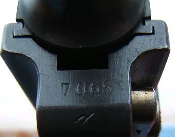

I just purchased an Erfurt Luger 9mm with chamber date of 1918. It is a mismatched gun. The entire upper is one serial number all matching(866), and the lower and side plate is all matching, serial number 7068 with a script d, so 7068d. (see pic which I hope attatched sucsessfully).
Here is my question:
It has been suggested by someone, who thinks they know things, that it possible that this is a DWM .30 cal lower? I have not seen anything on the site regarding the interchangeability(is that a word?) between the 9 and .30 cal?
I trust you all more than 'him'. Is it possible that this is a
DWM .30 lower 1/2?
I thought I saw a serial number chart here somewhere but can't seem to find it.
I only have this one pic as I am at work but was planning on a better first post than this.

If it is an erfurt bottom, then it would be Erfurt accepted (some folks call them proofs); no erfurt proofs, not an erfurt...

If your frame is a DWM, it's impossible to tell with caliber it was originally except by the recoil spring: an original DWM 7.65mm recoil spring with have 17 turns and a WW1 era 9mm with have 19 turns. TH
