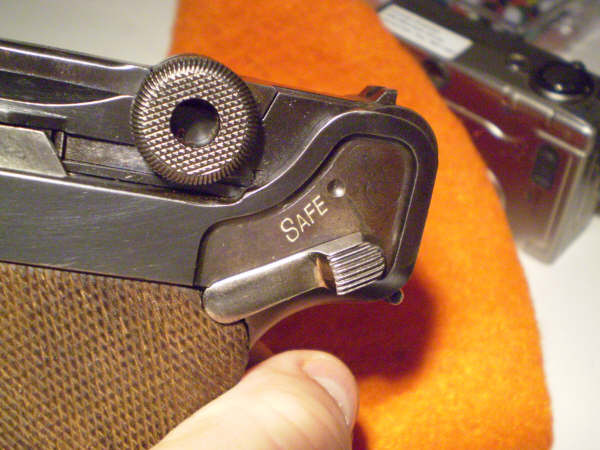

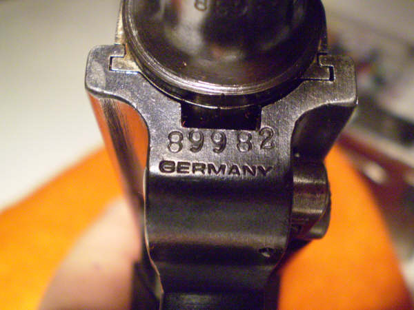

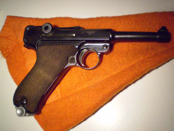

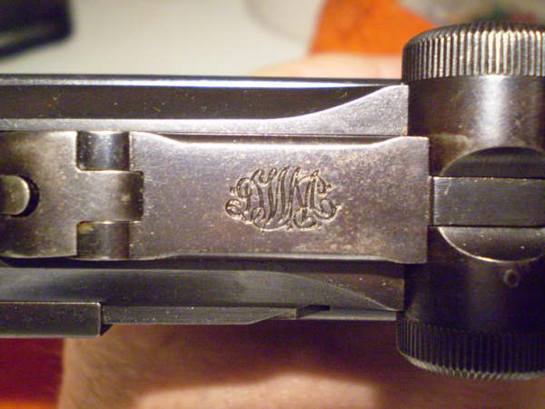

I was given a Luger recently and it was identified to me as a 1914 Commercial. However after reading several posts here, I do not believe it to be that. The serial number seems to fall into the range for the 1923 Commercial Luger. Can someone give me some pointers on this. A couple of different things regarding this Luger. It has SAFE printed on it rather than the German equivalent. I have attached some pictures. I hope this helps.

You are correct, it is a 1923 commercial according to (Kenyon- LAR). The more recent classification would be 20 DWM (Still- Weimar Lugers). It was part of the Stoeger contract, made for the American market in early 1921. It is classified as a Safe and Loaded. If you pull up the extractor it should have LOADED stamped on it. Does the mag bottom have anything stamped on it?

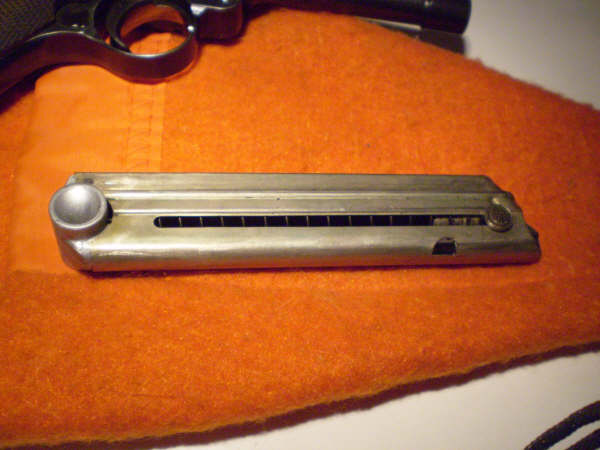

No, when the Safety is up, there is nothing written underneath. Also, I don't think that the magazine I have is the correct one for the gun. It is an all aluminum magazine. (pictured below)

One would need to field strip the weapon and really look it over before giving you a value. It could be $1000 or $1600 depending on finish, matching numbers ,bore. etc. From the pictures it looks nice. If it was me and a family item it would remain in the family. Bill

If you lift up the (extractor) not the safety, it should have LOADED stamped on it. The reason I asked about your mag is that some Stoeger marked Lugers came with aluminum bottom mags that were stamped MADE IN GERMANY or just GERMANY. Your Luger originally had a wood bottom mag, but I thought that it might have a spare mag that was ordered for it years later. If numbers were not removed from the bottom of your mag it is a commercial mag (made in the 30's).

Stoeger had a contract for 'safe, loaded' marked Lugers. I'm not sure about the other importers like Pacific Arms. I think unmarked aluminum bottom mags were supplied with commercial Banners... same as the earlier commercial unmarked wood bottom mags. I've also seen a GERMANY stamped aluminum bottom mag with a 2 line Stoeger. I believe that the method of stamping or (not stamping) commercial mags didn't change.

MFC, IMHO the Germany marked wood & aluminum bottomed mags that we see, were ones that were imported separately from the guns, so they were required to be marked with the country of origin. If a mag came into the USA with a Germany marked pistol, it was not required to be marked. TH
