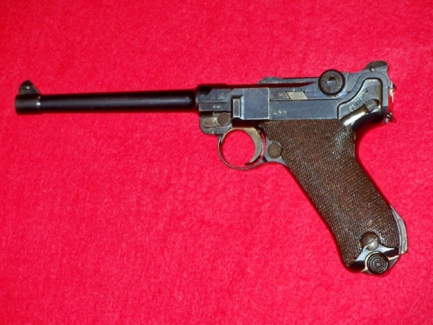

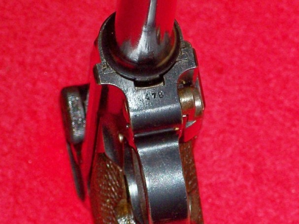

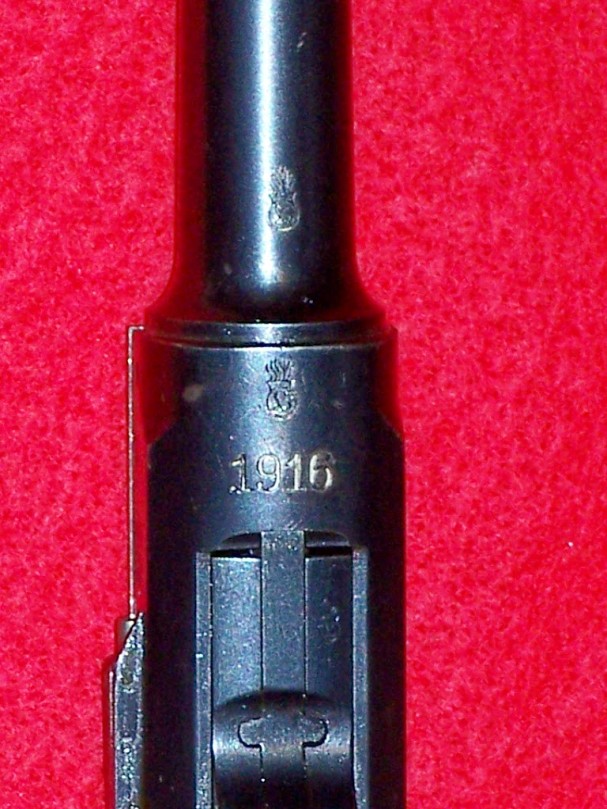

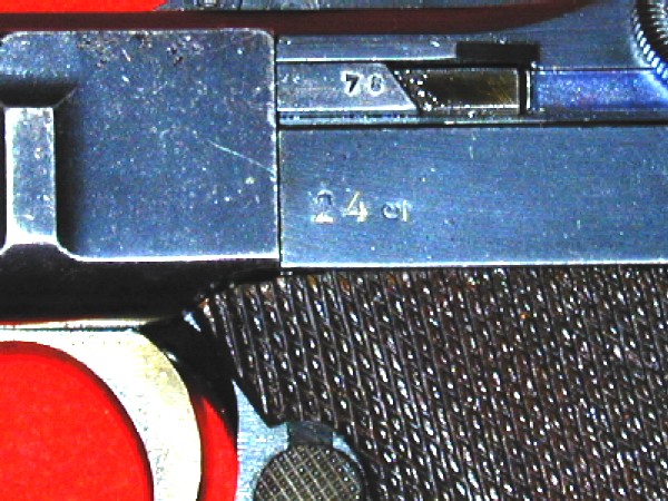

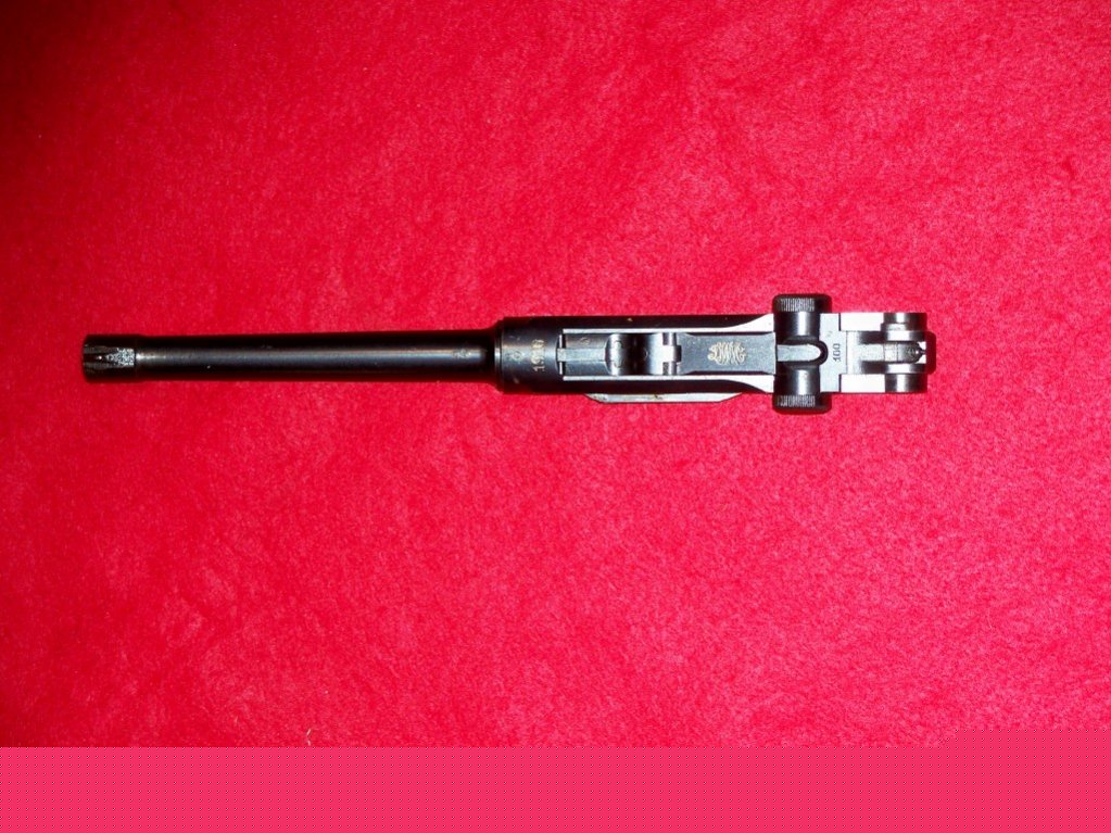

All.... Can anyone come up with a plausible reason for this 1916 navy to have belgium proofs ? There are two larger proofs on the barrel and chamber, and smaller proofs on the toggle parts. Upon close examination with a loup, they appear to be under the blue, not applied after blueing, as there is no halo around them, as is the sear bar. There is the number 24 and what looks like an underlined letter c behind 24. The serial number is 478. Come on you navy guys.....

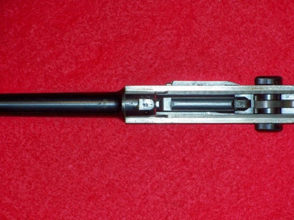

Here is a closeup of the chamber and barrel proofs. There is no halo around them.

Mike,
Belgium, like England, has a requirement for any firearm sold in country to undergo the national proof. It would have been proofed considerably after the gun was manufactured, so the lack of halo indicates that it has been refinished. I don't know what the 24 means but the odd mark next to it is a Belgian inspector's mark.
Unread 01-22-2009, 09:02 PM   #4
myky
Join Date: Sep 2007
Location: Texas Hill Country
Posts: 178
Thanked 22 Times in 9 Posts
Default 1916 navy with belgian proofs
Ron.. thanks bud ! Every little bit of info helps. If it has been refinished, I think it had to be done during that period as there is no tell tale indicators that it has been....... that, I have been able to tell in the 50 years that I've been into Lugers...... Have you ever seen another Luger with them in all your years ? Or, any other arms other than Belgian made ones, with these stamps ? Thanks again !!!
myky
myky is offline   Reply With Quote
Unread 01-22-2009, 10:22 PM   #5
G.T.
Location: Chandler Arizona
Posts: 3,541
Thanks: 1,342
Default navy...
WOW, that is just a really, really nice navy!!! I think the different proofs just add to the flavor... nice gun, til...lat'r....GT
Unread 01-23-2009, 07:48 AM   #6
myky,
The proof marks on your gun are indeed Belgian and used for foreign guns that enter the Belgian market. So they are normally only found on non-belgian guns. Have seen many examples, including 1911's, .30-M1 Carbines, lugers, etc..
There is an international agreement amongst countries that recognize each other's proof marks, so when a gun proofed in country 1, it will not need reproofing in country 2 (the CIP). Belgium ratified the agreement in 1925 and Germany in 1927. Logic dictates that after 1927 Belgium no longer had to reproof German guns that already had valid German proof marks.
So that would place the proof mark of your Navy between 1918 and 1927.

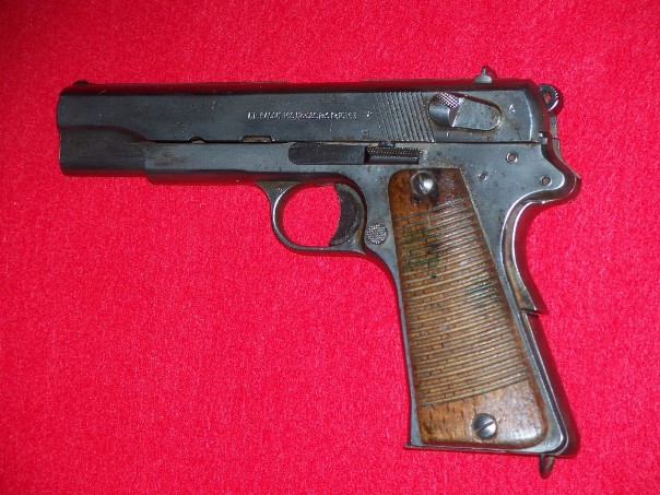

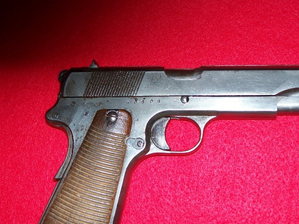

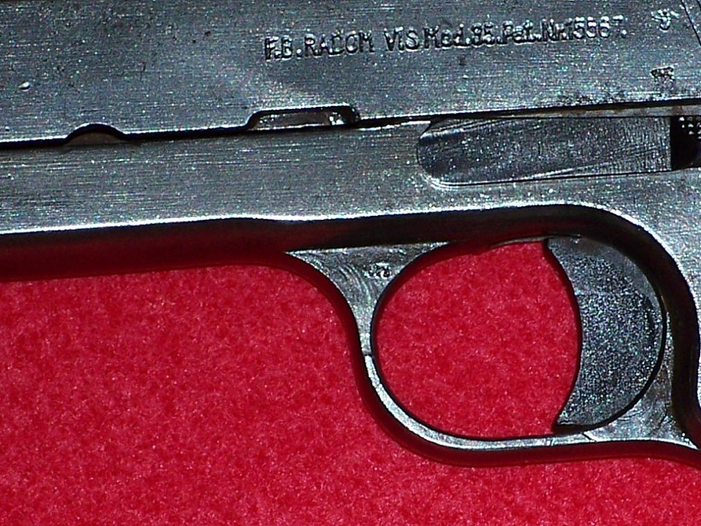

Guys..... thanks for your valuable input. This is what I needed. I knew I could count on the forum !! This weekend I purchased a Radom, type 3, with the serial number that has serial number that's over 1000 than the Blue Book lists. # K 3608. I will post it in the correct section tomorrow. It is on my web site www.relicsofthereichs.com if ya'll want to see it before I get it posted on the Forum. Myky
myky
Unread 01-26-2009, 10:50 PM   #9
myky
Join Date: Sep 2007
Posts: 178
Default Radom, type 3, 2 lever, K 3608
I went ahead, since I'm already here......
