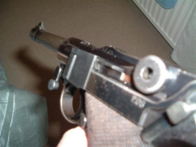

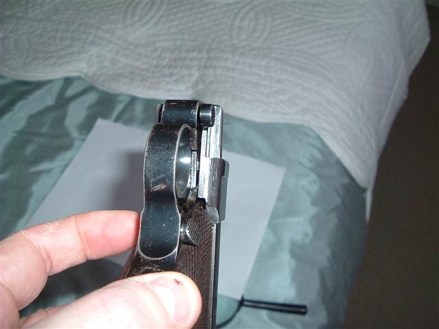

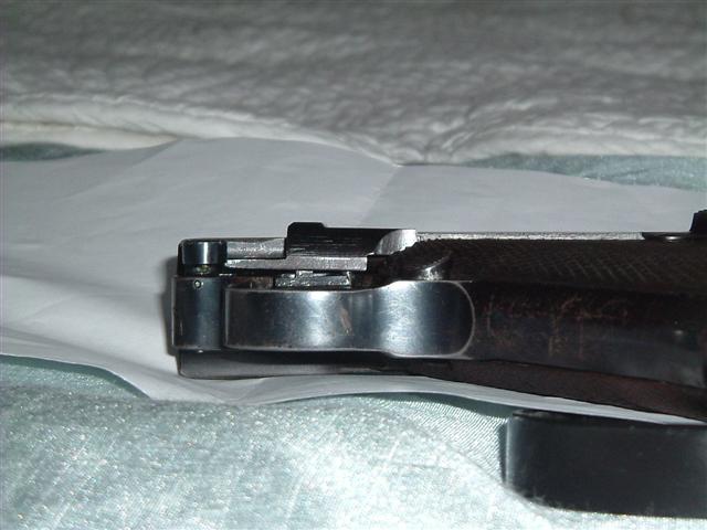

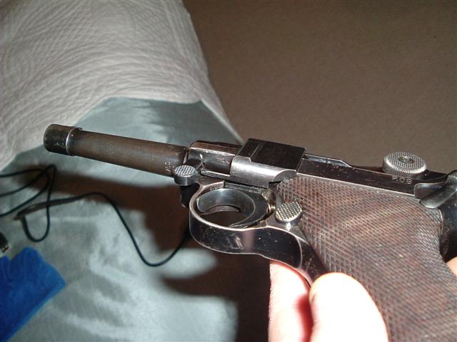

tried all sorts of ways but this sideplate wont allow the take down lever to lock onto it -even with just the frame , see what you experts think

is the trigger in place?
Unread 01-09-2009, 10:43 AM   #3
The "arm" of the side plate appears to be bent up a bit. But the most common reason for the TD lever not wanting to close fully, is that the rear edge of the side plate is not fully seated into the frame. How about a side view, showing the rear of side plate to frame connection. Lugerdoc

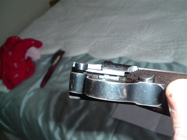

hi police luger and lugerdoc, its exactly the same with trigger assy removed , the rear lip fits in snugly where it meets the grip and also at the frame rail its just at the takedown lever , could the trigger lever be the culprit as it stands proud of the sideplate casing by a bit [2-3 mm], its my only sideplate

This appears to be a replacement sideplate and possibly even a reproduction sideplate and will require more fitting. Either the sideplate tab is too thick to go under the takedown lever (will have to be thinned down) or the takedown lever is bent toward the frame and won't allow the sideplate lever to go under it... (you can bend it SLIGHTLY up...to try and allow the lever to fit over the sideplate tab.)
The sideplate tab should be a tight but slide fit under the locking takedown lever.
Unread 01-09-2009, 01:46 PM   #6
Is it possible that the lower arm of the transfer lever is too long? It is hard to tell from the photos provided, but if the top left corner of the side plate is very square and not rounded over it is an early model (1900) side plate. The lower arm of an early model transfer lever is much shorter than a new model. So if you have a new model transfer lever in an old model side plate it might produce what you are seeing.

Find out what is pushing the side plate upwards by eliminating various parts that interfere with plate each time you mate plate with the frame. Once you locate culprit find exact spot and figure out why. I would start first with bare frame with nothing attached to it. Than keep adding parts. If it doesn’t fit right on the frame than you know your answer right away. It is the plate itself. You get idea?
Can you show us a picture of the inside the plate?
