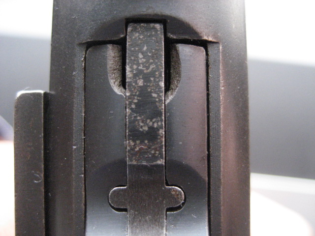

Maybe a fluted firing pin would have prevented this damage.

According to "tenbears" pic. it looks like it would be clever to replace the firing pin in my Luger with a fluted one.

The fluted firing pin was patented by Georg Luger in 1893, explicitly to keep a firing striker clear of grease and oil residue. The feature was added to P08 production by 1934. If you examine a Luger with one of these strikers which is in use as a shooting pistol, you will see how well it functions as a trap for grease and residue. This, along with the absence of any exhaust channel within the breechblock itself, mitigates against its purpose as a vent for overpressure. The small hole drilled in the bottom of many Finnish breechblocks, uncovered when the striker is pressed to the rear, would function very well as a pressure release.
I have examined damage such as that pictured by tenbears, above. In the examples I have seen, the fractures do not extend through to the relieved breechblock face, suggesting that escaping breech pressure is not the culprit. As a WAG, I wonder if it might rather be a result of impact fracture of the breechblock against the barrel/receiver face?
It could be that this bolt damage was the result of the weapon fireing out of battery, split the unsupported cartridge and the high pressure escaped upwards taking a portion of the bolt face with it?

Frankly, as a practical matter, I would suspect that the pressure of an out-of-battery, split case would blow out the extractor rather than fracture the bolt face.
Unread 12-25-2008, 08:08 PM   #18
Dwight..Yes of course. I was just thinking the bolt has an overlaping edge and one possibility is pressure grabbing it on the way out and with the channel for the extractor...It might be possible to account for the damage shown. On a practical side though, the extractor is pretty vulnarable there...
