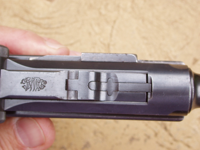

I purchased a luger recently and would be grateful for any comments on the date of manufacture and history. I have included on the attachments all the markings I can see. Thanks

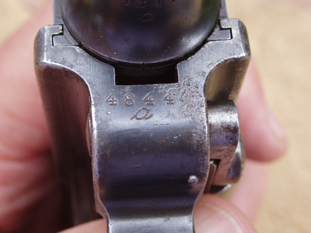

This is the serial number.

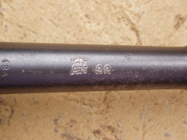

This marking is on the side of the chamber,the barrel and the handle.

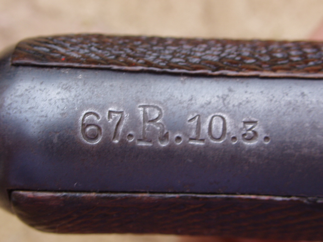

This marking is on the inside of the handle

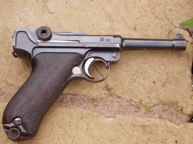

general view

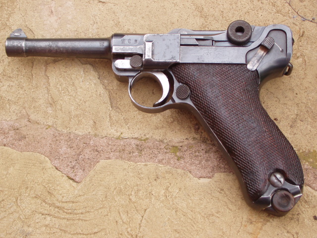

other general view
(Apologise for sending attachments piecemeal but could not make sense of your advice on site for sending photos.)

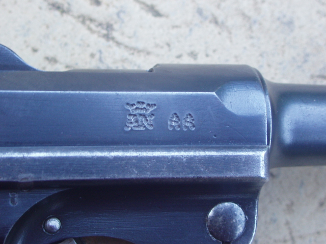

You have a Model 1908 Military (Army) First Issue. The marking on the "handle" (grip) indicates that it was issued to the 67th Regiment, 10th Company, weapon number 3. Other markings have been added that are very odd. Could you please post a clear close up photo of the markings on the right side of the chamber (receiver). You do not need to start another thread to respond to this request, just use the "ADD REPLY" button rather than the "Quick Reply" box and you will have the controls to include a photo. Thank you.

East-Germany had nothing to do with this one.
Has the gun been deactivated in the UK?

The certificate is from France, Banc d'epreuve de St etienne, dated11/6/08, Ivan

Ron, many thanks for your very interesting comments. I attach photo as reqested.
Asregards the regiment 67 have you any idea how I could find out more details on this. Best Regards, Ivan

If the gun was deactivated in France, this would explain why the original French proof marks on receiver and barrel were peened out. So this gun would have found it's way onto the French market somewhere after WW1.

Crowned AN marking means "Arme Neutralis�©e" in french (deactived gun) and ivanlaud is right, it's the official mark of the Banc d'Epreuve de Saint Etienne.
