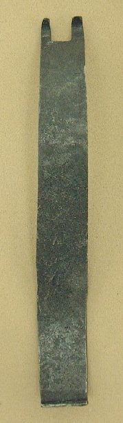

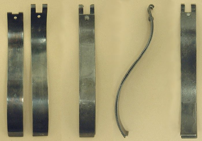

Here are some views of the flat laminated spring found in the early 1900 and 1902 Lugers.
The mainspring consists of two laminations that are riveted together. The longer leaf includes the hook that engages the S-shaped transfer link connected to the toggle.
The laminated mainspring is difficult to find, so occasionally you will encounter a gunsmith replacement that was made to restore a Luger to operational condition without regard to "cosmetics". The following example came from a 1900 Luger that made its way from Old Mexico across the border into Texas. It is hand forged and has the same aesthetics as homemade soap, but it works! The ingenuity and resorcefulness of craftsmen is always a source of wonder.

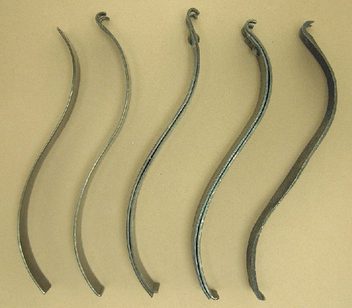

As noted by Levallois, the shape of the mainspring varies and what may function in one Luger may not be "tuned" to another. The next photo shows the different curvatures from left to right of the individual leaves, two original examples, and the hand forged example.

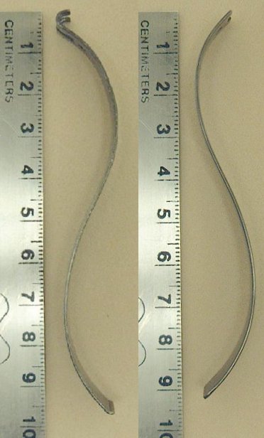

The actual dimensions of the components of the mainspring can only be estimated from a photo. The true dimensions would have to be determined by having the parts in hand. In addition to the dimensions, the tensile strength of the springs would have to be measured. The following illlustration shows the relative dimensions of the components, but I would guess that it falls far short of that necessary to make a reproduction.
Unread 05-15-2008, 11:53 AM   #2
Thanks Ron for a great photo essay on the early mainspring. From your photos it seems that the size of the "foot" on the longer spring also varies... does this foot play a role in keeping the lower end of the spring in place during operation? I imagine it does, and if I am correct, approximately what length would you consider optimum?
On my screen, it appears that the photo is approximately 1.5 to 1.6 times larger than life. Measuring the original spring's "pull" would seem to be a challenge...
Once last question. Appoximately what thickness of spring steel are we dealing with here? are both leaves the same material or is one thicker than the other?
Unread 05-15-2008, 05:59 PM   #3
John, You make an exc point: a couple of the springs shown in profile in one of Ron's photos, appear to be missing the "foot", which is essential to holding the spring into the frame. Without this bend at the bottom, the spring will lift and not allow the toggle to come back all the way. TH

All the springs shown have a foot on the longer leaf, albeit it is a bit smaller on the disassembled mainspring. Both leaves are the same thickness on a 7.65mm spring. For the 1902 9mm spring, the long leaf is approximately 50% thicker than the 7.65mm spring but the short leaf is the same thickness for both calibers.
I will measure the thickness of the spring steel and get back to you.

I have owned 2 broken springs (one was in a gun and the other I picked up as parts, I didn't break them!). The hooks were both good. They were snapped about 1/3-1/2 way down from the hook. One had the main spring (with the hook) broken and one the auxillary spring. I salvaged the good main and good aux spring and riveted them together...worked great.
I bought the disassembled spring in the photo that had been fastened together with a lousy makeshift rivet. The rivet had not been properly peened so the whole assembly was floppy. I will get around to putting a new rivet in it someday.
