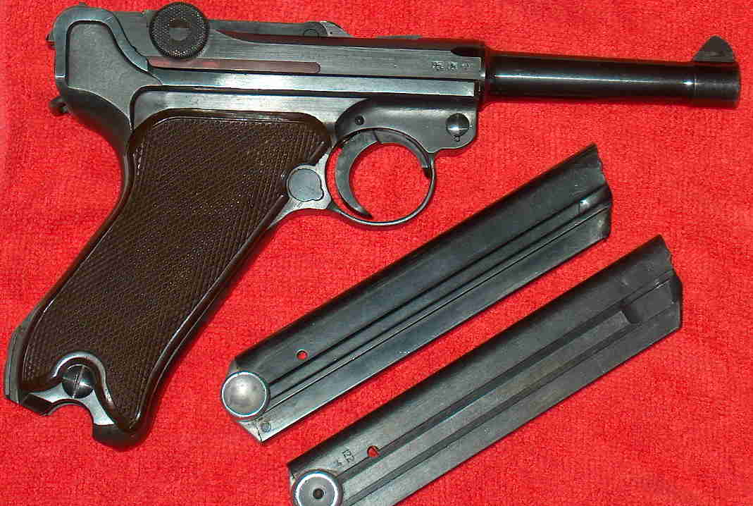

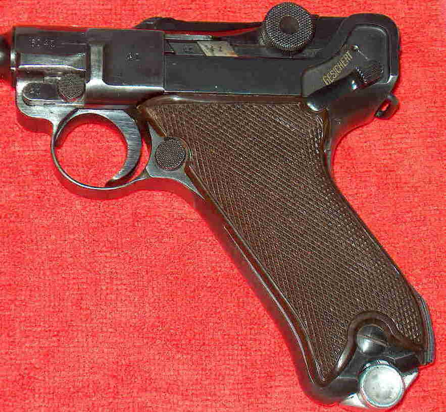

Hello I am new to the board and would like to have some help with what type of Luger I have. I have gotten differing opinions on what it is. I have been told it was reblued. So, any help would be a great help to me.

From your slightly blurry pics it doesn't really have obvious evidence of rebluing to me.
But I could be wrong.
Appears to be a nice 1940 Mauser, with possibly Krieghoff brown plastic grips.
Can you get more clear and more close up pics of it for us?

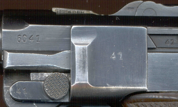

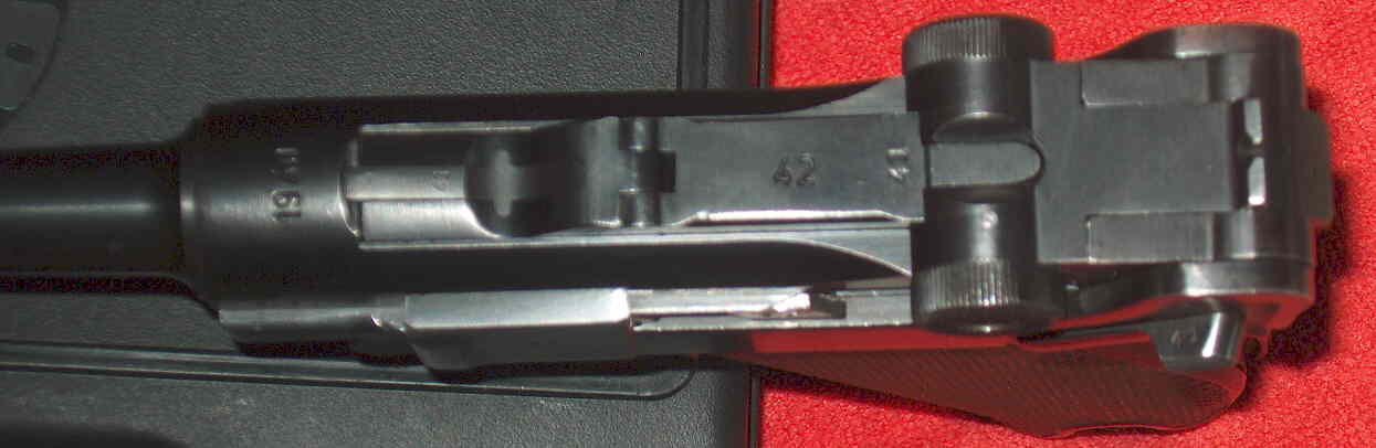

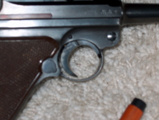

I hope these pictures are better. I am not very good with a camera.
Thanks again

Hi David,
I'm not really a Third Reich Luger guy, but I'm with Anna on this one. It looks good to me too.
You have a Luger made by Mauser (42 code) in 1940. With one early type II magazine and a later 122 fxo coded extruded magazine.
If the grips are Keighoff ? They hold considerable value on their own. The blue looks original.
Unread 03-30-2008, 07:33 PM   #6
Looks so far so good. Edges are sharp. The general feeling is good. As mentioned by Ron, grip panels are not Mauser. No reference at hand, 42 code probably has wooden grips.

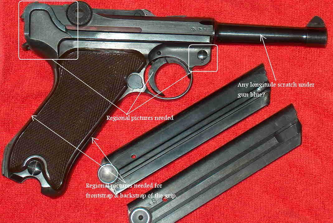

Assume this senario: I'm the seller of this gun on G-B, you sit on potential bidder's position.... then you may want to request the following:

Looks good from the pictures, as mention it might have been reblued. If so, it looks nicely done.
The frame is from Mauser (with the hump), therefore some fitting must have been done to the Krieghoff grips to make them fit. If original, that may have lowered their value some.
Alvin; out of curriosity, what would the right side of the takedown lever show?

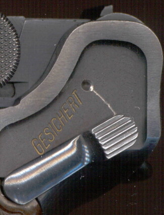

On the picture, the front edge of the frame in that area looks a little bit blurred. Just curious it's sharp or not. Probably a picture problem.

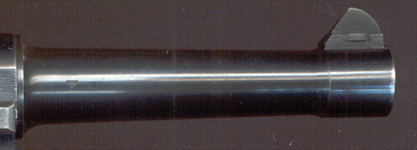

A picture of muzzle would also help.
You know, some dealers may reblue 90% gun these days..... very hard to tell, because the base is not bad. The driving force is profit, is money. The last 3% is more than half of the price.

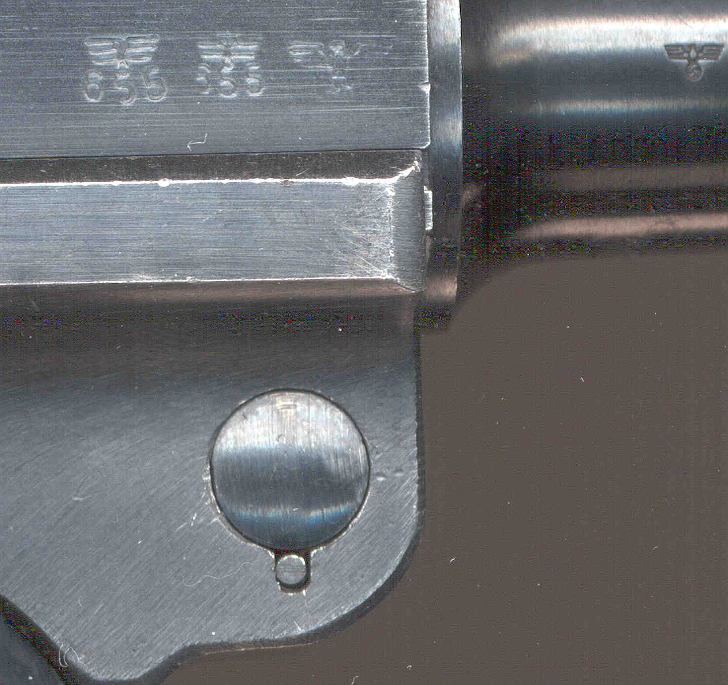

Hello Alvin
Thanks for your help.
I have tried to give you the views of the Luger you wanted. My digital camera has died so I had to use a scanner. I hope these help you.
Thanks to all for the help.
David
hantsbad is offline   Reply With Quote
Unread 03-31-2008, 08:02 PM   #10
David -- Thanks for the pictures. Originally, I thought the ears looking weird. By comparing with a few other 42 code guns, it's OK.... 42 code Mauser should have this type of ear pattern. I would say the metal & finish looks original to me.

I don't believe your pistol has been reblued...You will notice the yellowish coloration in the safety area, Gesichert. That is original and the rest of the pistols small parts exhibit the proper fire or plum bluing one would expect. The serials and proofs are crisp as are the edges. This pistol sports it's original finish.

42 Code 1940 Mausers with the krieghoff grips are a valid variation.
