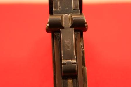

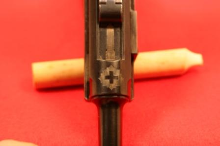

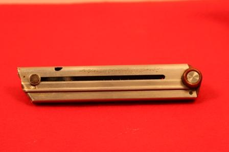

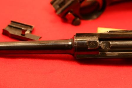

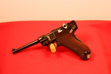

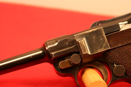

Gentlemen,
This is a test to see if I have this process right. Here is the first photo I have managfed of this Luger. Markings are mininal. I mostly see the number 26 and several Swiss crosses on various parts. I will try to post further.

Unread 03-11-2008, 10:37 PM   #13
Sorry for the "Single fire" method of posting photos. I still don't get how to place multiple URLs in a single post
Doug

Unread 03-12-2008, 12:48 AM   #17
Doug,
I have moderator capablilty for this forum, so I have edited your posts to change the [url] tags to [IMG] to allow the images to show up in your message. I am visting with my daughter, so I do not have a high definition graphcs monitor or photo editing software to enhance your images to see the detail, but I can tell you that from what I can see your friend has a very early production military issue Swiss and the frame has been modified/relieved to accept the later raised button magazine. Can"t tell much more than that from the photos, but it is a very early and desirable variation. Thanks for the photos.

Unread 03-12-2008, 05:43 AM   #19
It is also curious that the side plate shows an unusual amount of wear versus the balance of the gun. In my exitement, I had initially said 95% +, but I would round this down a bit based on the photos.
