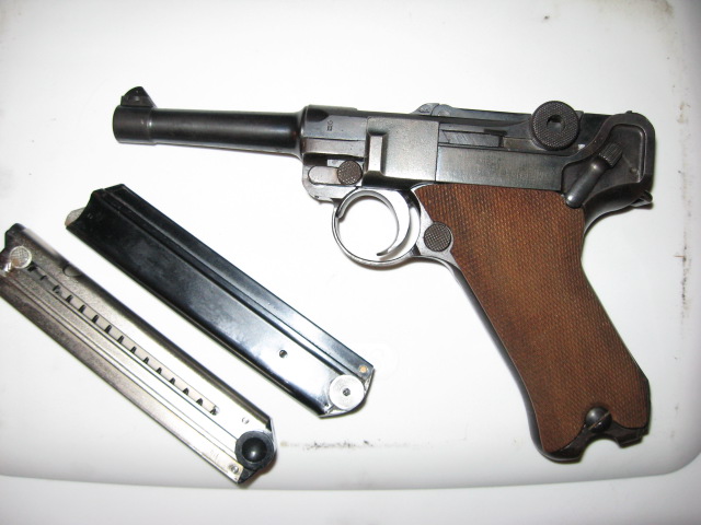

Here are some pics of the Luger that I had questions about at the beginning of this thread. I think it's a 1920s commercial but I am open to feedback if you have other information. One of the mags is marked Erma, made in Germany (aftermarket repro?) The other has no markings except for the number 5 on the bottom. The bottom is aluminum.
Thanks for the help. Like I said, I am getting ready to sell this so you info helps to prospective buyer and helps me establish an asking price. My best estimate is around $1000. Please correct me on this also if I am off.

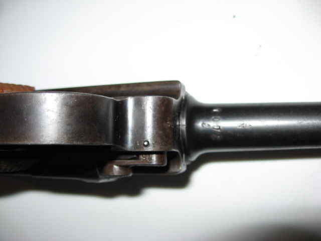

Not sure how to post multiple pics.

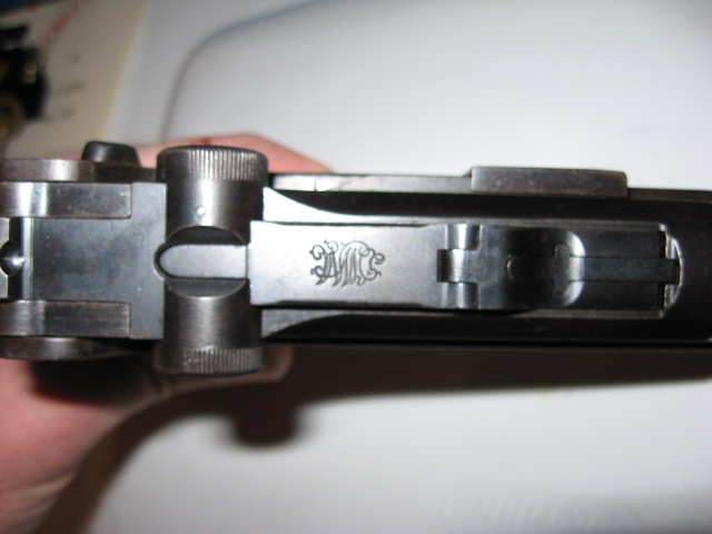

Your luger is more recently known as an DWM Alphabet Commercial (formerly 1920 commercial). The suffix is a lower case "L". The correct mag would have a wood bottom, either blank or stamped GERMANY. The thumb safety looks like it is blued in the photos, it should be strawed.
Mike C.
