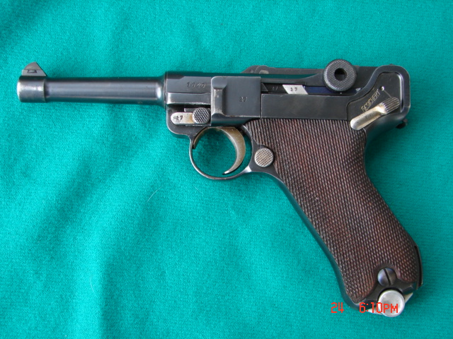

It looks exactly like this one except for the strawing. Only strawing is the horizontal bar above the right grip.

With no strawed parts it sounds like an East German gun. Perhaps the story about it being "new in box" has some merit.

In the photo furnished in the link provided by GB49, the take-down lever, trigger, mag release and safety lever appear strawed to me.
Somtimes the tops and bottoms of guns got mixed under emergency conditions. Picture a group of soldiers sitting around cleaning their Lugers. The siren goes off and everybody grabs a top half and puts it on their bottom half - some pistols get mixed up. I have seen several pistols like this and they all seem to function just fine.
