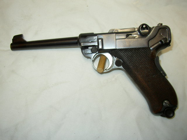

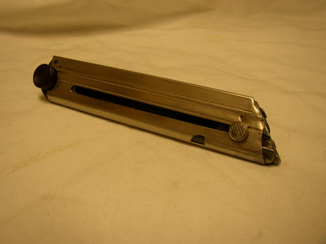

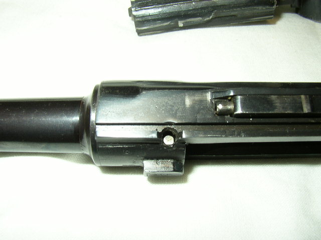

I picked this up in an Idaho pawn shop many years ago. A 1900 AE serial #10317. It has been converted to a 22 rim fire. The barrel was cut off forward of the serial number and a 22 barrel pinned into the receiver. The recoil spring was changed to a coil type. The original firing pin was converted to a rim fire. The rear toggle was cut down to reduce weight. An adjustable rear sight was added. The mag is an original wood bottom lined with a 22 mag (Erma?). All the numbers match. It must have been a fairly nice 1900 AE. Interesting piece anyway. Good gunsmithing and functions very well with hi-velocity 22's.

What an intriguing conversion!
Very creative work by the gunsmith, for sure.
I like it, and I bet it works a lot better than those post war Erma 22s.
Thanks for sharing it.

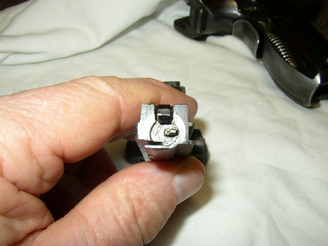

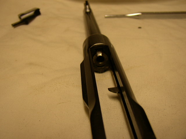

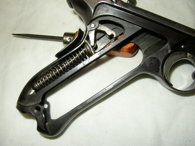

John The ejector has had the arm ? extended. Bill;
Unread 01-19-2008, 12:45 AM   #8
Ejector or extractor?
Unread 01-19-2008, 01:04 AM   #9
Posts: 2,674
Thanks: 3,245

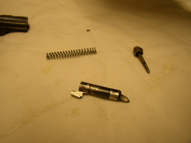

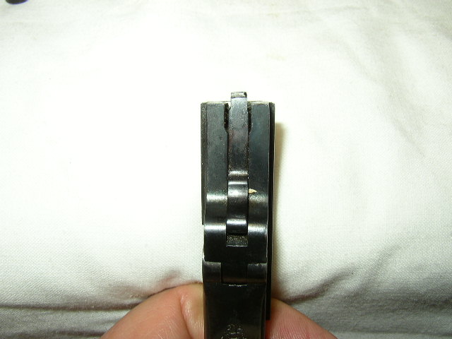

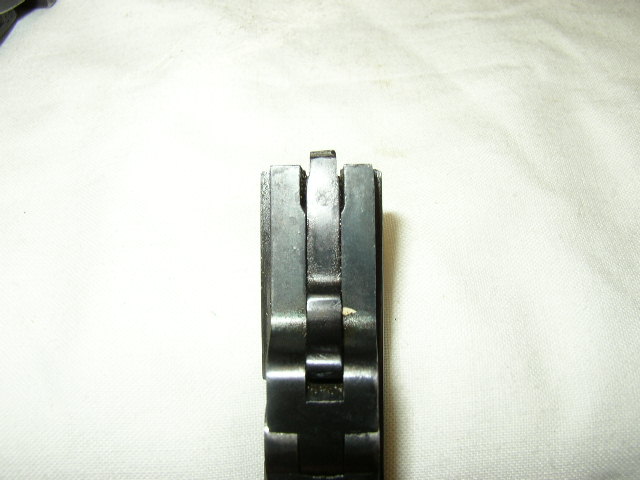

Ron & John- The ejector arm(?) has been lengthened and a deeper groove cut in the breech block. See pictures. Included is a picture of the barrel pin. The extractor has been reworked - lowered to pick up a 22 case?
Unread 01-19-2008, 02:05 AM   #10
That really is a marvelous piece of work! I thought it would be a straight blow-back action like the .22 kits, but I see that it appears to be a short recoil and the frame ramps have been built up to break the toggle quicker. The more I look at these pictures the more I admire the skill of the craftsman that made it. The breechblock is a work of art. Now that I have looked a little closer, I can see that the extractor channel has been made deeper so that the extractor can reach down and capture the .22 rim. I would like a pic of the top of the breechblock and a shot or two of the back of the toggle and the rear sight setup. That is one neat little puppy!

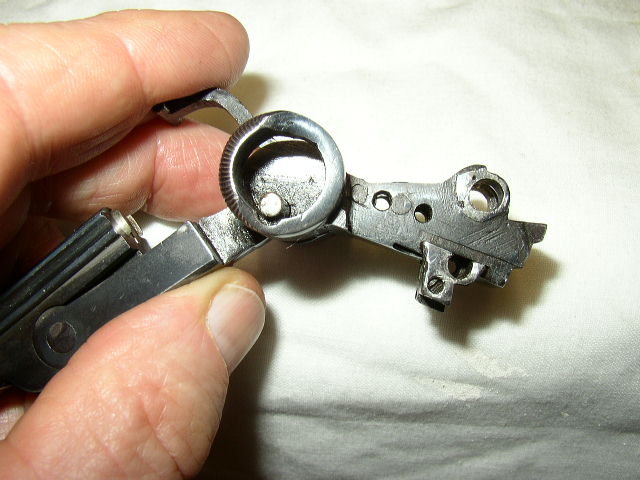

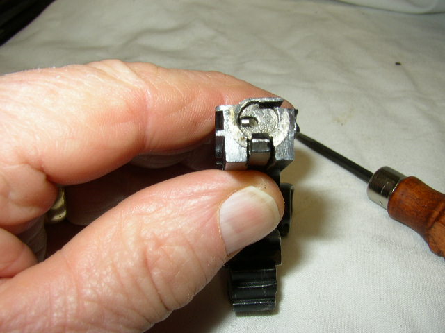

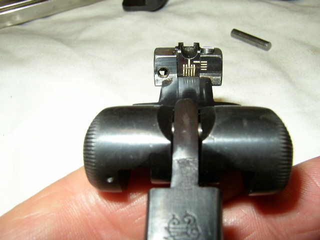

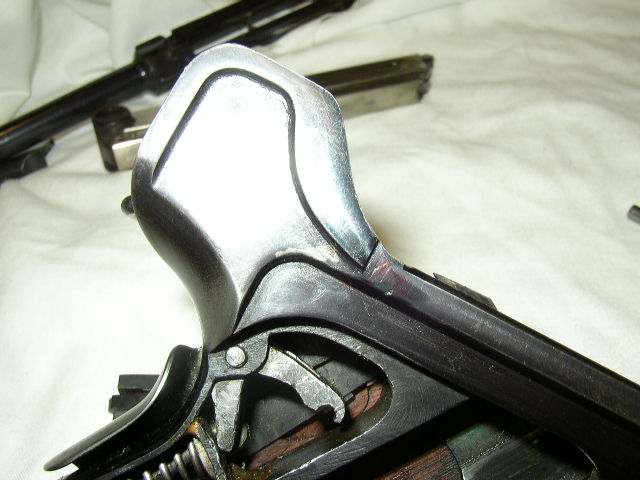

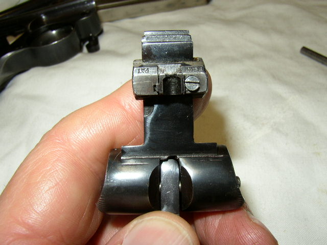

Ron - Here are a few more pictures. The rear sight is dovetailed in and is adjustable for windage and elevation. I edited the post above your last one and included some pictures. I think we must have put them on together. The rear toggle was drilled through four times, a couple of them filled again. If you need any others or better shots, just ask. When I bought this ($160), I tried to find out who had done the work. They could only tell me an older man who worked on guns for a hobby.

Thanks a ton Bill! You really got your $160 worth! From the top view of the breechblock I can see that the old gentleman replaced the 1900 one piece extractor with an adaptation of the new model pivoted extractor with a separate small spring. The gun is a fantastic modification and a delight to see. I really appreciate the photos.

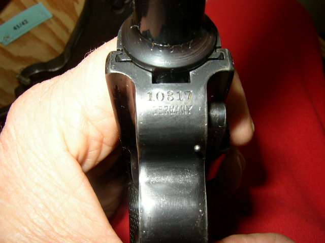

does the rear of the barrel extension have the rear toggle axle relocated lower than original ?
appears overall this now operates as a blowback - will the breechblock and toggle open up before the rear toggle ears touch the frame ramps ?

The rear toggle connecting pin has been worked on. I have nothing to compare the location to. The pin is smaller than the rest of my lugers but I do not have another 1900. The breech block and toggle do not open before the rear toggle touches the frame ramps. Hope I have answered your question. Maybe John S and/or Ron W will jump in here. Thanks for your interest. Bill
Unread 01-23-2008, 02:48 PM   #18
Looking at the photo of the rear of the receiver, it does not appear that the rear toggle axle pin has been lowered. The connecting link however has been extensively modified. The pivot point on the toggle for the link has been moved far forward to right behind the toggle knobs and the link itself has been made longer. The pivot point between the rear and forward toggle links has also been raised. The gunsmith has completely changed the geometry of the toggle train to accommodate the .22 round. Again, I am impressed with the ingenuity of his modifications.
