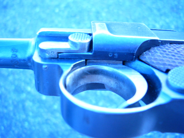

The "03" on the small parts are the last two digits of your serial number.

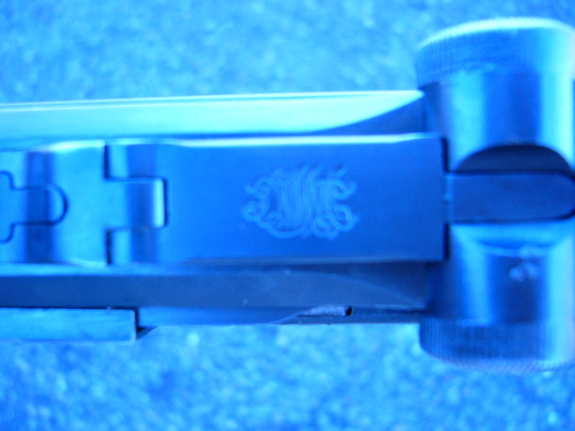

The toggle is not marked on the top of the gun? I would expect DWM in a scroll pattern, but that also may be taken off or blank.

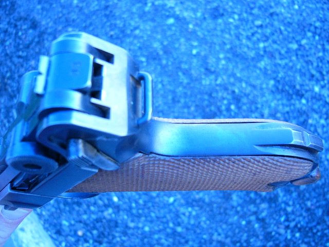

Unread 01-02-2008, 01:07 PM   #6
meddle
Join Date: Jan 2008
Posts: 6
Pics
meddle is offline   Reply With Quote

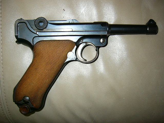

Unread 01-02-2008, 01:11 PM   #7
meddle
Join Date: Jan 2008
Posts: 6
More pics
Is this how you prefer to view pics or is there a way to put them in the posting?

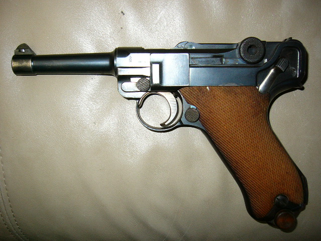

Unread 01-02-2008, 01:15 PM   #8
meddle
Join Date: Jan 2008
Posts: 6
Unread 01-02-2008, 02:05 PM   #9
Thanks: 2,079
I changed the URL to say IMG and that makes the photos show.
Yes, this is a commericial luger, made in the 1920's for export to the USA by DWM.

Unread 01-02-2008, 11:52 PM   #11
MFC
MFC's Avatar
Location: Louisiana
Posts: 1,237
Thanks: 183
Michael,
Your Luger is a DWM Alphabet, (also known as 1920 commecial). It was made in 1923 according to the serial #. It was made for the commecial market but without the GERMANY stamp it was not for the American market. Yours might be a vet bring back since most of the commecial Lugers in the US have the GERMANY stamp, which is to comply with US import laws.
Mike C.
