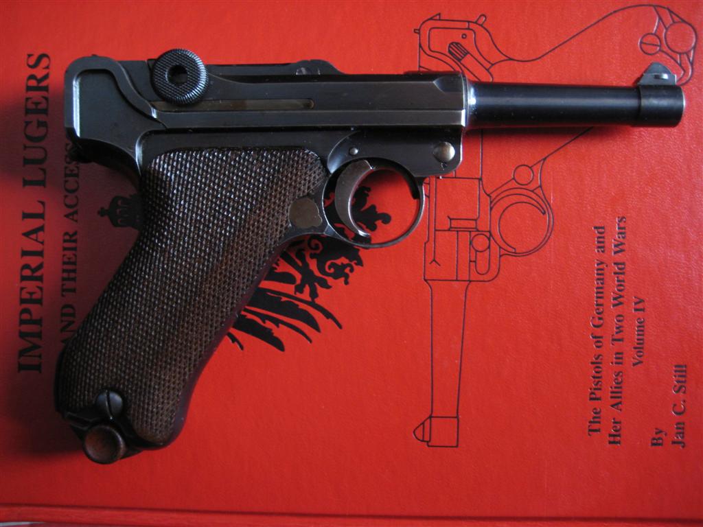

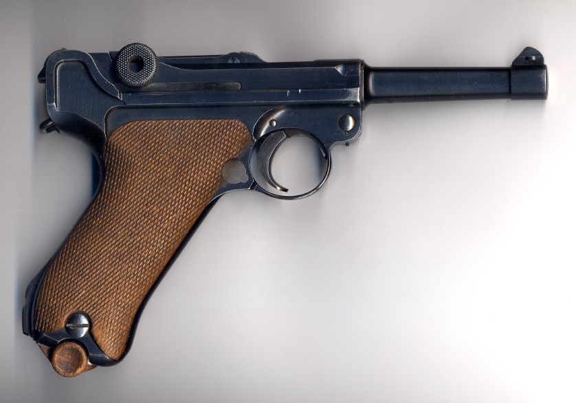

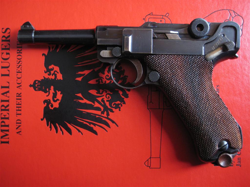

This is a 7.65mm DWM commercial(DWM inscribed on the rear toggle link), s.n. 5847 lower case 'o'. The word Germany is stamped between the number and the lower case 'o', on the front of the frame. The gun looks to be in like new condition, with a little holster wear on the high spots. It has the crown N proof on the left side of the receiver, on the underside of the barrel and on the side of the front toggle link(lazy N). The barrel has the Crown N and the serial no. with the lower case 'o' on the underside. It has a 3 7/8" barrel. There is no date on the chamber and no other marks on the piece and I don't believe it has the modified safety. I believe that all of the parts that are normally numbered for the commercial model are numbered and they match.
The magazine is the tinned version with a wooden bottom piece with Germany stamped on the bottom of the wood. There are no other marks on the magazine.
The bore is sharp and clean and the overall finish on the piece is 90 to 95%. The bolt face is clean and from the overall looks of the mechanism, it seems to have not been fired much, if any. The inside portion of the frame is still in the white, it doesn't appear to have ever been blued.
I have included a couple of images of the gun.
I would appreciate any info, that you guys would care to share with me on when it was made and any other pertinent information. Also, would the grips necessarily be numbered. They are not numbered but fit so well, that I find it hard to believe that they are replacements. Would the word Germany stamped on the gun indicate it was to be exported to Britain or to the U.S.?
Thanks, robarr.

robarr,
Your Alphabet DWM commercial was made late 1925- early 1926. Everything is correct as you described, including the GERMANY stamped mag. bottom and the grips which were not numbered.

Barrel lengths can vary from 3 15/16 to 3 5/8. I like the longer models.
Although the ammo is expensive, these are very sweet to shoot.
Yours would have been produced around 1925 in the heyday of the Weimar Republic and it is a genuine DWM product. The Germany stamping indicate that it was produced for export to an English speaking country. The lack of British proofs strongly suggests it was originally for export to the US. There are a number of variations that make these pistols interesting. DWM progressed from using up surplus WWI parts to completely fabricating new parts for the commercials. Times were tough in Germany and it is likely that only the best of the gunsmiths remained in DWM employ at this time.
Pull the reciever out of the frame and see if you have a full or partial serial number stamped on the barrel lug. I would also be interested in if your barrel has a Crown N proof.

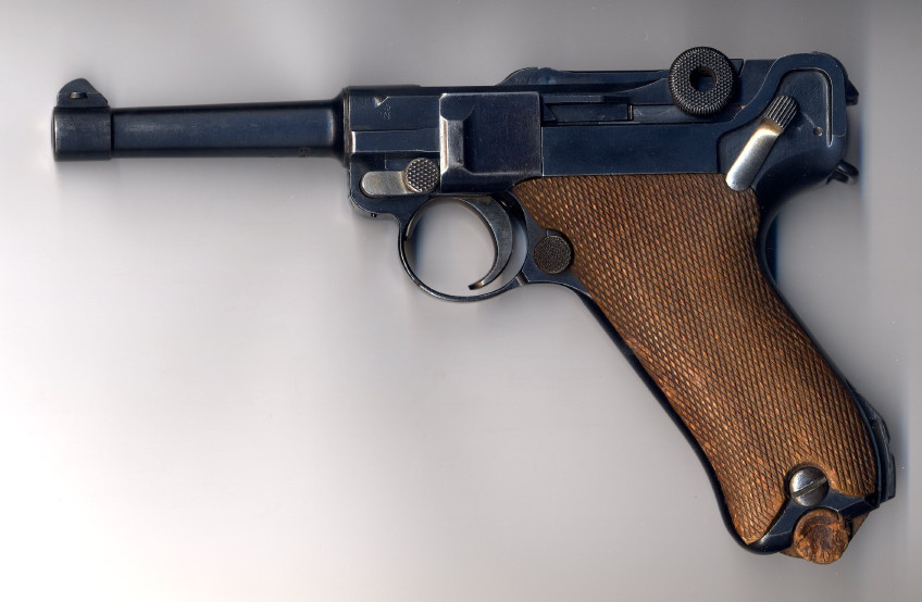

For all commercial Weimar Alphabets that I've seen so far, the one in best original condition is still mine. Feel it's a little selfish just looking at other people's guns without posting one.... so here it is, 1323n (a little dark, ordered a light box, not arrived yet):
Enjoy

With the receiver removed, I cannot see any numbers on the receiver lug, which I presume is what you refer to as the 'barrel lug'.
The full serial no. is stamped on the bottom of the barrel and just forward of the number there is the C/N. The serial no. on the barrel has a 'halo' which I assume indicates that the number was applied after the barrel was blued.
Hope this helps, although I am slightly late in replying.
