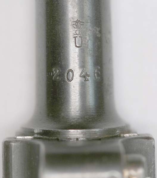

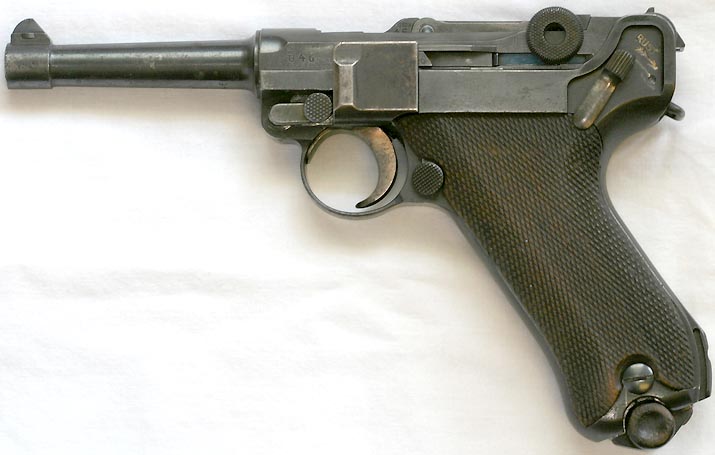

Hi first post on the board. Looking for help identifying the luger. There is no chamber date.
Here are photos:
Let me know if any other specific views would help.

Michael,

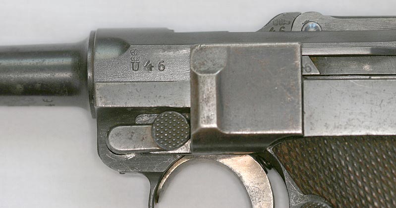

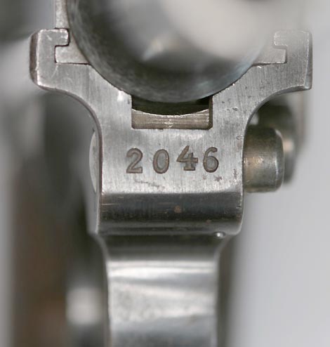

A very nice Dutch Luger, and a very rare example. It would be useful to know the full serial number (with suffix), and to see the number on the front of the frame. It would also be useful to see the barrel band where the front sight is mounted.

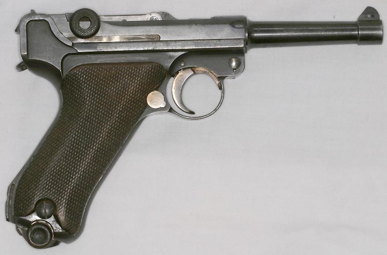

We are all curious to see the full view of the right side of the gun, and curious to know the markings on the magazine bottom.
It is noteworthy that the barrel has no witness mark, and that it appears to have Mauser-style grips.
I have taken the liberty to lighten up your photos so everyone can see it clearly.

full serial number: 2046
I see no suffix.
photo of other side sometime tomorrow morning...

nevermind about tomorrow had photo already...

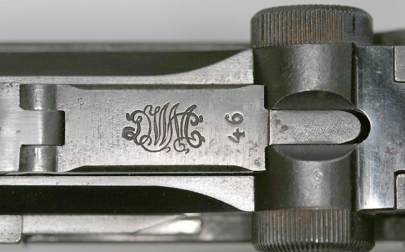

Hi,
The Dutch Navy accepted the P08-style lugers as 'Pistool Automatisch nr. 1', not to be confused with the KNIL version, which had a grip safety.
K.M. stands for "Koninklijke Marine" or Royal (Dutch) Navy.
A pretty rare find. Congratulations on owning an exquisit Dutch luger.
The first Dutch Navies were ordered, assembled and proofed at DWM in Berlin. After the move of machinery and production to Oberndorf in 1930 , Mauser initially continued assembling guns from DWM parts, the guns were proofed in Oberndorf, hence the crown/U proof and the DWM toggle marking.
The gun shown was part of a batch delivered to the Dutch navy in March, 1932.
ps. 'Rust' is Dutch for 'rest' or 'at ease', roughly translates to 'safe' (but not entirely).
Unread 08-12-2007, 12:04 AM   #7
"The Dutch Luger" book on page 145 indicates a total of 1,170 of this variety...with SN's running from # 1485 to # 2554 (inclusive) running from 1930 through 1939. Somewhere around 1937, the old DWM toggle changed to the Mauser Banner toggle with chamber dates, etc.

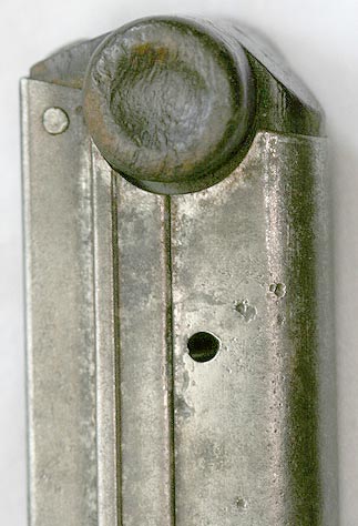

Would it be possible to see a photo of the bottom-view of the wooden magazine ?

Best I could do of the magazine bottom... Perhaps a better photo tomorrow when the sun is out.

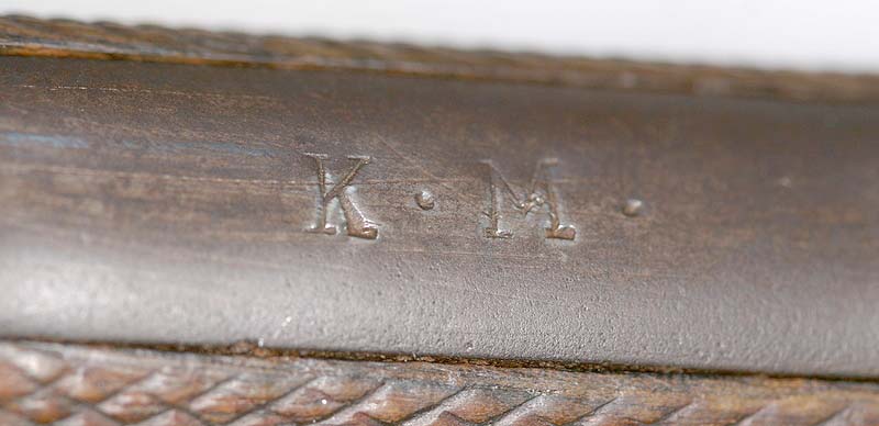

If I am not mistaken, the last Luger like this with KM on the grip strap at Simpsons LTD had an asking of over $ 8K...
Here is another one similar to Michael's gun...but a bit later in the series after the Mauser Banner appeared...still KM marked. Asking of nearly $ 9K.
http://www.collectorsfirearms.com/ad...hp?itemID=4218
The authors of "The Dutch Luger" on page 167 (written in 1994) state "...as less than a dozen Navy Lugers with "KM" marks are known...".
I think the KM makes them quite rare and desirable.
Michael,
Thanks for the magazine bottom photo. Quite an unusual repair/modification witht the little metal "staple" in the wood. I have not seen that before...maybe others have...???
Here is a photo of an early Dutch Luger magazine with its unique metal tab retainer. I thought yours may have had this, initially.

I doubt that the Dutch Navy lugers had the magazines with the spring catch. Initially they would be normal unnumbered nickle-plated magazines with ordinary wood bottoms, later replaced by blued tube magazines with wood bottoms, eventually replaced by the Haenel-type.

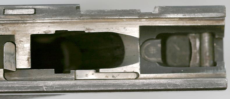

Michael,
The left side of the extractor (when it is rasied up a bit with a round in the chamber but can also be lifted with your finger) should be stamped "Geladen". Is the right side of your extractor marked in any way ?

Both sides are marked as shown below

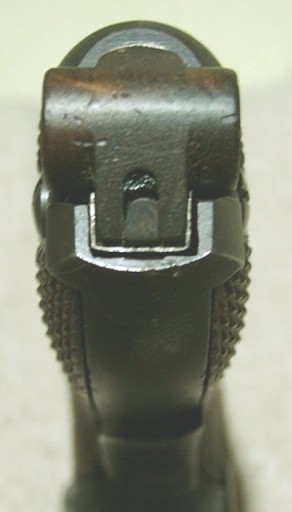

Inside view of grips
Thanks again everyone.

Thanks, Michael...extractor markings on both sides is as it should be.
