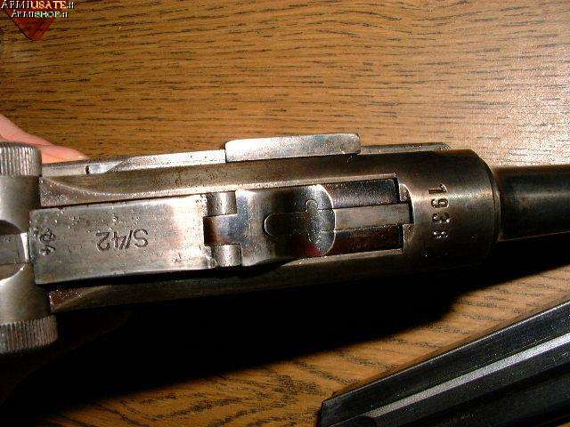

Attached are photos of top of my second P08.
As a novice to the Luger world I believe I am still entitled to ask silly and obvious questions to you Top Luger ewperts!!!.
Can anybody explain whar S/42 means . Is this an original Military Luger or can it be a commercial one?
Any further comment on this gun will be welcomed.
As to the SS (partly blotted out) insignia, these are being discussed in a aeparate Thread I started yesterday.
Thanks to yo all from a green recruit!!
Ciao!
Marco

Hi Marco, welcome to the Luger Forum! The S/42 is an Ordnance Code used by the Germans to indicate the manufacturer as Mauser. This code was used up to the early 1939 production, then the Mauser code was changed to just "42", then in early 1941 it was changed again to "byf".
Even later, in 1945 it was changed yet again to "svw". Since Mauser stopped Luger production in 1942, the "svw" code is found on their other firearms.

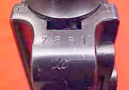

Hi Marco, it would be helpful to see the serial number information, like:

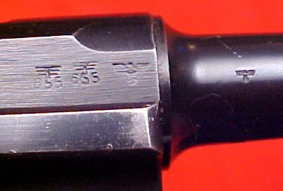

and also the inspection/proof mark information, like
Your pictures show the pistol may have been refinished, but it's difficult to tell for sure. There is some pitting, but if you are using this pistol as a "shooter" that's okay, as a collection piece, that's a detriment.

I agree about all you said: the pitting is for sure a detriment and it is exactly like what you can see in the photos.
As to the ammo change , yes I know IT IS DEFINITELY A DETRIMENT, but here in Italy we have no choice, 9 para being forbidden.
In fact it is only allowed for Military and Law Enforcement bodies.
All 9 para originally in the country (or before import) prior to selling MUST BY LAW be either barrel sleeved to 7.65 Para or chamber deepened to accept 9x21 rounds! - No exceptions .
Next week I am probably going to sell this Luger anyway. Apparently I will be able to fetch a good price from a German WWII enthusiast ,because of the "puffed"SS insignia on the grips.
