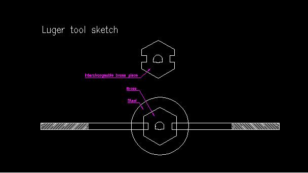

With todays machinery, it would not be that difficult to make a tool like that. I think the question is, what materials are used? You do not want to scratch or make a dent in the receiver, at the same it must be solid enough to withstand the torque needed to remove/install the barrel.
I'm thinking something like this instead;
..but I'm no gunsmith.. perhaps finding one will be the best solution when it comes to this type of work

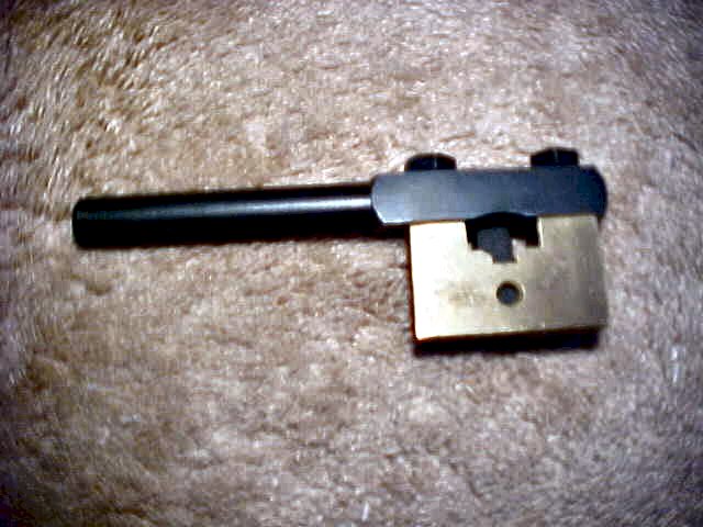

Simply cutting the tool in half and introducing two bolts that will allow the top of the tool to clamp to the bottom of the tool will solve some problems.
Here's a picture of one.

makes sence.. I like that tool.
You could have a thin layer of brass on top of the receiver, shaped in the right curve. Is it custom made Gerben?
Unread 07-02-2007, 09:40 AM   #5
Hi Steinar,
I don't own the tool, it's in my 'luger tools' folder, named as a 'Mauser tool'.
Unread 07-02-2007, 09:42 AM   #6
Steiner, This appears to be one of the barrel wrenches that a machinish made for me in California over 20 years ago. I still have one, but sold a few others. TH
