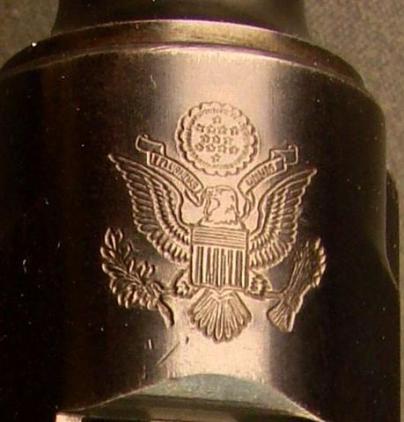

Here is a great photo of a nice AE chamber stamping. Really nice detail in the feathers of the eagle's tail...
A cautionary tale...many sellers will offer up the term "lightly struck" to excuse an AE stamping that may have gone through a rework...
When I hear "lightly struck" at gun shows...I always hear "heavily sanded" running through my mind...

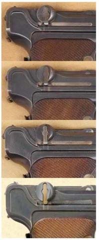

I was wondering why only the Eagles have the two parrel lines below the round doughnut. It dawned on me anothr almost foolproof test for reblueing, NO MARK, NO SALE!!! Do they appear on all Eagles. I forgot why it only appeared on the Eagles, or did it, Id welcome any observations, and we are only scatching the 'Luger Layer's surfice. ps, I thougt Peter had compiled a collection of Eagles somewhere.
Unread 06-24-2007, 08:41 PM   #10
Thanks: 1,119
The two parallel lines are found on all 1900 and 1902 model Lugers because they employ a toggle lock. It is where the latch for the toggle lock is fitted into the frame. You are on the right track that if the "lines" are missing it is a clue that the piece probably has been refinished. A word of caution however, I have seen original, non-refinished Lugers where these lines are barely visible and/or may not show any light color. Also, boosters can easily fake these lines by polishing away the blue with a thin instrument. This can detected under magnification, so you really need to examine a "mint" gun with a jewelers loop with at least 10X magnification. Here are a few of the examples posted by Pete Ebbink and notice in particular the top example where the right line is barely visible.
