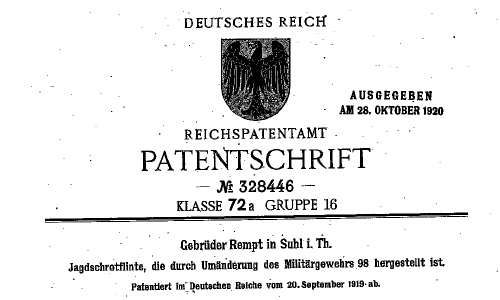

Hi Steinar,
Some additional info from my old catalogs:
Remo was the factory mark for Gebr. Rempt Jagdwaffenfabrik in Suhl, established 1865. They made all sorts of hunting rifles including a .22lr version, a 3-5 shot version for different types of rimless cartridges and a 2-shot size 12, 16 or 20 version, amongst others. The company was alive and well in 1937 and it also seems to have survived the war, being mentioned in a 1952 catalog. Although the author of the article above has doubts about size 20 shotguns, the catalogs mention they were available.

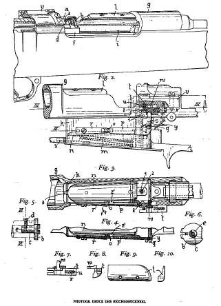

The conversion of the K98 to a shotgun was patented by the Rempt company in Germany in 1919. It was patented under #328446.

thanks, interesting diagram! Looks almost advanced from the drawing.. but the conversion looks a bit simple and 'rough' on the shotgun I have. But I guess they filled out a need of the time, as hunting shotguns and keeping the wheapon 'industry' rolling

I wonder if the D.R.P.A. marking refers to a Deutches Reich Patent Document.
Reading from the copy of the patent document provided earlier in this thread,, does Deutches ReichPatentAmt make any sense vis-a-vis these initials on the shotgun?

You are right: D.R.P.A. stands for Deutsches ReichsPatentAmt.
D.R.G.M stands for Deutsches Reich Gebrauchsmuster.
The difference is that the DRPA is a registered patent and must have certain unique qualities to be able to be registered as such.
The DRGM is a protected design and it does not have to have unique qualities or have to be original. It's more a protection of the general look and feel of an object.
