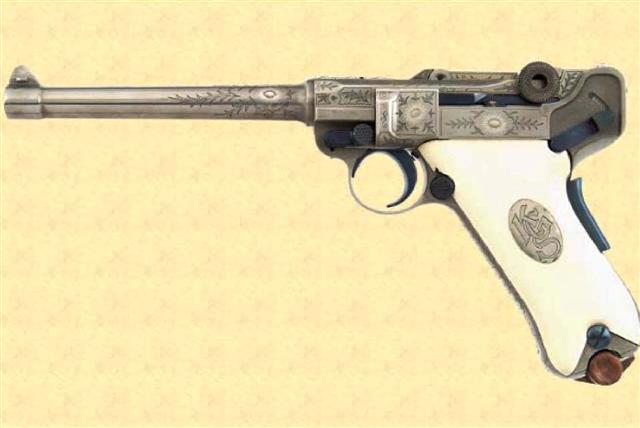

Mauro,
Dad just got 4 fancy Interarms Lugers with engraving, Gold inlay, ivory grips, etc. They were made for the IWA Show in 1990.
Do you know anything about these?
bradsimpson is offline   Reply With Quote
Unread 06-12-2007, 08:07 PM   #13
Hi Brad,
Do they look anything like these ?
This pair was for sale on one of the gun auction sites about 3 years ago. IIRC...Tom Armstrong went after them...but I am not sure if the deal went through or not...

@Brad,
There is some Mauser flyer information that shows these variations. Mauser tried to do something special for the annual IWA shows, but the prices were accordingly...
A 1990s flyer mentions the IWA 90 version as article number 732116
In 1998 the factory price for that version was around 12,000 DMark.
The pistol was described as follows:
Matte grey finish with silver thistle leaves as barrel engraving, Blossom inlay in platinum, strawed small parts, Ivory grips with silver monogram plate inlay, with leather case.
