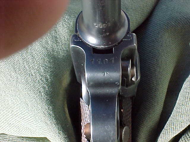

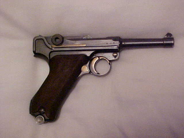

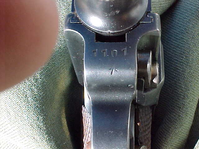

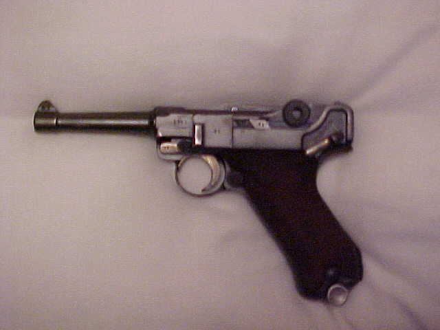

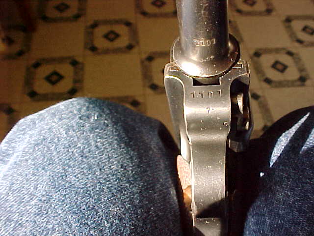

im new to lugers, i bought my 1st one last weekend at a gun show. it,s got 1936 and S/42 on top all # match except the mag. it look,s to be 95% org. finish. the strawed parts look about 90%. ser.# 1101 but under the 1101 it looks like it might have been a j.[ german j] that is as close as it looks? maybe holster wear? im sorry i dont know how to post a pi,c. i would aper. any comments. thanks

Pictures added for Louis;
I think the suffix is a "r", other opinions?

MFC
MFC's Avatar
Location: Louisiana
Posts: 1,237
Thanks: 183
It's a lower case (p). I have a luger with a (p) suffix and had the same problem identifying it, and of course the members here helped straighten me out. I'm glad I was able to help you. What comes around goes around.

the more i stare at it, it does look a lot like a lower case [p] with the top missing. you think maybe just a bad stamp? it does not look like it was worn off as the org. blueing is still there, it was stamped on a rounded part of the gun. i went to research military lugers and put in [p] and search, and it came back p= ruhstahl brackwede. what ever that means? thanks for everyones help. this is great. LB

Hi again lboos,
Your stamp does look like it's not deep on the top, but the picture you have of it between your knees looks better. The thing that confused me the most was that the loop of the (p) was not closed. Which is why I think we were both confused. I said the exact thing. I thought it could be an (r) also.

Looks like a really nice S/42 Louis! the straw looks really nice.. Love those strawed Mausers! Congrats on a great gun!
