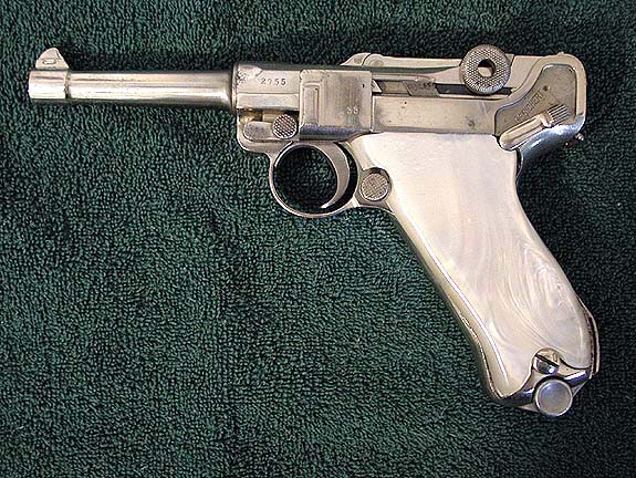

Item desc.:
An interesting Luger. Originally 7.65 mm, converted to 9 mm. Brought back from Germany by a soldier who had it professionally plated in gold and I think nickel. It's very nicely done, in the manner of a presentation piece. Not a shoddy plating job on a beater gun. (NOTE: Gold plating is not on main body of the gun but just some of the smaller parts. Trigger, extractor, etc...)
Gun is marked "288" and all the numbered parts, except the magazine, are marked "88". See the photo of the front of the grip frame, which is marked "SP. Bn. 2021" with "335" crossed out. I don't know what that means, but if someone has an idea, I'd be interested to know. Unfortunately, the soldier who gave it to the current owner didn't tell him much about the gun.
The wood grips are sharp. I don't know enough about Lugers to know if they're original.
The crown "N" proof remains clear on the left side, just aft of the barrel. Magazine has an eagle proof.
Very clean inside and out. Remains in excellent condition after being reworked, and would be quite suitable for display. It is part of a 40+ year collection of fine quality guns that I am selling on consignment.
More I found out in email communications:
Gun has been test fired one time and works great. Bore is OK, item is not so perfect as one wouldn't want to fire it but still looks like a good display item.
Appreciate any input on this.
EDIT: Was also wondering if this would shoot standard 9mm bullets? Or do you need military issue to have it cycle correctly?

I emailed you thru GunBroker but will repeat my identification here for the benefit of others.
The grip strap marking is from the Schutzpolizei of the Free Hanseatic City of Bremen. The pistol was originally issued in 7.65 mm and marked SP.Bn.335. The police armorer probably also stamped 7,65 on the chamber to prevent confusion with other 9-mm Lugers in inventory. At some point, the pistol was re-barreled in 9 mm and the chamber mark was crossed out. The pistol probably was re-numbered at that time.
The pistol very likely has an "m" suffix beneath the serial number on the front of the frame indicating it was manufactured by DWM in 1924.
I recently issued an article on the police markings of Bremen and will be happy to email a copy to anyone who wants it. It is a .pdf file and you will need Acrobat Reader to open it.
I will let others address its value.
Don

Tragic. Whoever refinished this Luger took a valuable and interesting gun and reduced it to little more than a curiosity. In my opinion if you were to pay more than about $450-$500 for this you would be paying too much.

The magazine is probably worth $ 100 or so.
The small parts with the "glossy" finish can easily be restrawed. That would make this shooter look a little more authentic. The grip screws s hould go back to blue, also.
Maybe $ 700 or 750 here in CA for this piece. In a retail shop, it woudl probably be priced at $ 850.

I have the same gun SN# 6107m, the weapon # cross out is 609 and new stamp weapon # 1494....it is a real shame what this gun has gone through, still should bring a $750 + price

As real estate people would say in thier advertisements, location, location location. (although RE people never seem to put the location in the advertisment). Maybe in California prices are higher. I don't know. But I have to lean towards Dwight on this gun. The restoration work was shoody at best. Badly buffed and restored. To do restrawing would cost more in time and money than its worth. The gun just looks terrible. The magazine MAY have had its bottom sanded to remove the original numbers and new numbers applied. Looks like the seller wanted to put something in the gun and dug deep into his spare magazine box to find the worst that he had just to get rid of it. Unless you are just looking for something to go bang bang with, I wouldn't waste my money on it. You'll have a devil of a time trying to sell it later at any price. There are better shooters out there for $600.

Comments in this discussion about restoring/refinishing--am I the only one who has picked up on the fact that the gun has been nickel-plated? That is the main reason for my evaluation--if it was blued It would be worth a bit more (but only a bit) in my estimation...

I have this 1917 DWM with all matching numbers except mag that I will sell for $650 shipped. It doesn't have the white grips on it now, but has the original wood ones numbered to the gun. I will supply them or grips similar to the ones pictured. It has an excellent bore and shoots good. Will have an original mag that works.
It is not as flashy as the above gun, but doesn't look like it was even buffed before being plated. It does however have some dark peppery spots in the nickel. I can supply more detailed photos to anyone interested.
