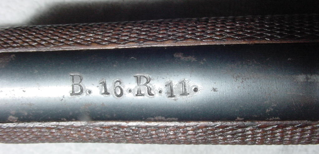

As to value how about this one ? B. 16. R. 11.
http://forum.lugerforum.com/lfupload...001_copy11.jpg
OLDJARHEAD is offline   Reply With Quote
Unread 02-28-2008, 08:49 PM   #12
Jar Head, if your 16th Bavraian had a cursive R rather than a Roman R it would be worth a hell of a premium.

Unit or property marks can add considerable value. A common property mark on an Imperial Navy, like say W.W. or T.D., would add about 10% to it's value, rare and desirable marks like U.A. (Untersee Abteilung) or Gouv. Kiau., about 100%. And if, as George Anderson pointed out, the R on Jar Head's B.16.R. marked P08 was cursive, he could just about name his own price.
Regards, Norm
