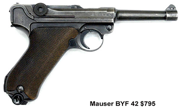

You both raise interesting points... I like the idea about the better metalurgy and the "less use" for the newer gun. Here's a photo of the BYF for you to see.
Here is the exact quote from the seller's description:
"Serial number stamped on the front of the frame is 392 which is also stamped on the left side of the slide. Last two digits 92, are stamped on the other parts throughout the gun. The barrel is 4" long and is mounted with a serrated blade front sight. The gun is mostly gray but with about 30% original blue finish, mostly in protected areas. Edges and corners are fairly sharp and the markings are excellent. Two piece checkered walnut grips show only light wear. The magazine included is not marked with a serial number but is marked "fxo" with a plastic plug which is correct for this gun. Action works perfectly. German proof marks are stamped on the right side of the slide and also on the right side of the barrel. Overall condition is very good plus."
Unfortunately, there is no left side photo....

It appears to be in good mechanical condition. I do not detect any pitting from the small picture above. Someone suggested that you try dry firing with snap-caps or other such non-live ammo. Good idea. Cycle the action as much as possible to look for any drag or unevenness in the operation.
I believe you stated you would go to see the gun on Saturday. Ask the dealer to allow you to disassemble the gun. I have seen Lugers that had a takedown lever problem such that a screwdriver (crude) was required to rotate the part. While the Luger is disassembled, look for damage or pitting.
Get a good picture of the left side. Side plates are often mismatched and/or pitted.

It's difficult to evaluate from the photo but it looks as if it's better than 30%. I would go with the byf for a shooter for the reasons stated by the other members, and the price is better. If there is no letter suffix on the gun it has a nice low serial number.

If possible, always try to get a photo of the other side of a luger and even of the front and rear grip straps.
