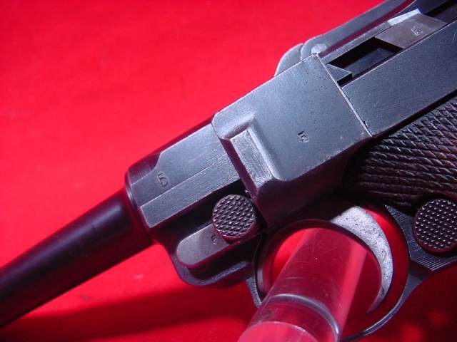

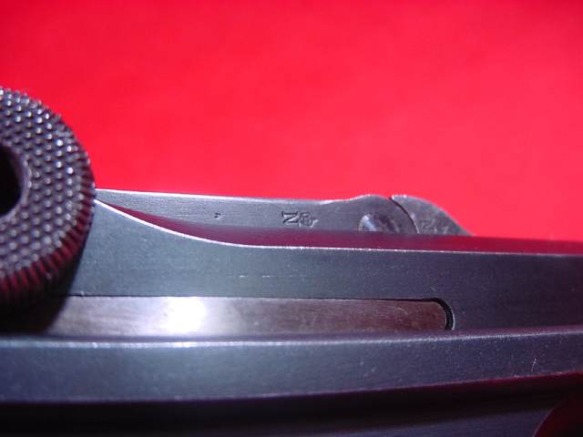

Has anyone ever seen a commercial "Lazy N" applied to the right side receiver and toggle links? Also serial numbered '5' in the military manner. Unknow whether suffixed or not. Undated with blank toggle. Any opinions, thoughts, etc.
Thanks, Ron

East German Nitro proof mark?

I suppose it's possible. I have never seen the Crown / N stamped on the right side. The horizontal or "Lazy C/N" was dropped circa 1918 and replaced with the upright C/N on standard commercials.

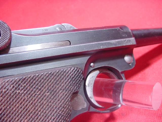

I have one marked with a Horizontal Crown N on the right side and military markings on the left, also at least one of my reference books states that it can appear on either side.
Do you have access to the gun for more pictures? Is that a crown N on the lower frame or the letter â??Zâ??
â??Zâ? was used as a reject mark during the finial shooting inspectionâ??so if that is what it is, it would add to what Voelker has stated. The â??Zâ? appears on my gun as well.
Vern

All C/N marks.
Thanks...

Pictures can really fool us sometimes, that sure looks like a "Z" to me below the C/N. Also look at the size of the proof, The "Z's" I am talking about are large stampings and that sure looks like one to me.
Your post however; so I trust you to know the gun.
Did you get a chance to look for a serial number suffix?
Vern

Ron,
When you originally asked me the question I was not aware that there was a c/N proof on the frame, below the one on the receiver. If that is indeed the case, it is more likely that this gun was proofed in Suhl, rather than Berlin.
Unread 11-10-2006, 10:53 PM   #14
Vern and Dwight ,
It just looks like a C/N or a Z. It's just a scratch.
