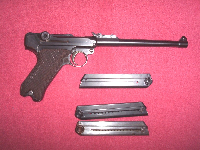

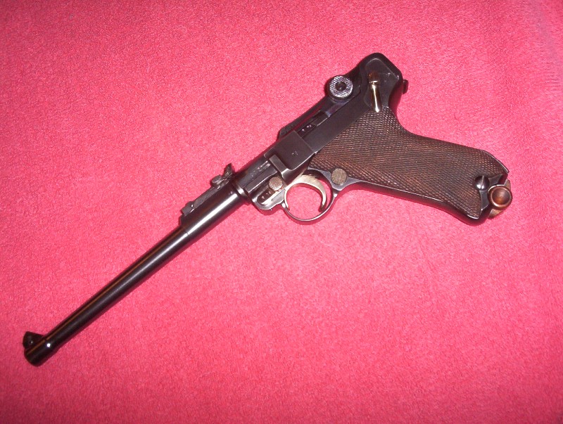

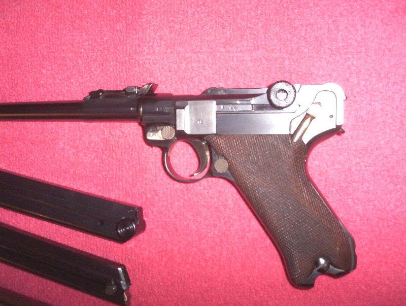

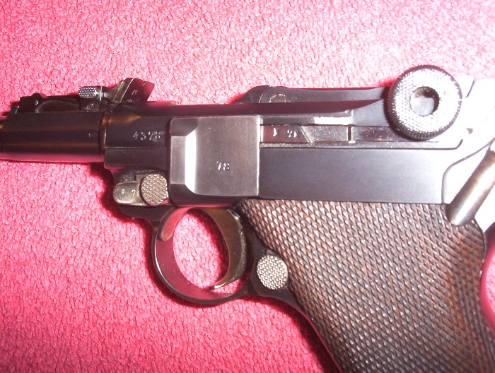

Ok heres the pics finally, sorry you had to wait, tell me what you think bad or good, a little dust on it here and there, also what is a dead give away that this gun is reblued and how can you tell its refinished? even if a guy is really good at reblueing? Thank you very much -mike

This gun has been refinished, but is in nice shape for a shooter class gun. The mags are new Mecgars and are worth about $30 each new...
The gun may be worth about $1300-1400... Would need closer photos of all serial numbers to determine if it has been force matched or is originally matching... that might raise the price a hundred or so...

how can you tell by looking at the numbers? and how can you tell when a gun has been reblued?

From the limited photos I can tell you that the side plate is not original to the pistol if the pistol is indeed an Erfurt. An Erfurt sideplate from 1914 would have a very obvious acceptance stamp on it near the serial number. Photos of the top showing the toggle train and sights might help in a further evaluation but keep in mind that nothing compares to a hands-on inspection.

George is absolutely correct about the proof mark on the side plate. The proof mark would be in front of the two digit serial number and the same size as the fourth proof proof mark on the right side of the receiver. I can see a serial number on the rear sight that, with some very close eye balling by me, looks like the proper two digit number. That suggests that the weapon has NOT been rebarreled. While there is a serial number on the rear sights slider and in the proper location, I could not make it out.
The Locking Bolt has been poorly restrawed and lotsa metal has been removed. The grips look nice. Look under them the see if you can find a two digit serial number and an Erfurt proof mark. Be careful though. It is easy to break off the little finger at the top right just under the safety. The wood is pretty old and dry. Remove the mags and, very gently, pop the grips off from the inside.
