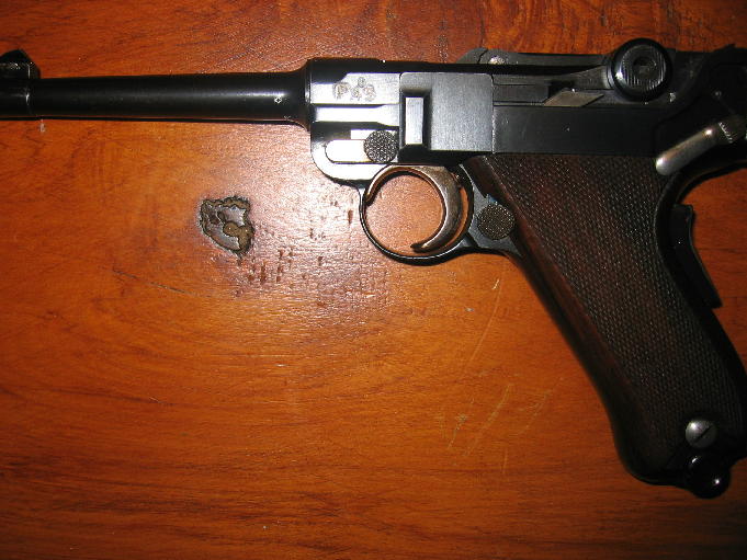

I need some help with a very nice Swiss 1906 Waffenfabrik Bern I purchased in an auction here in New Zealand a few days ago.
The gun is really in excellent condition with 95% blue and straw all over and a lovely barrel. The privatization date is 1945.
(I am sorry the photo is a little dark)

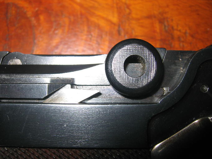

The gun has been fitted with a 1906/29 rear toggle section which is not numbered. The gun number is 21588 and is all matching numbers except the rear toggle section which however, does have an inspection stamp inside, E25 and a Swiss cross. The front of the toggle and breech are numbered 88 to the gun.
The gun also is fitted with a 1906/29 W+F magazine.

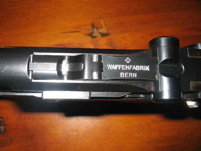

What is strange is that the rear toggle section is very similar to the 1906/29 W/F but it is not the same and has slight knurling on the outer sides while the "rims" if one can call them that are smooth like the later Swiss guns.
(see below)
There is some suggestion that it could be a transitional model but I do not think I could be that lucky. I think that it could be a rework.

Murry, Your rear toggle link appears to be a replacement using one made for the Mauser Parabellum, on the Swiss machinery post 1970. TH

If you look closely at the second photo, you might notice a small chip in the second part of the toggle link, where it joins the third section.
I think that the gun has has a "woop'sy" at some time and the original knurled toggle section has been broken and thus replaced.
I think the gun may have been refinished at that time as there is little to no wear marks on the cams and the area under the safety lever is blued.
All of the other parts of the gun are original and numbered accordingly.
I think I may have got me a lemon., still it is an interesting item all the same.

BTW...I have seen 3 or 4 Swiss M1929 Bern lugers with the "home-made" dicing lines added by an owner or local gun-smith. Some folks may have found the smooth toggle knobs of the m1929 a bit too smooth and slippery for their liking.

This '24 Bern has some M1929 toggle knobs...
http://www.gunrunnerauctions.com/lis...mnum=854991338
This M1929 has that odd "pattern" added to the normally smooth toggle knobs...
http://www.gunrunnerauctions.com/lis...mnum=854484496
Unread 02-08-2007, 11:06 AM   #8
Since the 1970s Mauser Parabellums were made on the previously Swiss owned M29 machinery, it does not seem unreasonable to me, that persons seeking repair parts after 1970, would get them from Mauser. If the parts are Swiss inspector marked inside, they were probably installed at the Bern arsenal. TH
